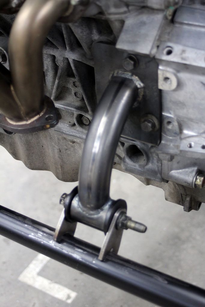

Started by getting the main bumper in. Here you can also see the system used to set the lower bar.
Lined the bar up perfectly in the factory tow hook location, will be putting a nut on there to use the stock system.

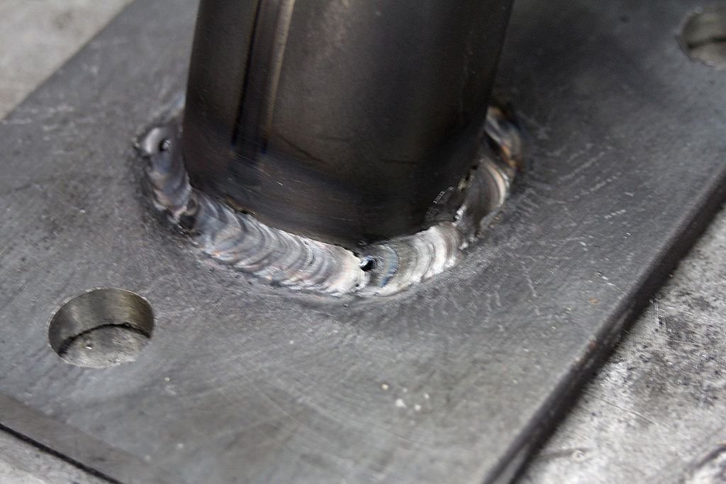

I wanted to get some mig practice on this project, it turned into grinder practice...
This is the tube that connects into the frame, should be good for the traction bar plans in the future.
All tacked together.
Added these dope hemispheres on the ends, accidentally got too excited and painted the assembly this morning.
Added a front motor mount too.
Had enough of that awful MIG stuff.
Currently waiting on radiator bushings to finish the front end, then on to tackle the wiring and throttle linkage, fuel pump, and some little odds and ends.
