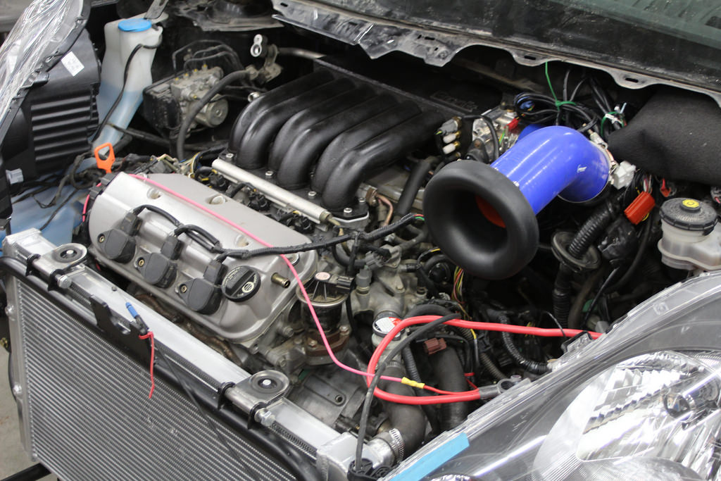

Dang, been sleeping on updates! But here is some of the stuff from the last few weeks.
Here is another bay shot

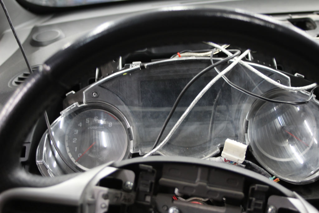

Here is the dash before the cover was put on, still haven't gotten tunerview to talk to AEM

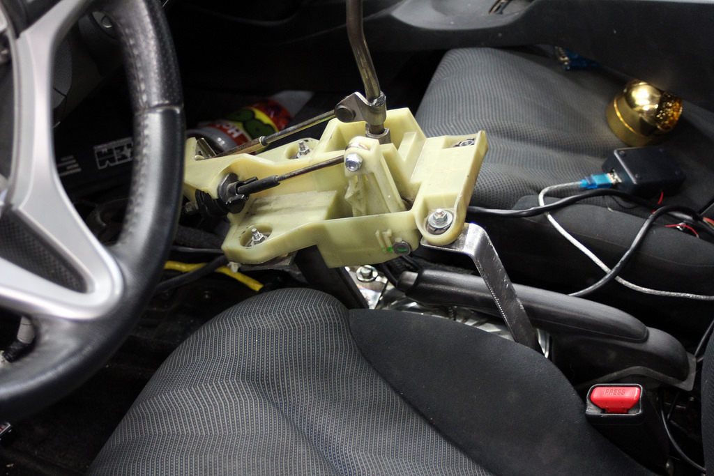

Temporary shifter solution, pretty funny, and really comfortable. Kind of want to keep the same knob position.

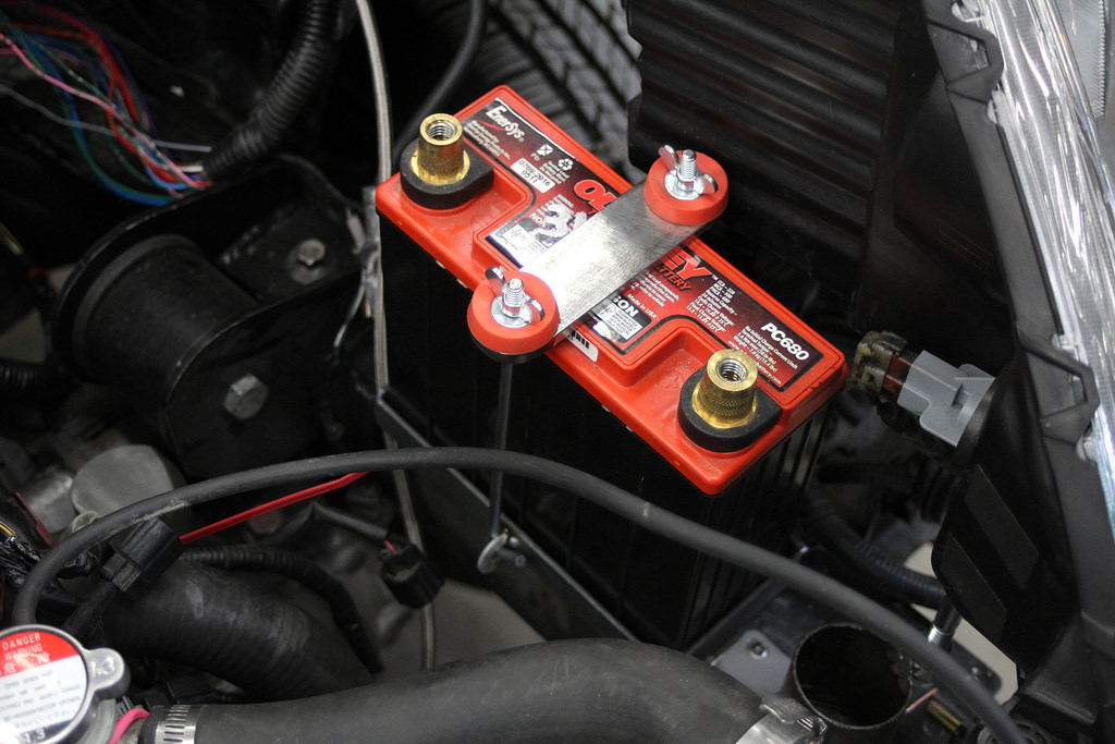

Another temp solution for holding the battery, the position is nice but the box is just tacked to the frame rail and looks pretty wonky.

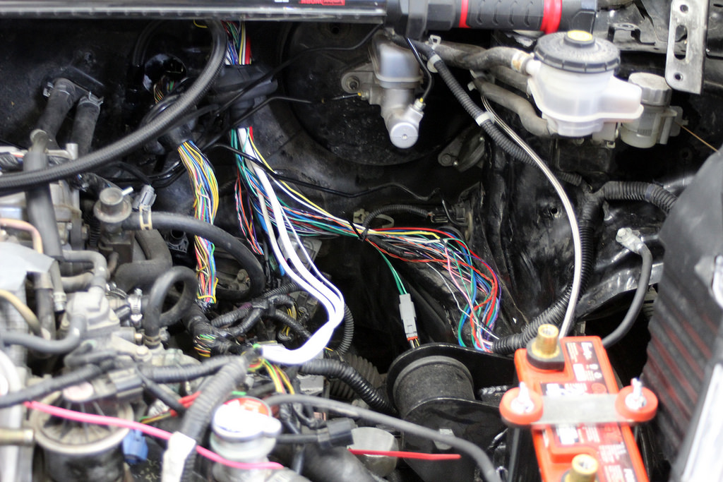

Here is the crossover for the ECU connectors

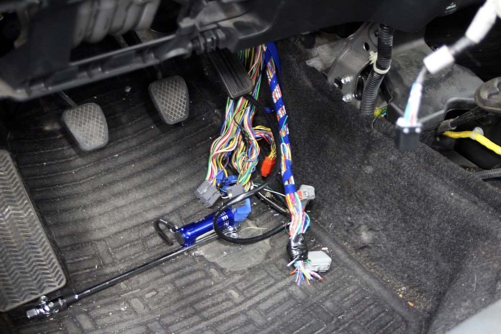

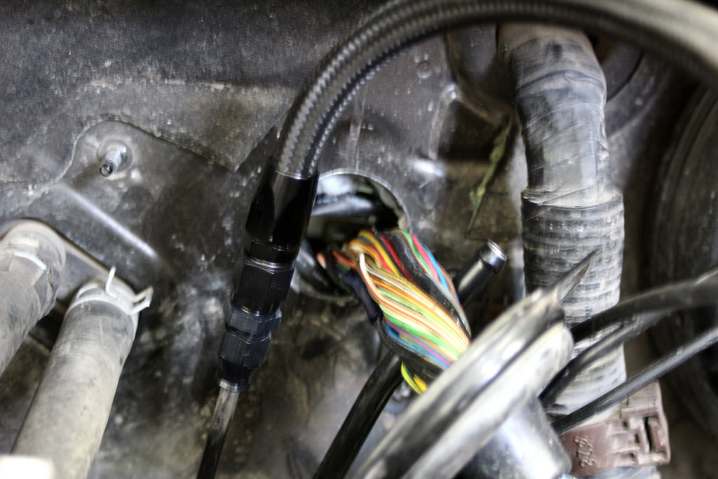

For the chassis connections I pulled all the old ECU wiring back into the cab

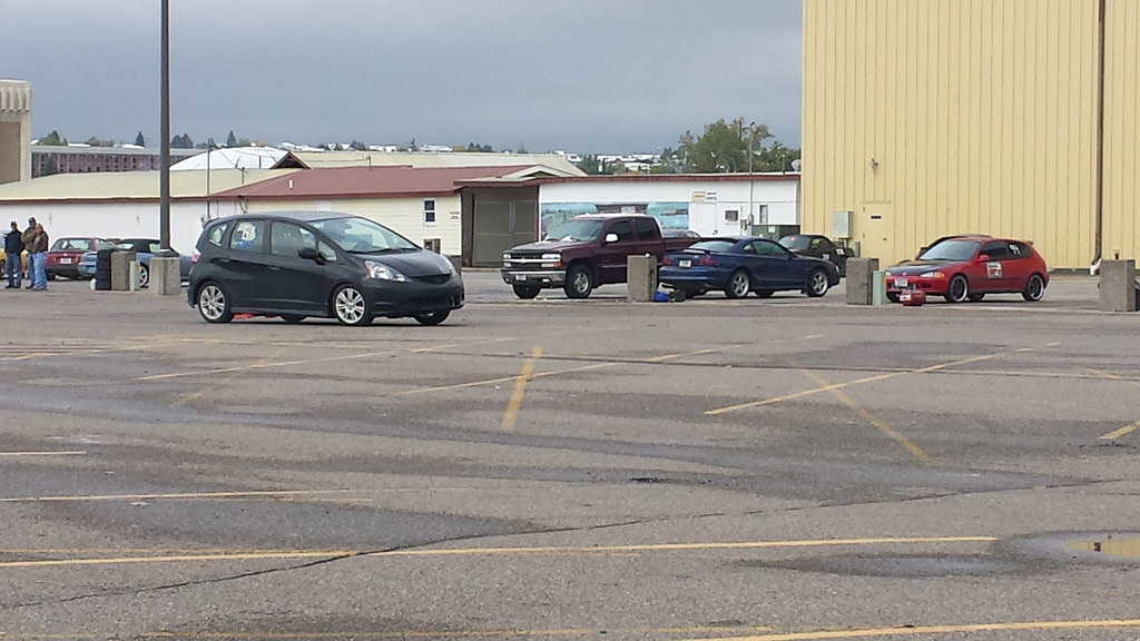

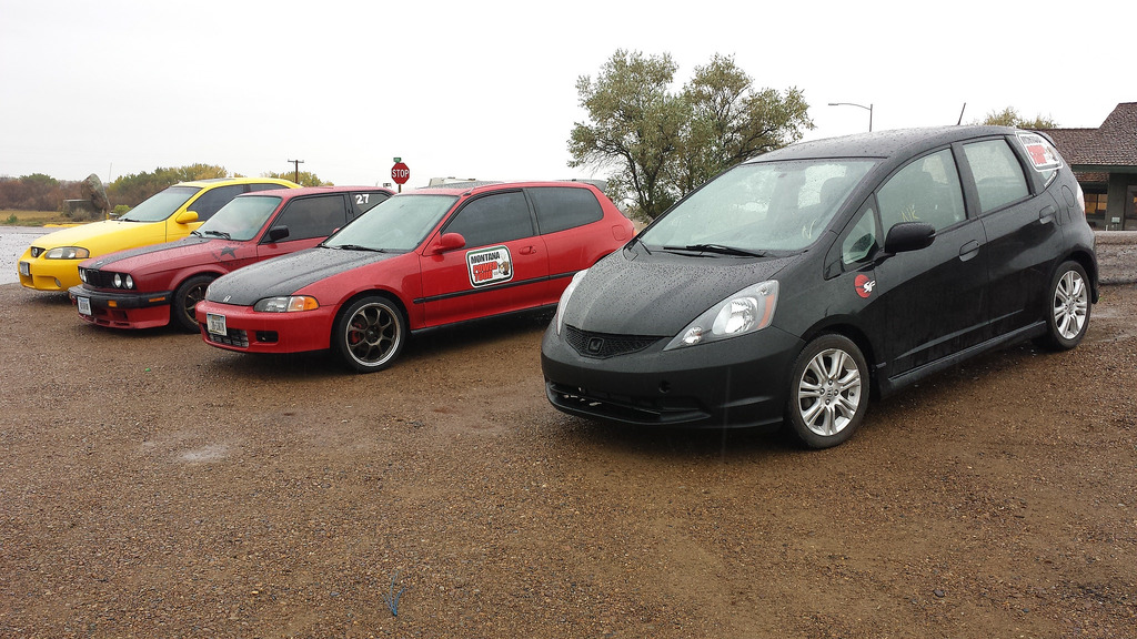

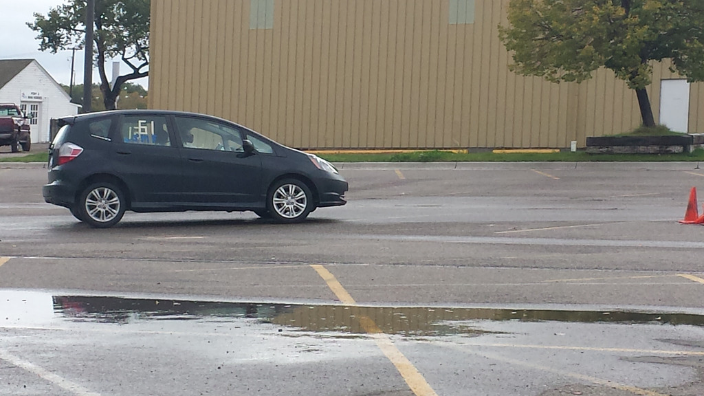

After all that she was ready to hit the open road for some SCCA.
It rained and snowed almost the whole time, I am thinking that the radiator is too big, the car had trouble getting up to temperature. When it was raining the heater air would barely even get warm, the gauges weren't hooked up, but the few times I check on the laptop the water was around 140f.

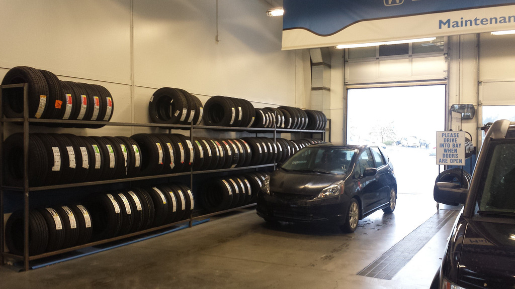

Stopped at Honda in Billings to try to get the radio code, the guy didn't seem to notice the new engine ¯\_(ツ)_/¯

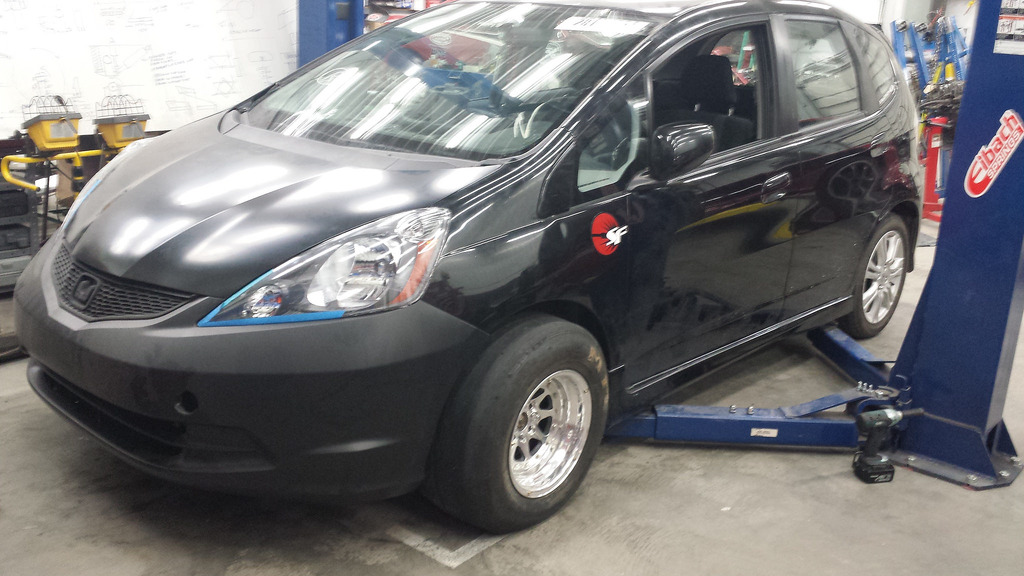

Then some action
Firstly, the Fit is a nice car, love the room and the stock stereo, super comfortable, and the stock replacement headlights are amazing. At the same time the stock suspension is surprisingly stiff, going to coilovers won't change the ride very much. However at the track this thing was crazy tail happy, which I am going to blame on all the droop. The track had a large sweeper at the far end and the whole time the car wanted to step out, there was some water on the track and it was hella cold, but later in the day it was still amazingly loose. If there was more time I would have rigged up some limiting straps, but it was only a one day event. Car really needs my LSD tranny in it, scca with an open diff is a disaster.
Then some action

The Odyssey battery looks great in there. I had that same one in my 2010 V6 RAV4. You could 'fit' a lighter Evolution battery in there as well. Was running this in my 2015 Fit for a while. It's 2lbs!
