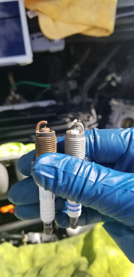

So on Sunday morning i finally got to perform the tedious job of adjusting valves and replacing the spark plugs on my Fit.
it was not a quick task, nor was the access to the engine as easy as in my S2000, but still, it had to be done, and 4 hours later, it was done with success.
Just for context, the car has 140K miles on it.
i have the full carfax report of it, up until i bought it it was handled in a Honda dealership and than @ a MIDAS auto shop near where i live.
it is not mentioned in the carfax or maintenance report that the SP were ever changed, and it certainly looked and felt like that when i took them off.
as for the valve adjustment, again, i have no reason to believe this was ever done to the car.
So the findings:
1. As far as valve adjustment, i used this video:
its only 5 minutes long, but it covers the job very well.
2. I was surprised to see that only limited amount of valves actually needed adjustment, and the variance to spec was very very low.
on all of them the adjustment required was to loosen them (they were too tight) and not the other way around.
for some reason, i was expecting it to be the other way.
3. For the spark plugs, like mentioned here before, they were very loosely tightened to the engine's head.
4. the spark plugs were also very worn, you could can see in the pictures the new SP gaps vs. the worn off gaps of the older spark plugs.
if with older engines, the electrode would corrode before the metal was eaten, now its the other way around, and the electrode is actually getting consumed before corrosion and residue build-up is effecting the SP performance.
and the results of the job?
The car feels much more responsive and like it has more power.
as for the fuel consumption, i still didnt get a read out yet, but i believe it will improve. only question is by how much.
i will update once i get some mileage on the car.
BR
Which valves required adjustment
Close up for comparison - 140K miles vs 0 miles SP
140K miles old spark plugs
