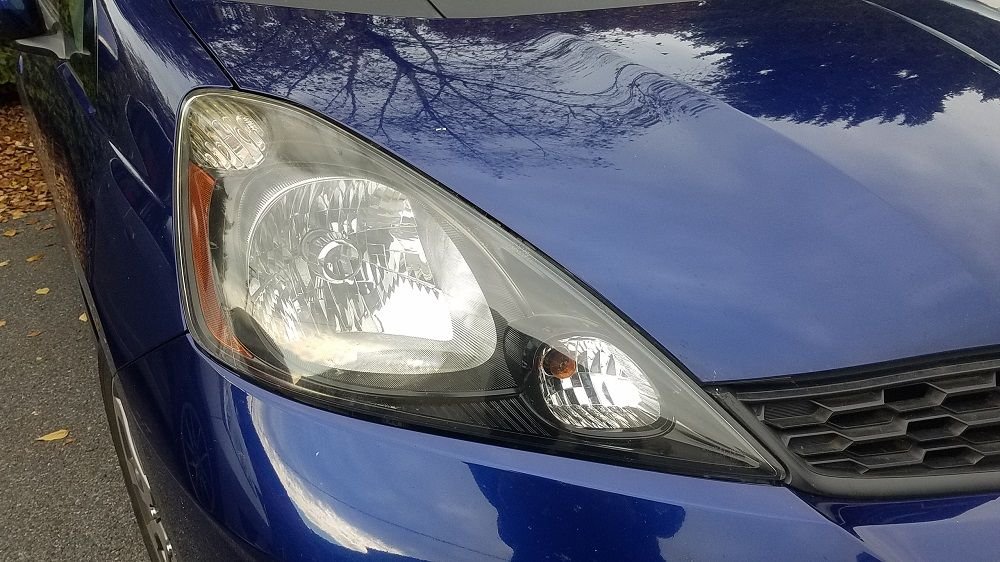

Yeah,
So these freakin headlights these days!
They start going Opaque..... can't see with them........ yo know......
The Fit's headlights are not super bad yet.... but, they are getting slightly white........ instead of crystal clear.....
It seems like it is on the inside of the lens..... Be good if I could take it apart.....
SOOO anyone know what to do in the case of Cataract Head lights?????
Thanks, J

I'd try to use one of the several lens (outside surface) polishing kits on the market first. That's a whole different breed of cat if the fogging / degradation is really on the inside. I've read about guys baking the headlight capsule in the oven and then prying it apart, so they could paint the non-bulb reflector surfaces black (style change to that of the '13 units that don't fit the earlier Gen 2 units).

Yeah, It really looks like it is on the inside.

As you can see, the blackout headlight has a certain appeal.
Please note how the corner of the headlight capsules intersect with the grill / fascia in different versions of these USA Gen 2 FITs.

If you didn't say that! I wouldn't have noticed the difference.... ANd even stilll took a couple of seconds.....
AND they are both GEN-2's (Dark blue being the new version?)
BTW:::::: Very nice and clear headlights..... Yeah, I am pretty sure mine are foggy some on the inside......

I tried polishing my headlights too and found out the problem is inside. It's not that bad anyways and i just bought a film to at least hide the ugly fogged up plastic lens.
Headlight set is too expensive for an old car, i'll drive this til I cant see anymore and just buy a new car!

Yeah, Mine is definetly on the inside as well.... Buffing them helped some.... but, it is definetly on the inside.... (weird)

I am having this issue as well. I used the Meguiars restoration kit yesterday, which worked well on my partner's car but my Fit's headlights still look foggy on the inside. Does anyone know of a way to take the headlight cover off to at least wipe it out?

Only way to remove the cover without destroying it is baking the headlight in an oven to soften the plastic and peeling the lense away from the base. Removing the headlight to do this required dropping the front bumper, and if you're at that point you might as well just put new ones in, found here.

So first of all the uv damage to the outside can be polished off. But you need to recoat with UV protectant otherwise it will come back soon.
usually interior fogging is MOISTURE. The only hole designed into the assembly is where the bulb goes. You can remove the bulb, place the car in sunlight on a dry day, and blow it out a few times with compressed air. If the problem built up slowly over time this will bring the moisture level back down; but if you have a active leak then the moisture will soon be back.

The DRL is the culprit in turning the interior lens opaque. Mine started exactly right above the the DRL bulb. The heat from the bulb is the cause. To prevent further damage, I remove the fuse.
