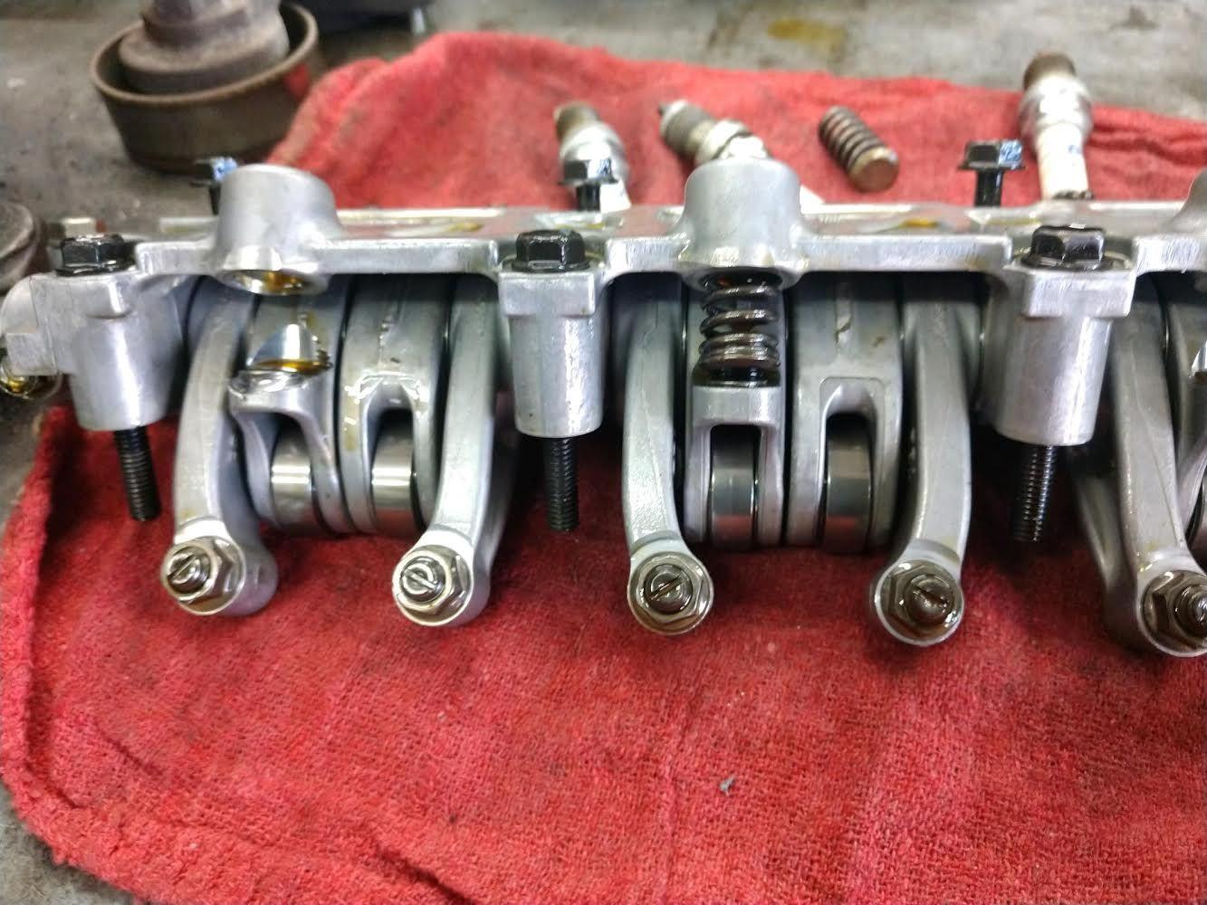

Status update, Needs a new Head
My loose spark plug issue got worse. The mechanic pulled the head and sent it to a machine shop to have the threads fixed. The threads were too far gone, so I will be getting a new (used) head installed on my car. I also found out that I was missing a lost motion spring for cylinder 4. Apparently there was a recall in 2011 that affected my car, but that was fixed at some point since I had no open recalls. Regardless, the mechanic is following the fix prescribed by the recall to all of the springs in order to prevent this issue again. Here are some pictures of the engine ripped apart.
Lost Motion Spring Missing

Thanks for the pics and update. How much is this likely to set you back?
