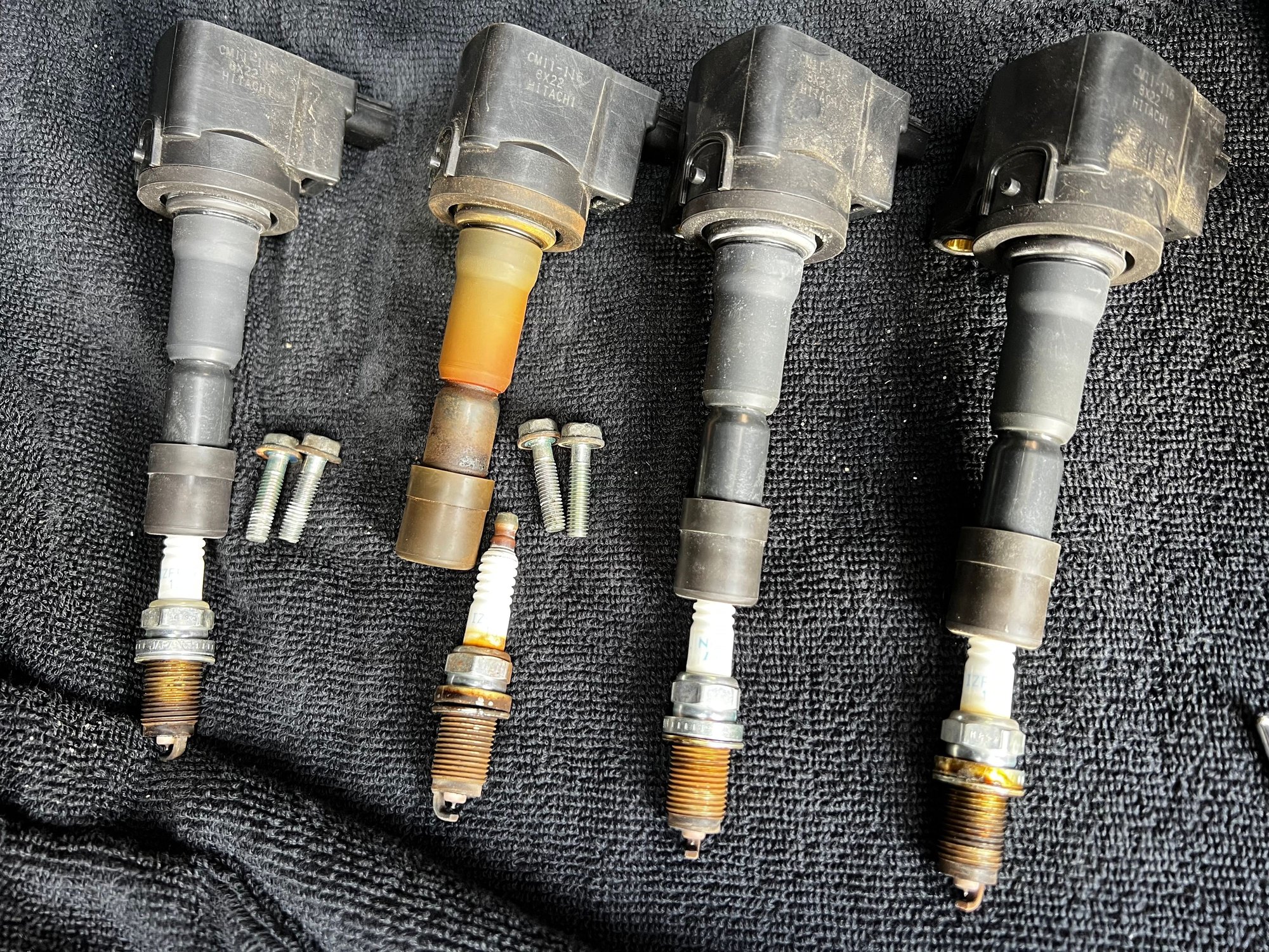

2009 Sport 66k miles. Only # 2 plug loose. The rest were tight. Also # 4 has oil on plug. Plan to change all plugs. Do you think # 2 coil still good?

thats not oil on the coil, it’s burnt from the plug being so loose. If the car still runs with no misfires it will be fine, just make sure to check your plug once in awhile as it will come loose again.
