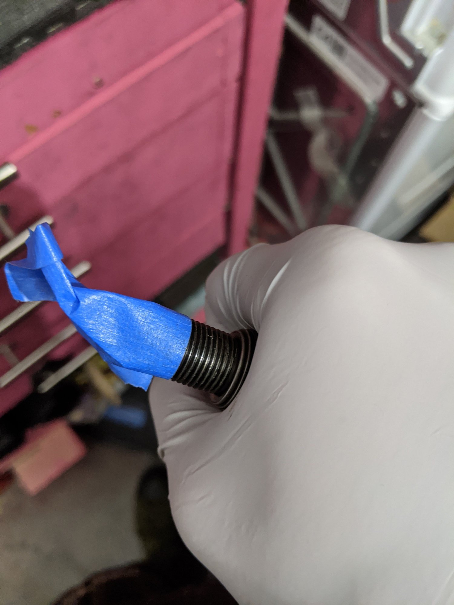

Joined: Mar 2016
Posts: 1,325
From: Metro Atlanta, Georgia
It's likely going to be quite a while before I pull the plugs, but the gasket aerosol lays similar to paint, just sticky like flypaper. I'd be quite shocked if it could stop removal.
I'm not sure what you're driving at in regards to electrical conductivity. To coat my spark plugs (this process is messy) I did something like this
Just getting the threads.
