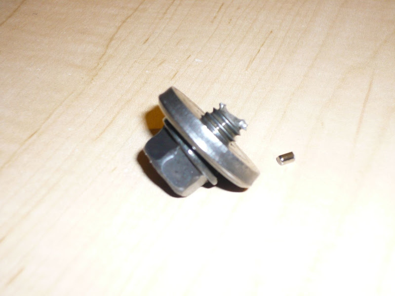

Cam sprocket bolt broke. Yup that is right. Dealership does not know the cause of it, but found the cam shaft to be seized. The reason that it was able to turn over is because only the bottom part was moving. Engine is toast. Block can be saved, but the head and everything else has to be replaced, per dealership. $9k to get it fixed.
Here is pic of the bolt they gave me.
Note: The car had a rebuilt title from a rear end and the factory warranty expired in April of 09. I am soooo SOL right now.

Sounds fishy. I wonder if this car/engine had more than just a rear end accident? The cam is under the valve cover which is right under the front edge of the windshield.
Theory:
Car gets in front end collision.
Valve cover and windshield are smashed.
Glass from broken windshield falls into engine through broken valve cover.
Cam sprocket bolt is either damaged during accident or over torqued by mechanic during repair.
Bolt finally breaks one cold winter day.

I like your theory. That might be right on. Maybe also the intake box was out or cracked and glass got in there. The whole thing is fishy and of course the seller did not tell me that.
