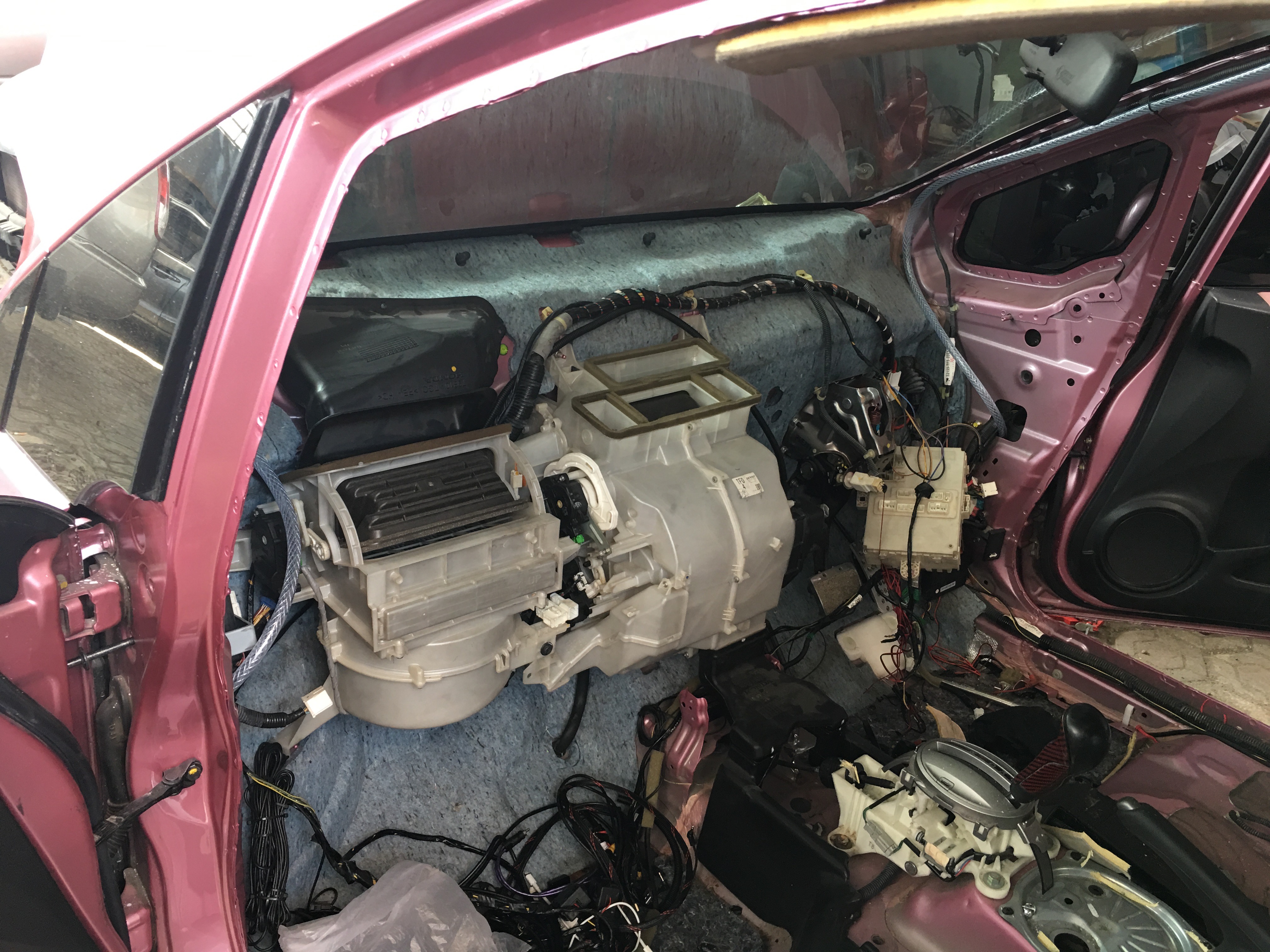

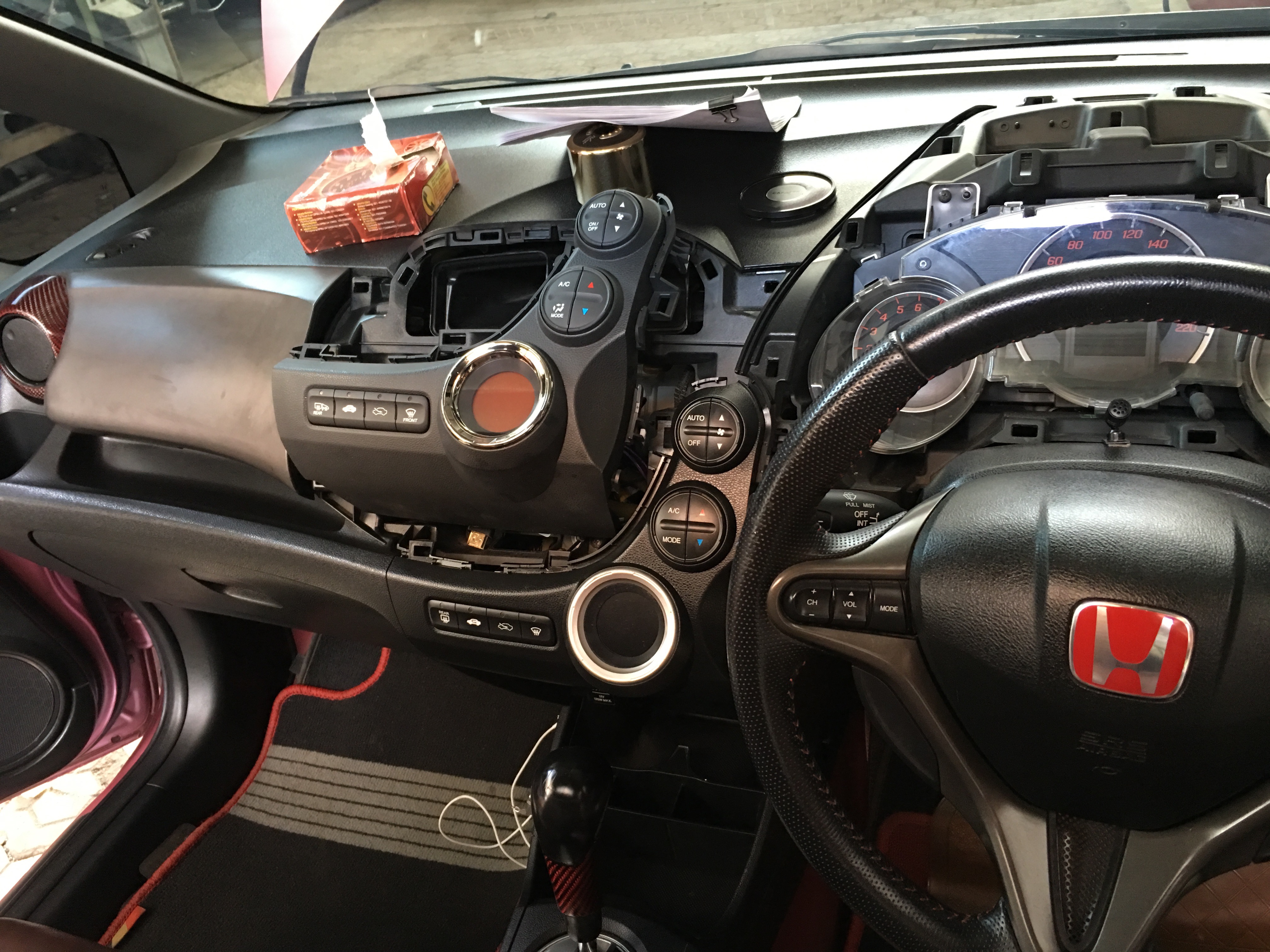

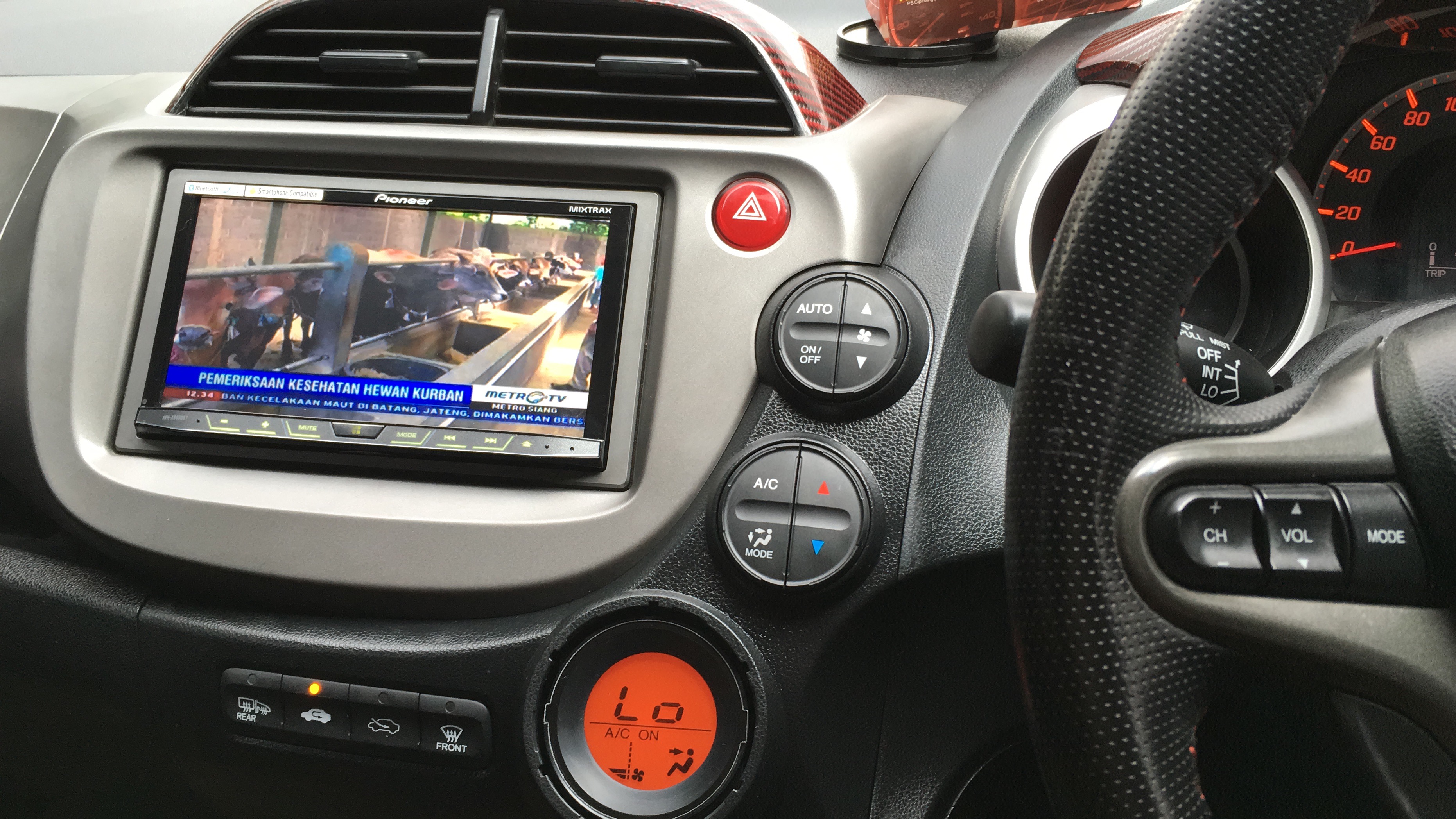

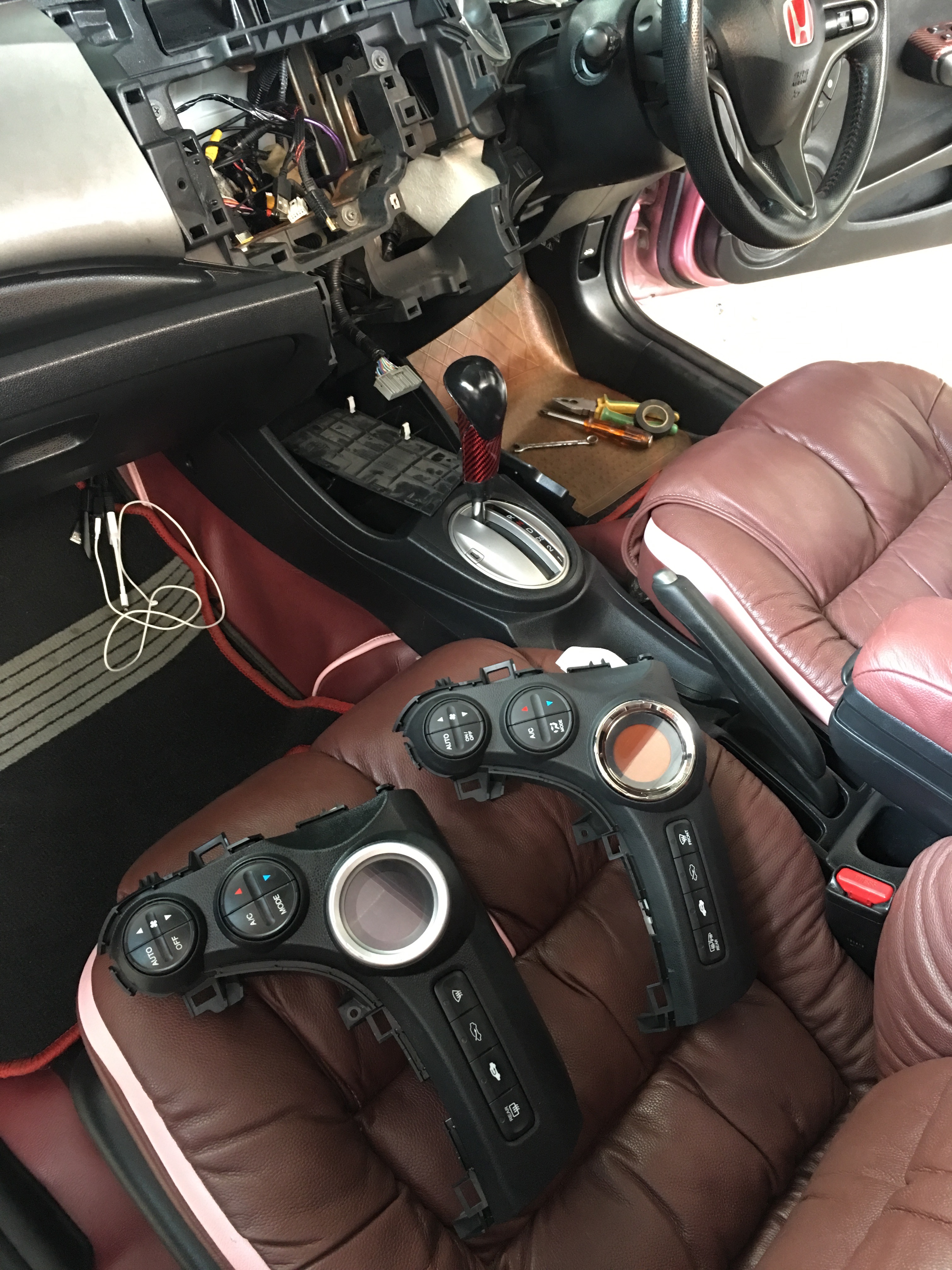

big thanks to connor i already done with my convert to auto digital climate control

Old Nov 8, 2016 | 10:12 PM
  #72
connor55's Avatar
Joined: Apr 2012
Posts: 1,779
From: edmonton, canada
Amazing work! I cant believe you took out the whole dash, but its definitely a cleaner job than what i did!! It looks great! Hope its working well for you
Old Nov 8, 2016 | 11:51 PM
  #73
eby's Avatar
eby
Posts: 11
From: indonesia
not connor its all because you inspire me thanks man

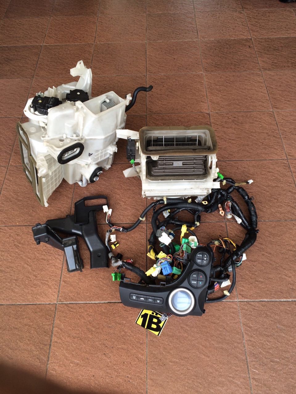

Originally Posted by camivill
Parts ready
Harness and AC control unit from a crashed car from Taiwan ( lucky me) I have amber lights inside so the blue light version was not an option for me, the rest of the components were outsourced directly from Honda distributors south of China.
I am a foreigner living in Shanghai China, so the main point was to get the used pieces, the problem is only the High end FIT comes with this unit, so there is no many sources to get this here in Mainland, rather common in Taiwan... the other parts are cheap originals, as they are made here, except for the Transistor and the Sensors which are Imported from Japan ( high tax) still worth the expense...
Thanks Connor.
@camivill do you have a link or website to order GE8 parts from China? MostCanadian GE8s we’re made in China.
