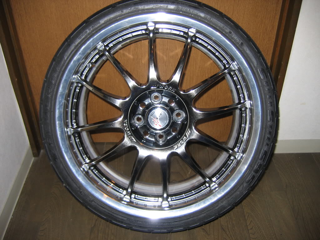

Here is what I`m going to use
Some dirty picz

You`ll be fine one the car is lowered a bit... camber will come into play then.. 1~2 deg is what will be required.. for the front.... now as for the rear you should have plent of room.... as for the tires most of the guys run over here anywhere from a 185/35/17 to a 205/40/17...... and the wheel track is the same he in Japan as it is on the USDM specs..
if you have take a few pic`s.... I might be able to help out some more after I see what your working with..
