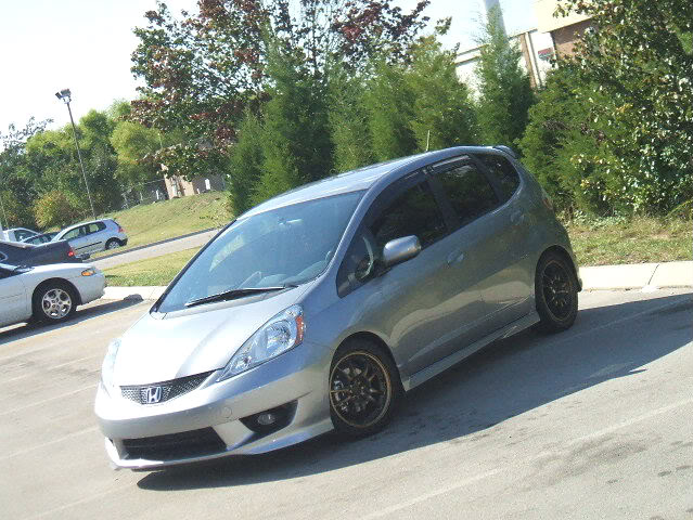

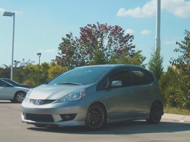

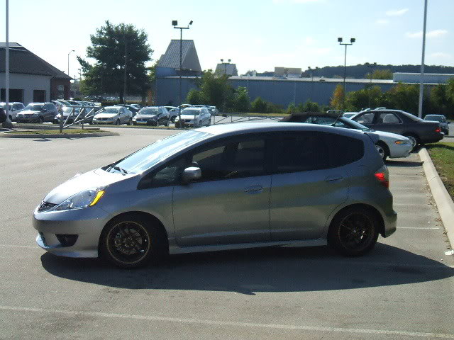

I can verify that you will have fitment issues. i just tested some 16x7 +45 rota c10's w/ 205/45/16 and they set perfectly flush with the fenders anything under +45 will stick out. and my camber is the only thing that made it possible i am lowerd about 2in's and before i was lowerd the same wheels stuck out about 1/4 in and now that i am lowerd they set flush.
