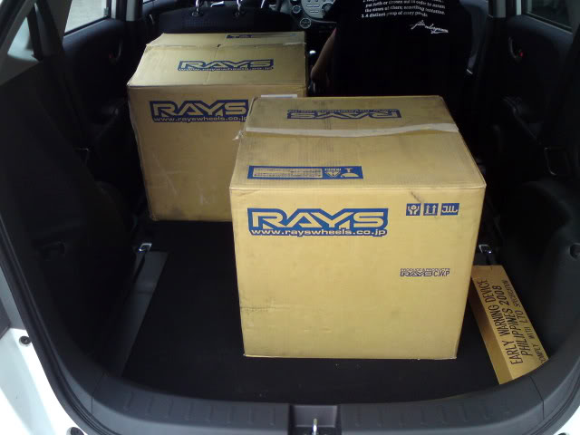

I picked these up a few days ago. 17x7 +43, I hope they fit flush with 205/45/17 lowered.
fronts will be flushed as for rear you have like another 15mm to make it flush

205/45x17's are too big diameter without risk of rubbing.

Actually it's 215 that's too big. 205 is the best size you can get with a 45 series on 17's

On my car and a customer's, 205/45x17 was oversize. not only getting rubbing but less mpg and accelertion too. Downshifted on every incline that used not to do.
That extra quarter-inch mattered at 43 mm offset. But thats not a guarantee; thats why its a warning, not a no-no.

I've been through several local tire shops today. From their suggestions I most likely will go for 215/40/17s.
This will be a safer choice right with regards to rubbing?
17x7 +43 215/40/17.
Its overall size is closest to OEM size rather than 205/40/17 and 205/45/17 based on the tire calcs.
