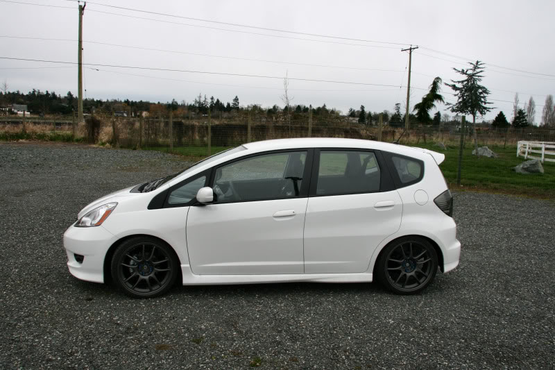

i should also add you might not need to roll the fronts, but you may need to cut/mod the fender liner, thats what will rub first
mine doesnt rub, but only on big bumps it scrubs the plastic liner, never hit the metal yet

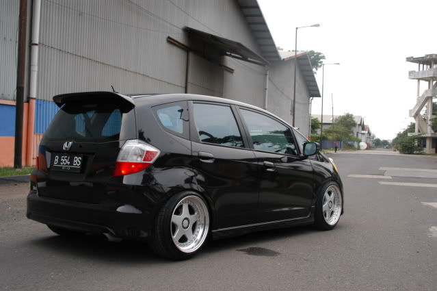

^the closest i've seen to those specs from donny's setup:
17" OZ futuras
https://www.fitfreak.net/forums/2nd-...17x10-ge8.html

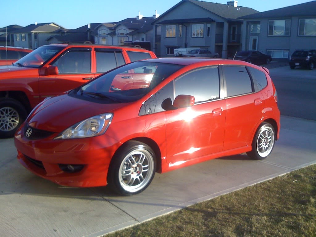

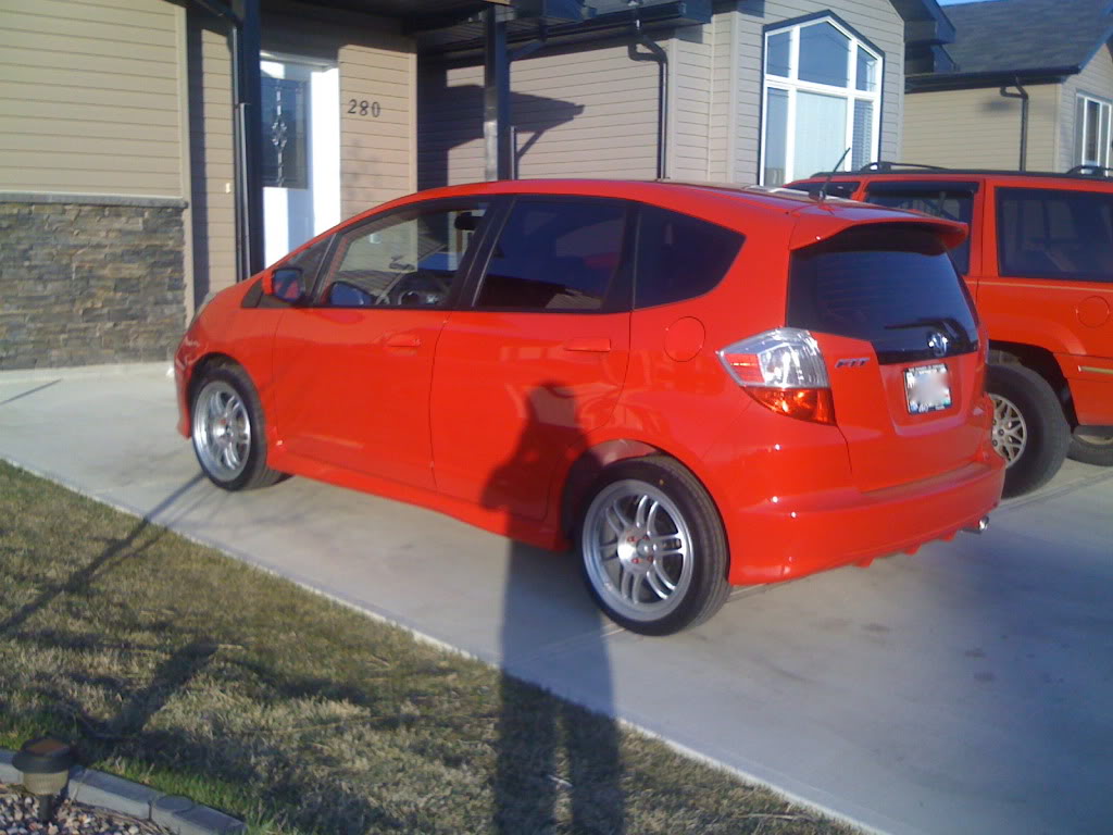

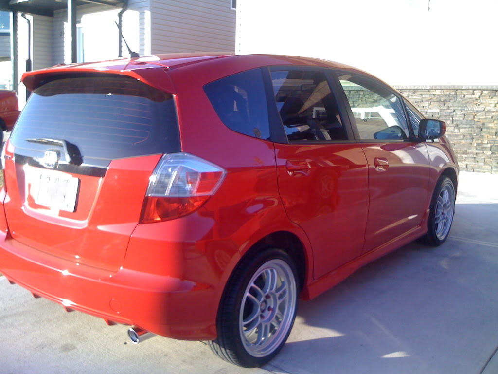

Just installed 17x7 +43 Enkei RPF1 wheels, With 205/40/17 falken ziex 912 tires. No rubbing so far in about 50miles, but have tried lock to lock with nothing to report.
Handling is way better! The tires don't feel to wash away on you nearly as much. Definitely more confidence in the car than before. Now it just needs to be lowered a inch or two.
