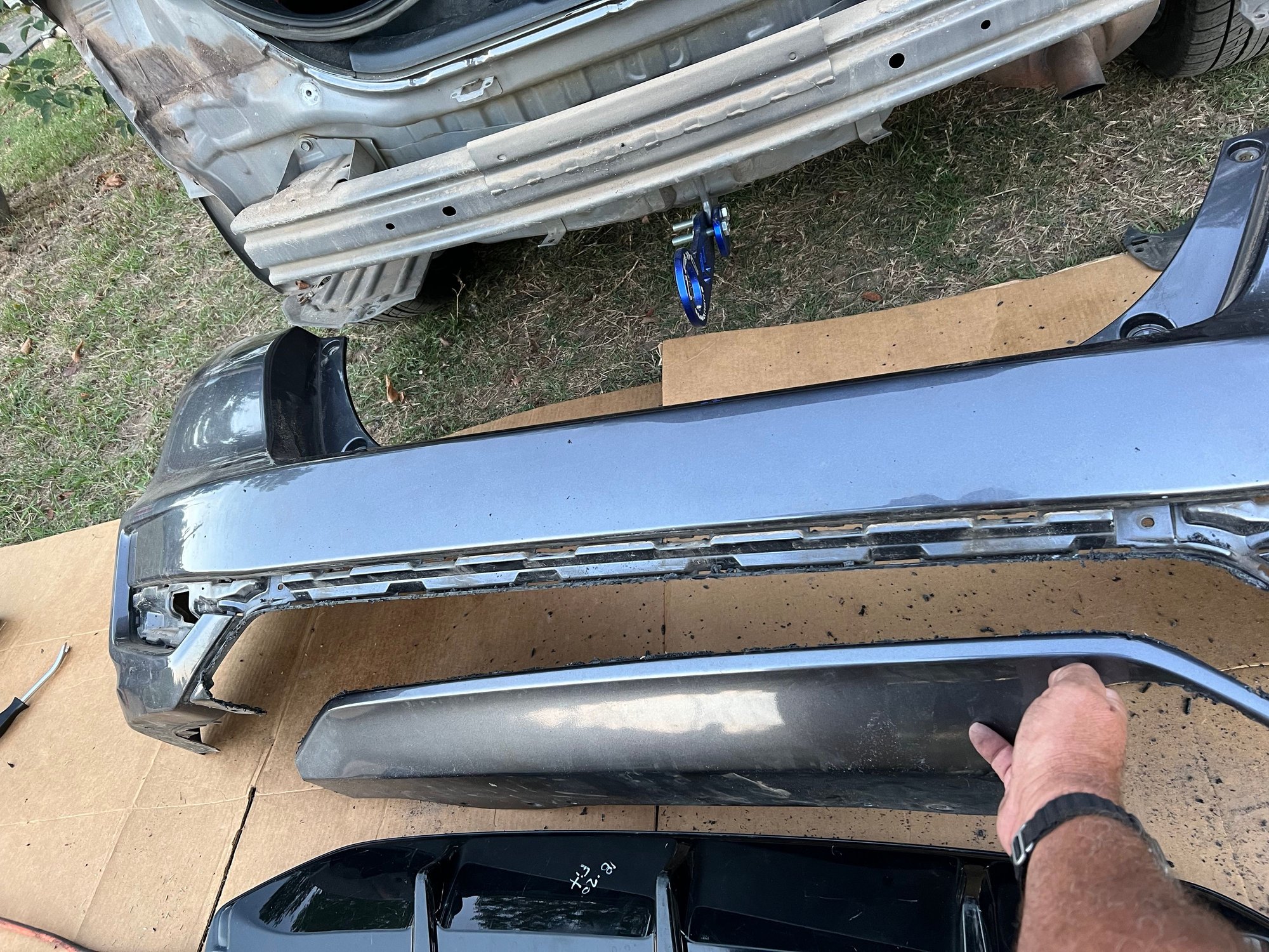

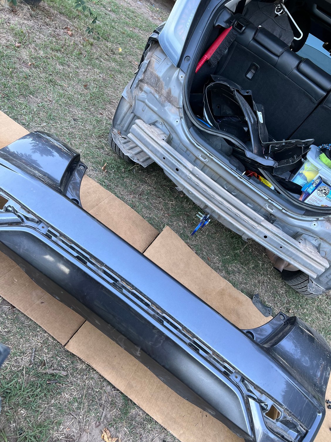

2018 EX-L bumper removed and trim removed
Cut the 2018 EX-L bumper cover leaving clip holes, and the two outside hole underneath were left

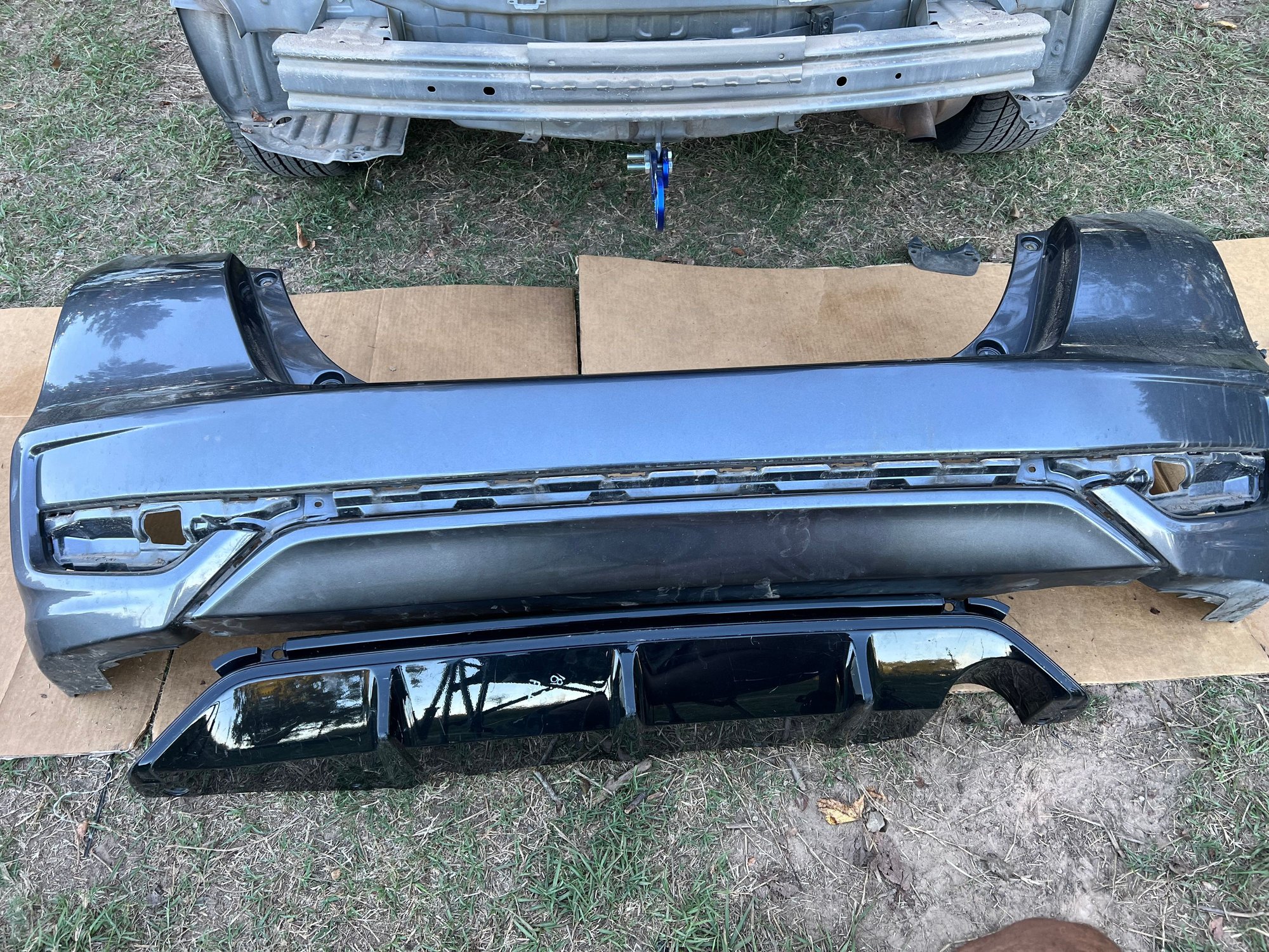

Sport rear valance next to bumper

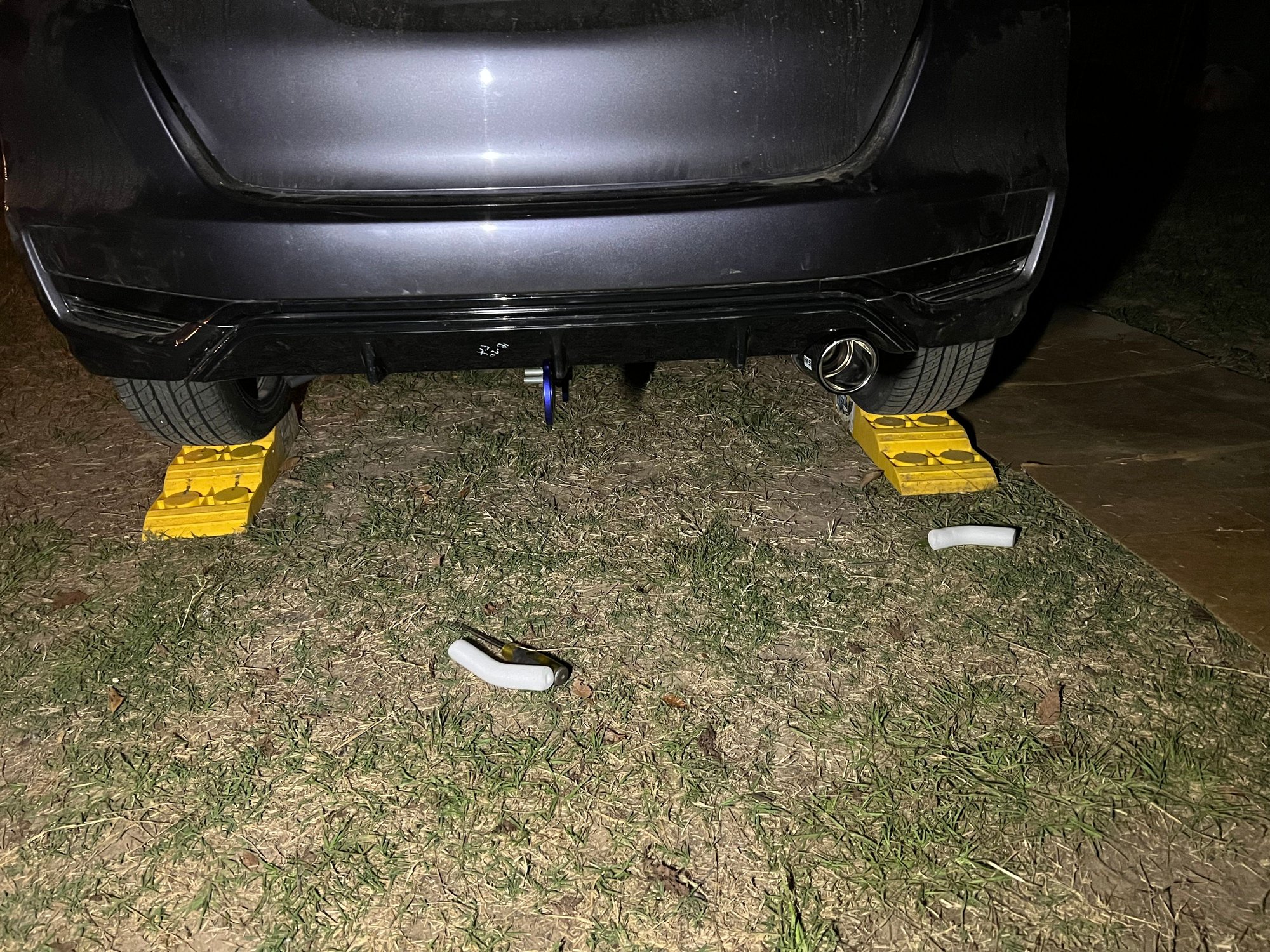

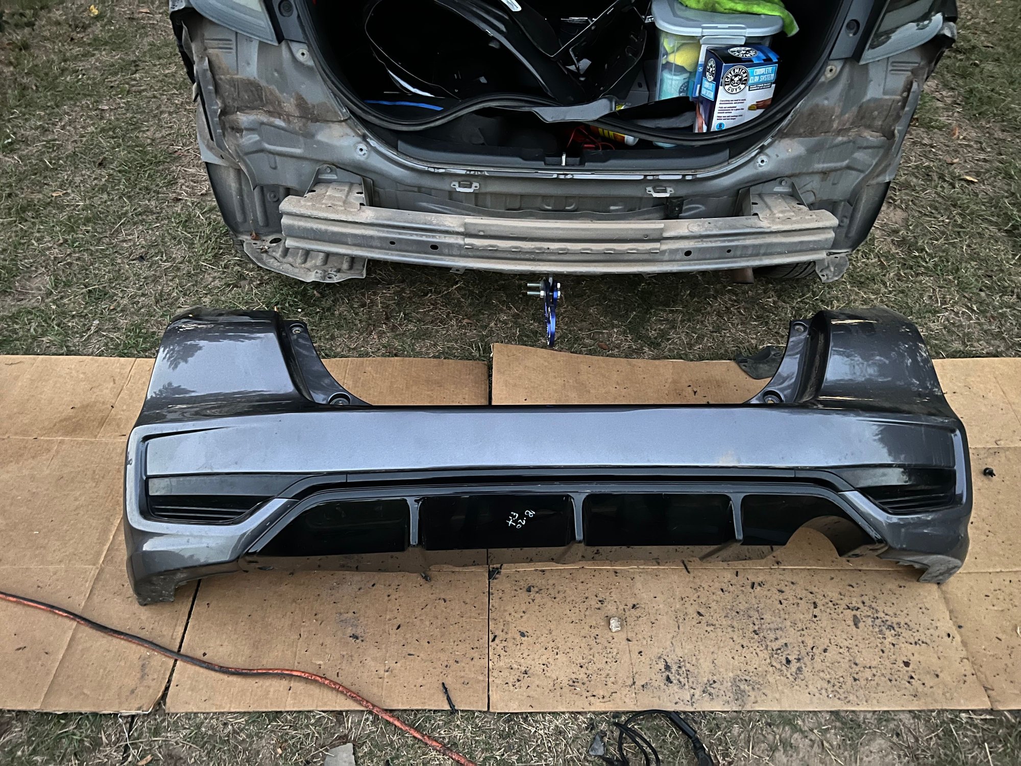

Sport Rear valance installed onto rear 2018 bumper
You have to have this Valance for the HKS muffler for the 2018 GK5 Hondas
