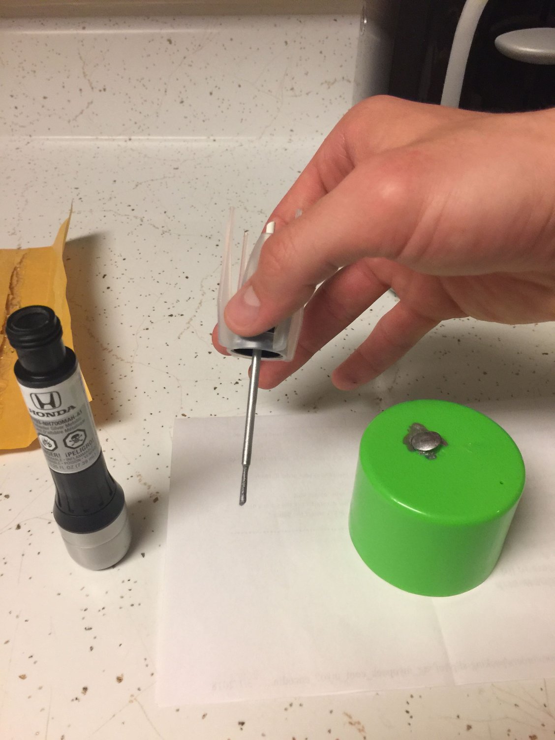

Our 2018 Honda fits have a license plate bracket that once removed, shows a black hole left over from the screw.
Bumperplugs.com makes you buy (2) and it is pricey.
This is a cheap alternative to that if you have touch up paint for your vehicle already.
Go online or to your local Honda dealer or online and buy Part Number 91518-SM4-003 ($2.60 + TAX)
What you are going to do is paint the clip using the touch up paint for your vehicle, I highly recommend the OEM Honda paint vs the Autostore ones.
Place the clip inside a box of some sort to hold the clip while painting.
Once that clip has 2-3 layers on it, you are going to use the clear coat portion of your Touch up paint stick.
Once that is dry, all you have to do is snap it into the existing hole in your bumper from the license plate screw and you are done!
Pictured here is the finished product on my 2018 White Fit Sport, excuse the dirty car/plate frame outline, it is muddy and snowy out here in WA. I am making this Modern Steel Metallic one picture in this DIY for a friend.

Thanks for this thread, I just installed the bumper plug in my Fit today! I bought a CPO 2017 LX 6MT about 2 weeks ago and was very irritated when I found a hole in my bumper under the license plate.
I used this part number plug: HONDA 91518-SM4-003
I got Honda touch up paint from Amazon, I put three coats of paint and three clear coats on so I feel like it should last. I would recommend using a razor blade to shave down the plastic around the hole before inserting the plug so it sits completely flat (I thought of this after I did mine). It looks a bit lighter but once I wash my car it should blend in better, also it looks 100% better than a hole or a license plate bracket.
