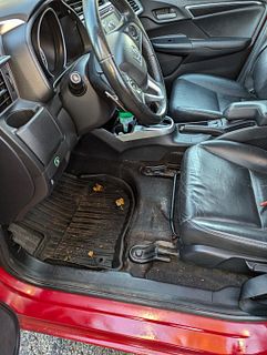

Hi all. Anyone ever try this drivers seat mod? I just stumbled upon it when seeing if track extenders are available. I just did mine exactly like the video and it worked 100%. It's a royal b!tch hammering in the little tabs and they have to be absolutely flush but in the end I got about 2+ inches extra room. The video dude is right. It still has a very positive stop at the new end of the travel. Just like the video, I had to notch the front corner trim to clear the track when seat was at lowest position. If you zoom in on the closest seat track, you can see the notch. A pic of my results are at the bottom.
