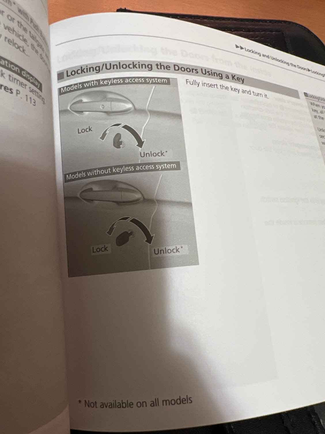

Thanks for your help! I thought so too it doesn’t make sense but as I dug a bit further I found this in my own physical owners manual… note the bottom where it says not available on all models.
I tried what you suggested but it literally does not turn any other way but to lock the car.

Just wanted to add this note quick.. I have a 2019 EX and just went out and tested locking/unlocking with the key. It worked as shown in saveMT's post. Also, the two arrows mean you tilt the key twice in that direction to unlock the doors, but you only need to tilt the key once to lock the doors. Seems more like a mechanically actuated electrical switch as opposed to a fully mechanical lock/unlock cylinder like on my 1970 Mark III.
