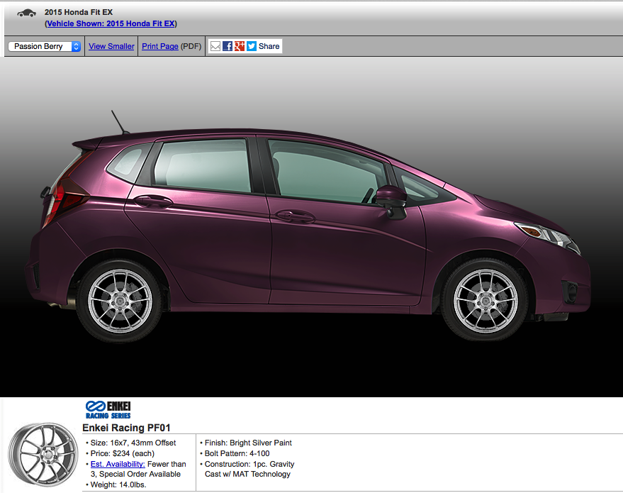

Enkei PF1 16x7 14.0 pounds
$234 +$14 shipping x 4 = $992

Who is going to spend $1000 on wheels and get 16x7s?
17s would add two pounds per wheel, 18s add 3.5 pounds per

Those who want to run wider tires such as 205/50R16 without going to 17s.

Perhaps me...
Originally Posted by GeorgeL
17s would add two pounds per wheel...
To be exact, the 17" PF01 are 1.6 pounds heavier than the 16" version, and still 2.4 pounds under your aforementioned steelies.
The RPF1, which appears to me may be the most popular wheel here on FF, is only 14.6 lbs in the 7x17 size, and 3.4 pounds under your steelies.

It seems you're saving weight with the wheels, then gaining it right back with the wider tires. You end up with a greater moment of inertia because you're moving mass away from the center of rotation.
In any case, the effect is negligible, but they sure look kewl.
