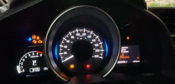

Misfire #1 - all warning lights
Add another one to the list! (Warnings lights were - power steering problem, road mitigation problem, emissions system problem, VSA problem, Hill Start Assist Problem, Road departure mitigation problem)
2018 Honda Fit LX over here, freshly purchased (less than 1 week ago!) the vehicle is seemingly in pristine condition with 36,000KMs (22K miles) on it, meticulous previous owner all services done and documentation kept, has Honda Plus extended warranty. Started throwing up the error a few days back, disconnected the battery and that cleared it for a day, then it came back, had it diagnosed by my mechanic and a misfire on cylinder #1 was found, he recommended I go straight to Honda.
Took it to the Honda dealer, misfire on cylinder #1 came up -
Notes from the dealer invoice:
-air/fuel cylinder test...all cylinders passed
-inspected spark plugs...cleaned carbon
-swapped 1 and 3 ran vehicle scanned...no misfires
-code initially was P0301 misfire No.1 cylinder
-went on long road test, runs good....pls monitor
total cost $135 (CAD)
I certainly will be monitoring the issue. Really hoping the infamous "injector gate" issues don't follow previous models. I intend to document my experience as a first time Honda owner extremely thoroughly. Thanks to everyone who has posted here, I read this thread (and the others relating to similar issues) prior to setting out and it gave me the context and confidence to better educate myself about this vehicle and the potential next steps with Honda should the issue return.

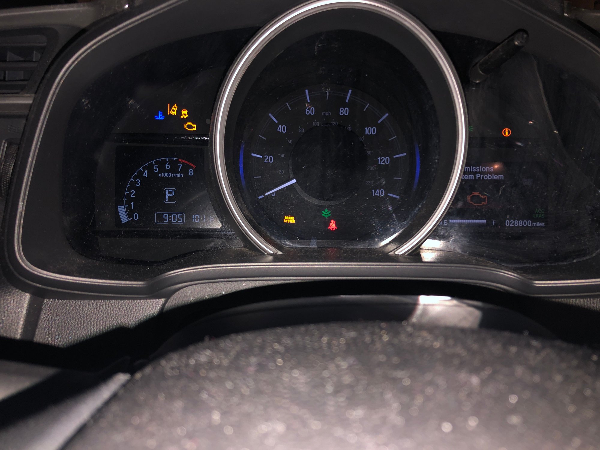

I’m getting ALL the 2015 fun
2015 Fit bought from a single owner in 2019 with barely 20K on it. I have only put another 25K on it but have had a bunch of the Fit issues.
I’ve had the solder issue for the odometer panel for at least 3 years and just live with it. The TPS light has been unreliable since I bought it second hand in Jan 2019 (and that meant one time I had a slow leak and didn’t know it until it was totally flat because I just assumed the sensor was being stupid as usual). I had the push button starter problem earlier this year. The dealer fixed it even though it’s long out of warranty because I brought the service memo with me. And yesterday I discovered the CEL/fuel injector fun.
I turned on the car and the CEL, TCS and steering lights came on. The TPM blinked rapidly, which is NOT typical. I took it directly to my mechanic and he called this morning to say the code was for fuel injectors and he recommended an additive and a couple of tanks of high test, but it’s fine to drive in the meantime.
The diagnostic printout was still in the car when I picked it up, and it was code 0172, which isn’t on the service memo I’ve seen linked here.
I had also read that sometimes the gas cap can cause faulty reads, so for the heck of it, I unscrewed it and put it back on. Voila! No lights.
Am I in the clear now? Should I go ahead and do the additive and switch to high test for a bit? Is this car going to nickle and dime me to death? I love the utility and versatility of it but I don’t like the number of issues I’ve dealt with in 3.5 years of ownership.
