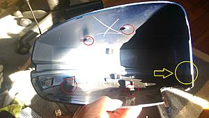

Seperate the skull cap.
Hi guys,in the yellow circle there is 3 hinges locked each other. Any advice or guidance to separate the top colored and bottom black skull cap? Thanks in advance.
Attached Thumbnails How to remove side mirror skull cap from 2015 Honda Fit?-imag1754.jpg

Once you undo all 4 clips (I used 4 screwdrivers to do this), the cap comes off easily.
Start with the 3 hinge clips first and firmly but gently pry the piece apart.

Okay noted! i did tried to pry the 3 hinges open,but i got scared half way worry it'll be flimsy and breaks. i shall attempt again!
