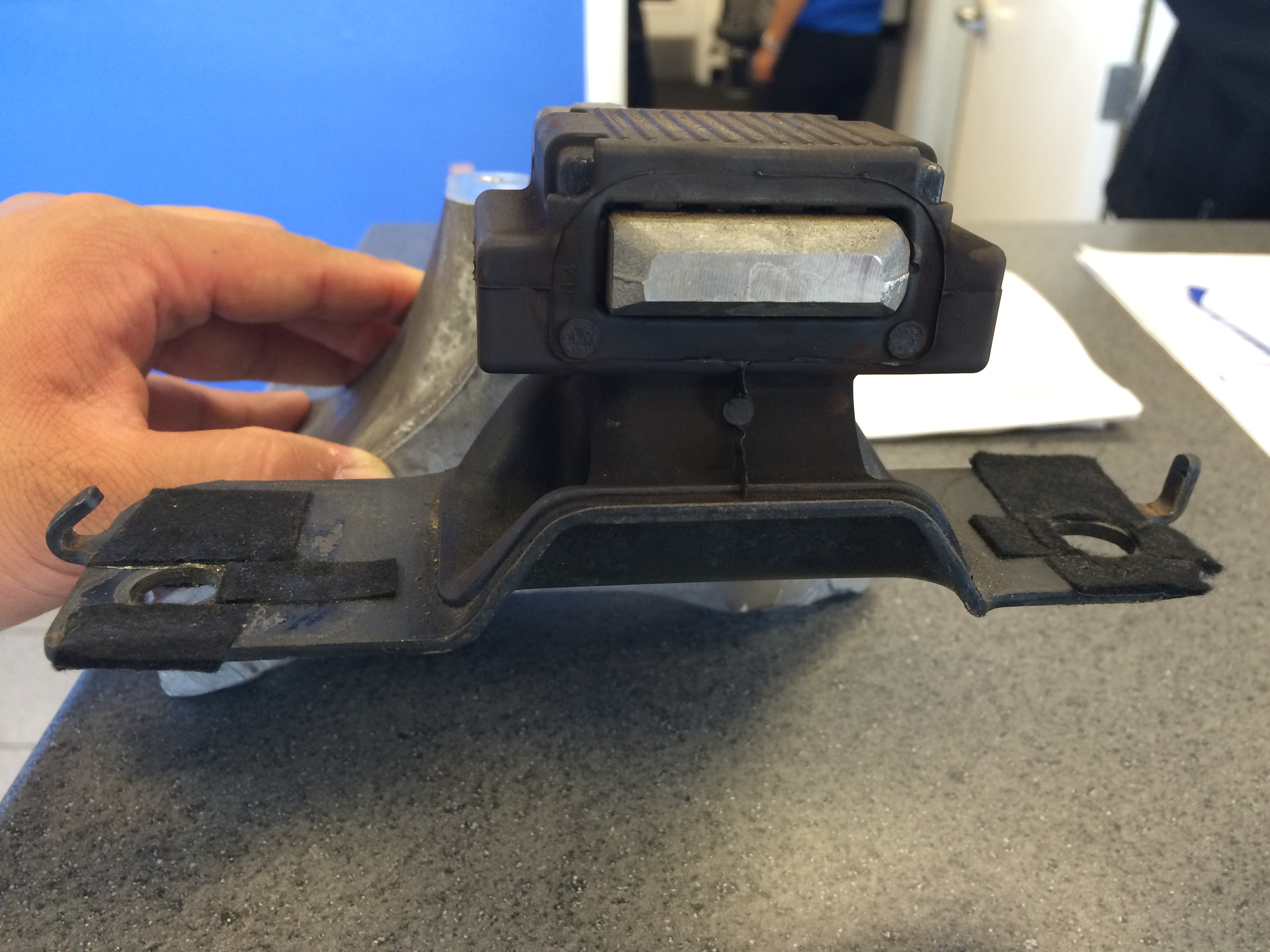

Update: So the new transmission mount went on, so far no more clicking noise that I can hear. Will continue to monitor as I drive it for the next week or so. Waiting for the temps to come up a bit as well and see if that changes things.
So after the test drive with the Honda Field Rep, they they put down felt pads on the mount where it bolts down to the chasis, and that muffled the clicking noise dramatically.
My concern now is how long will the new mount last before it starts clicking again? I highly recommend you all to bring it to the attention of your local Honda dealer so that collectively they will see the issue and maybe revise the mount or issue out a repair part (ie: Urethane bushing...etc) for it.

Very interesting. You don't happen to have a part number on that TX mount?

Here ya go.
Attached Thumbnails GK MTX Clutch/Transmission clicking noise? (Long Rant)-img_1126.jpg   GK MTX Clutch/Transmission clicking noise? (Long Rant)-img_1123.jpg   GK MTX Clutch/Transmission clicking noise? (Long Rant)-img_1122.jpg   GK MTX Clutch/Transmission clicking noise? (Long Rant)-img_1119.jpg   GK MTX Clutch/Transmission clicking noise? (Long Rant)-img_1118.jpg

So a little update after spending some time behind the wheel and putting about 600 miles on it.
To date, no clicking sound can be heard that I am aware of. I hope it is permanently fixed so that I can enjoy this vehicle for what it is.
If yours click, I would definitely have it documented/repaired so that Honda is aware of the situation and perhaps issue out a updated part of fix for it.
I wonder how many units out there have this situation that the owners are not aware of it...

Hi MellieBean. Soo gad it was taken care of in a swift manner. When u get the car back, just give everything above the transmission mount (Airbox, tubing, sensors...etc) a firm shake to make sure they tighten down everything. Had a few bolts that were put back, but looks like they only finger tight it. No big deal.
I wonder if they will issue out a revised motor mount or lower plate that has a tighter tolerance clearance???
BTW, how many miles were on your car and how long have u been noticing this? I figure with my 2016, I shouldnt have had this issue yet.

I'm at about the 2K miles post new mount and no clicking noise yet. Fingers crossed.
I think it is definitely a design flaw that has a very simple fix with a rubber or urethane padding to close up the tolerance between the two metal surfaces. This is evident by the decrease in noise when the felt pads were applied.
Please do me a favor and come back with a status report after the new mounts are installed so that we can keep track of progress of this issue.
