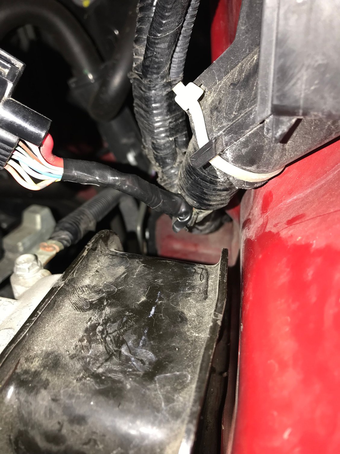

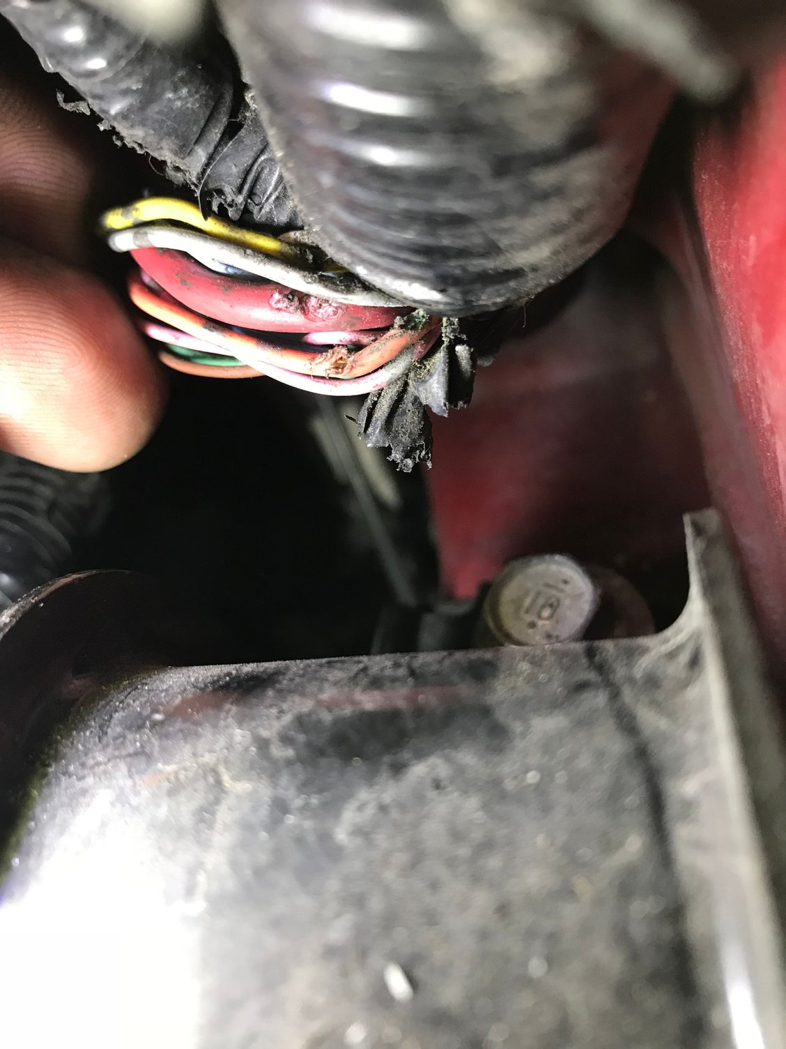

So here is where things really took a turn for the worst... My three year love affair with this car may have ended right here. It appears the reckless so-called mechanic that touched my car at the dealer, and installed these wonderful stacks of washers (sarcasm), he must have been terrible with his tools too... This harness connector was disconnected and lifted up for this picture, nothing else was done for this picture. That little electrical tape was exactly as you see it. Exposed copper wire will also be shown in a later picture.
This is without doing anymore than disconnecting the socket connector.

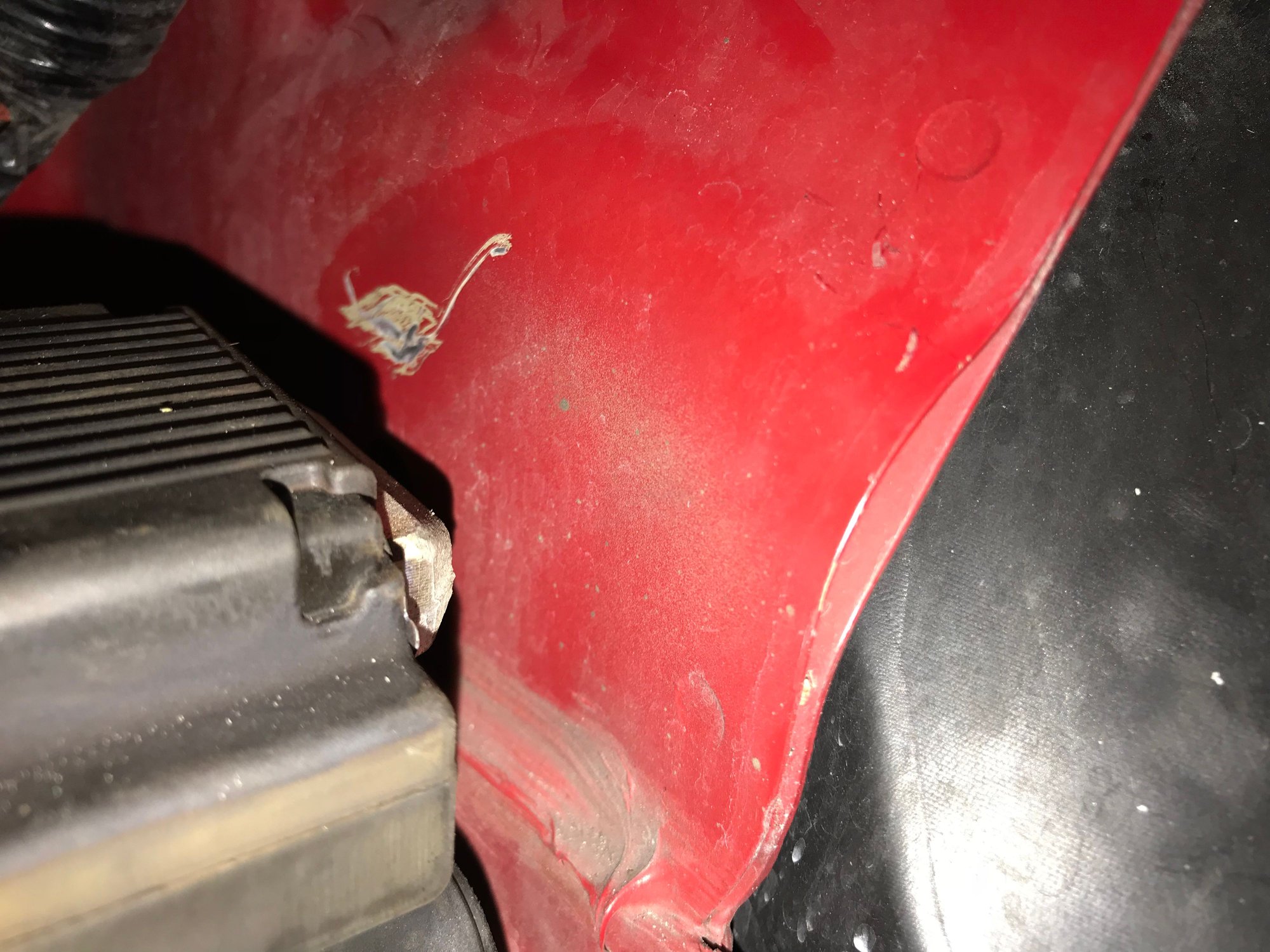

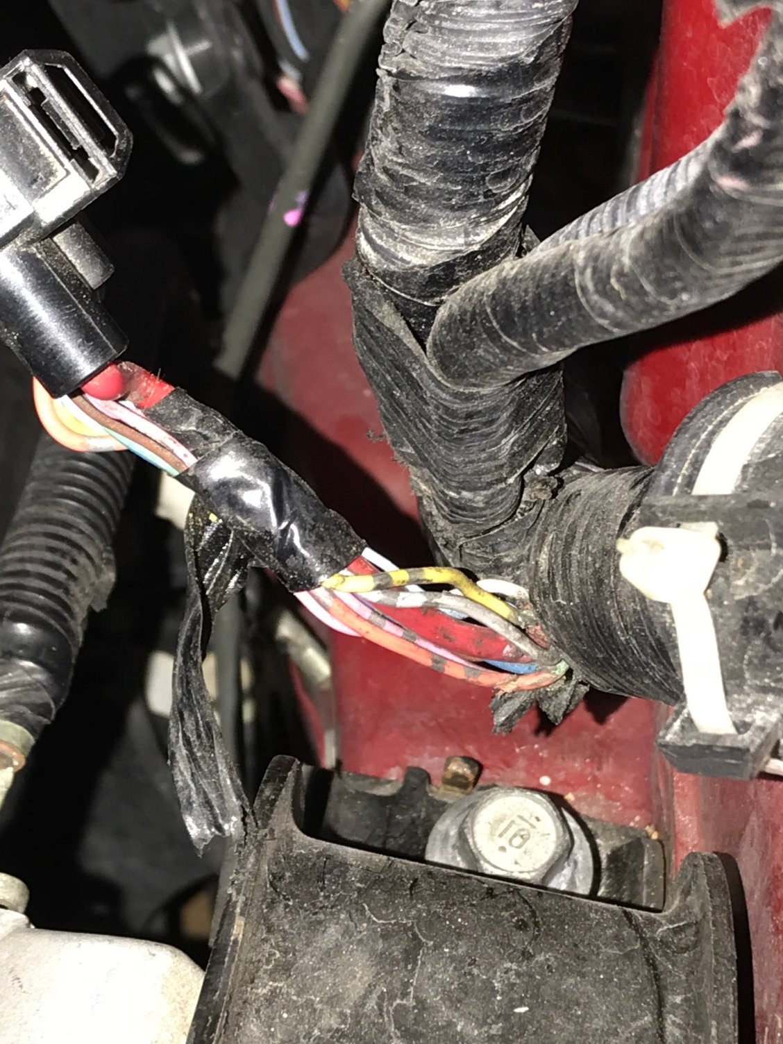

Picture I took as I noticed a little damage and stood there shocked as I noticed no wire loom and a terrible electrical tape job.
Giving this a much closer inspection since it appears this harness has been spun around a power tool and likely had the loom ripped off of it. Notice the open wires showing.
I put a band-aid on this for now and I guess I'll sadly ignore it until this is handled with Honda. The following picture is the temporary fix.
Electrical tape to the best of my ability. Not sure as to its future...

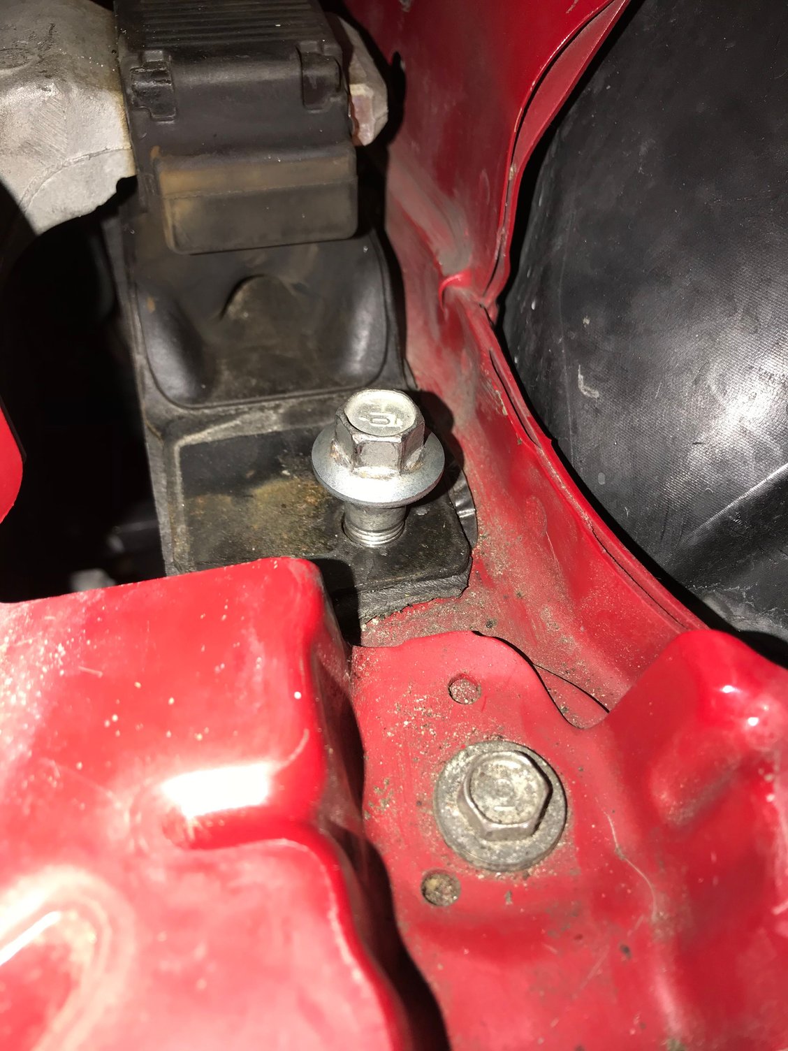

Here is a picture of the rear bolt being held next to my new 30mm bolts. You can see why I thought 30mm must be the fix. The silver washers were installed by the Honda mechanic. The black washers were installed by me in an early quick fix since the bolt was getting too tight to force it in. A better summary... it took more washer to fill the gap and get the washer to stop spinning on the bolt.
Oddly half way up the threads there is a sealant and just past that is thread damage. I'm speechless over this entire situation.
Also I was curious how far in the OEM 45mm bolt would go before getting uncomfortably tight. I'm wondering if the factory female threads are protruding and designed to work like a lock nut? Anyway, here is a picture of the bolt installed about as far as I was comfortable.
This explains the use of washers. I know I'm still recommending the 45mm bolts the OEM uses, even though this looks like this. There is nothing below the female threads so the bolts should work. Maybe there is paint, primer, or maybe they are protruding head nuts that are supposed to act as lock nuts. Too many assumptions.
I believe the 30mm bolts are long enough for right now. Because I had them and because the 45mm are for sure damaged, I will use the 30mm bolts until I know more about a future fix.
While putting the car back together I was bummed to see that quality control also couldn't install the wire protection correctly so I repaired this too..
These go together like Lego's and there should not be wire showing. They fit so tightly that there is no way this was caused by me or the so-called Honda mechanic. Just fuel on the fire as I feel let down.

i have the same noise and now i am undecided what to do after seeing cyclingfit total desaster what the dealer did to his wiring loom, that is just terrible
hope no one else has had that kind of damage having their mount replaced

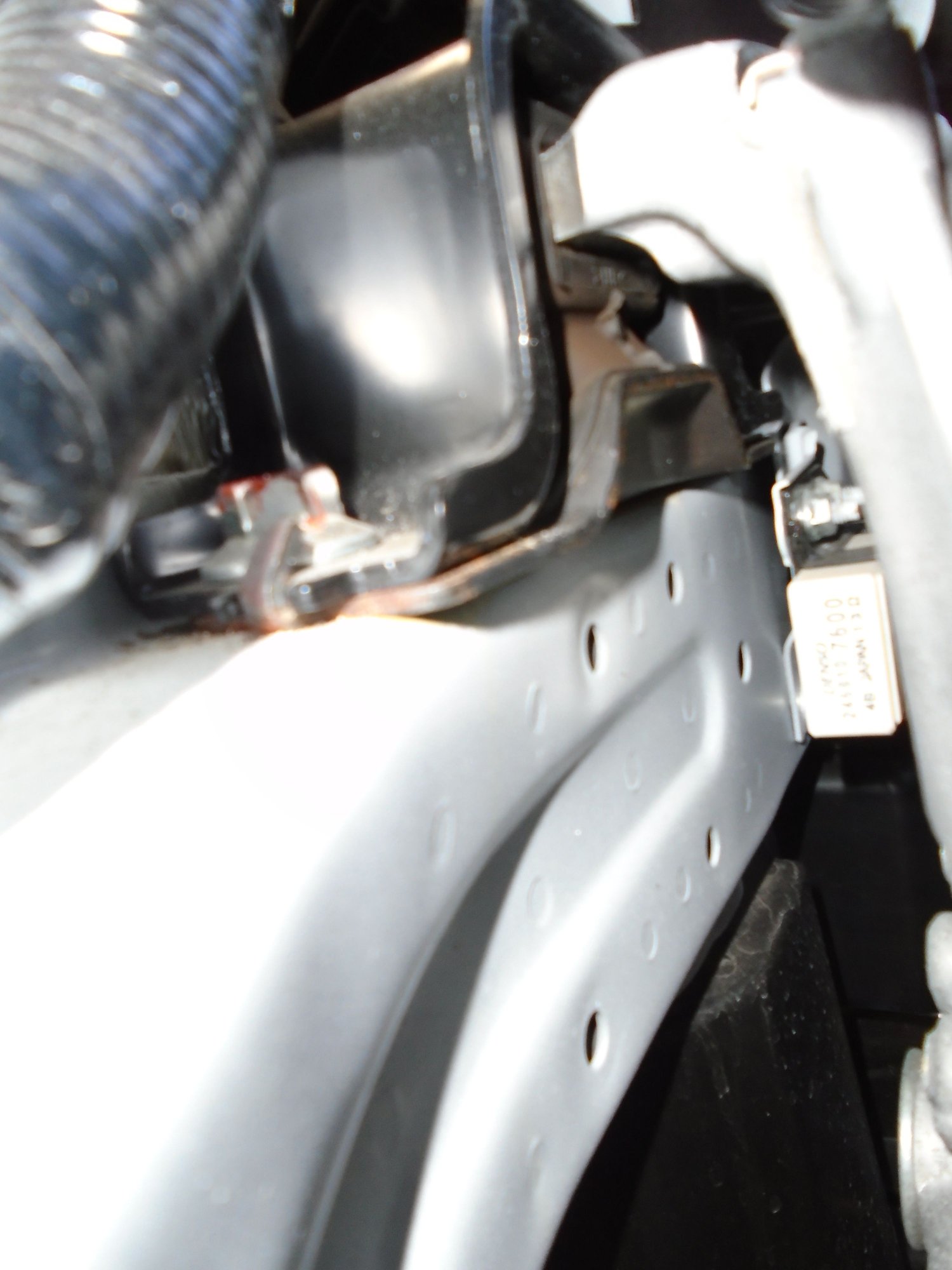

i had a look at my mount and discovered it has some brown stuff on the rubber middle bit (all the pics i have seen have black rubber in the middle) and some rust type stuff (or maybe some grease the factory put on, hopefully) on the lower metal piece, im not best pleased with this, i still have the noise from driving off from stop but my car is right hand drive and the clutch is quiet for all of you who thought it was something to do with the clutch, my noise is in the left side the same as the usa cars though, i need to find tie to get it booked in but it might be september on the service when i get it in

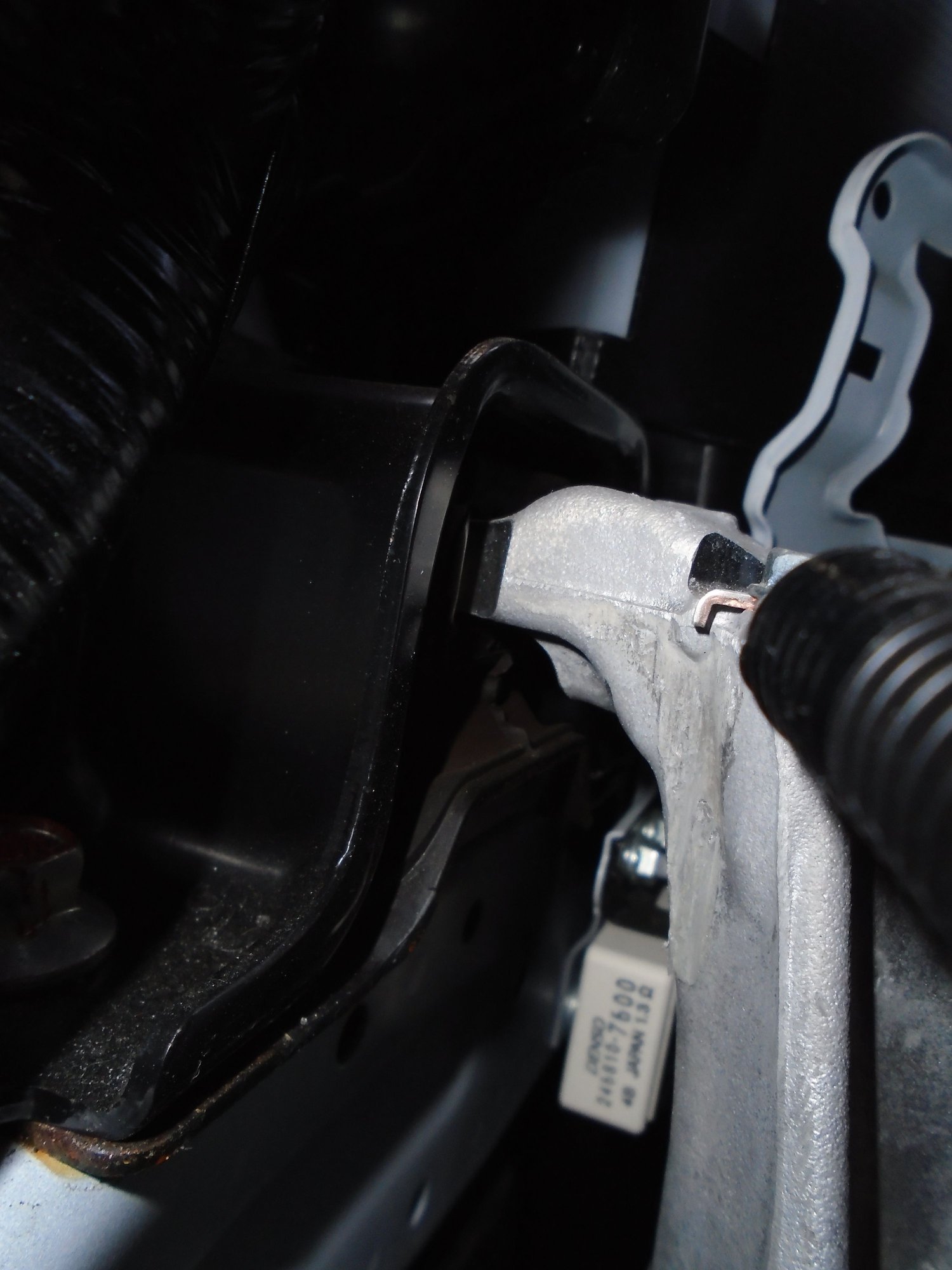

So under the car I was looking at the trans mount. While there I noticed there is a kind of heat shield that wraps around the left side (driver) axle.
This shield uses what looks like a stainless mesh washer on both sides of the mounting tabs.
What is really odd is that the shield is not held tightly in place. Bolts are tight but if you just grab it you can clank the thing back and forth.
it makes a clunking sound when moving it around and I can see from the fret marks on the shield that it indeed has been flopping around.
The mounting point above it does the same thing.
Just seems odd that they would allow this piece to float when there doesn’t appear to be a need for it?

has anyone else got the rusting onto their car from the transmission mount ?
here are a couple of pics of mine, you cant see anything from the top you have to get close in

Originally Posted by 96_lxr
Jhass,
No need to pull the battery unless you feel it’s necessary. Both the trans mount and the heat shield are easily accessed if you have the engine splash shield removed and the front of the car raised. I did check my trans mount while I was there. It was tight, no signs of rust.
From previous comments by others, I was under the impression that the bolt in question was directly under the battery tray.
Allowing that heat shield to move may be necessary, but it would have been nice if Honda had done so in a way that didn’t wear off paint (inviting rust).

I was looking at the photos from Monkeydave. This is the mount I checked when I did my oil change. Perhaps this is the rear mount people are referring to and not the front mount?
i will take a mirror and see if I can see the mount under the battery.
At any rate when you have the splash guard removed grab that heat shield and enjoy the clicking sound when moving it up and down.
