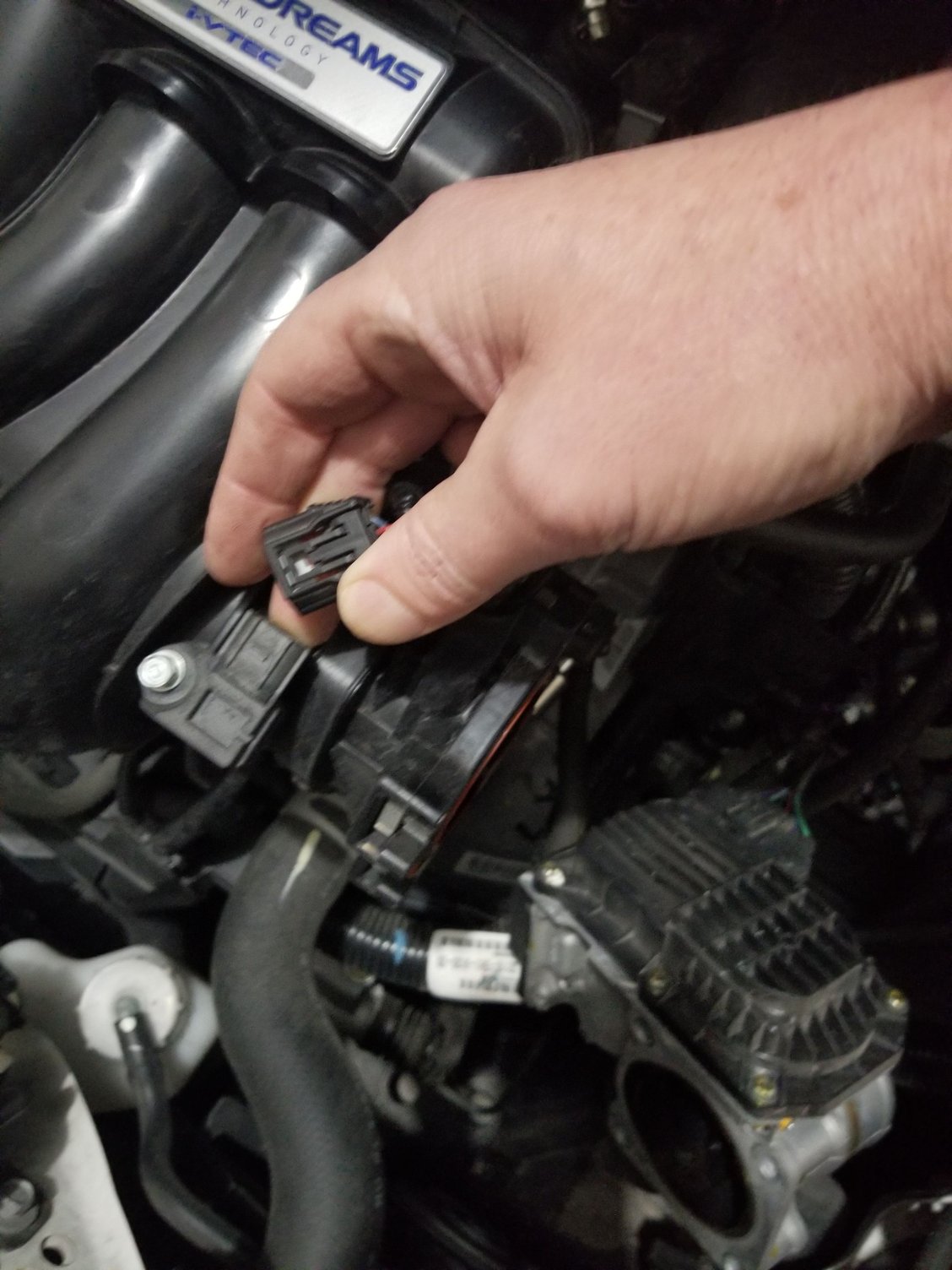

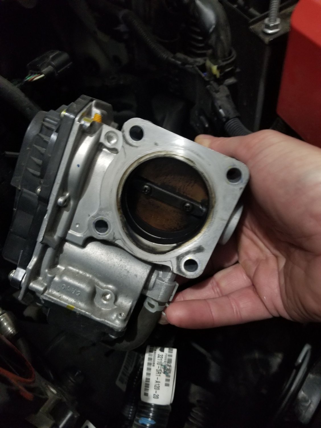

With the intake off, you can see the throttle body bolts there are four, these are the ones on top.
And here are the two below
Comes right off, and I just left it connected by the wires, and the two coolant lines. Leans over to the left pretty easy.
The opening to the intake. I can see there is a restriction in there :/ Waste of plastic...
Couple of connectors to remove, MAP sensor? IAT? Who knows...
A few vacuum hoses to remove also.
Another connector

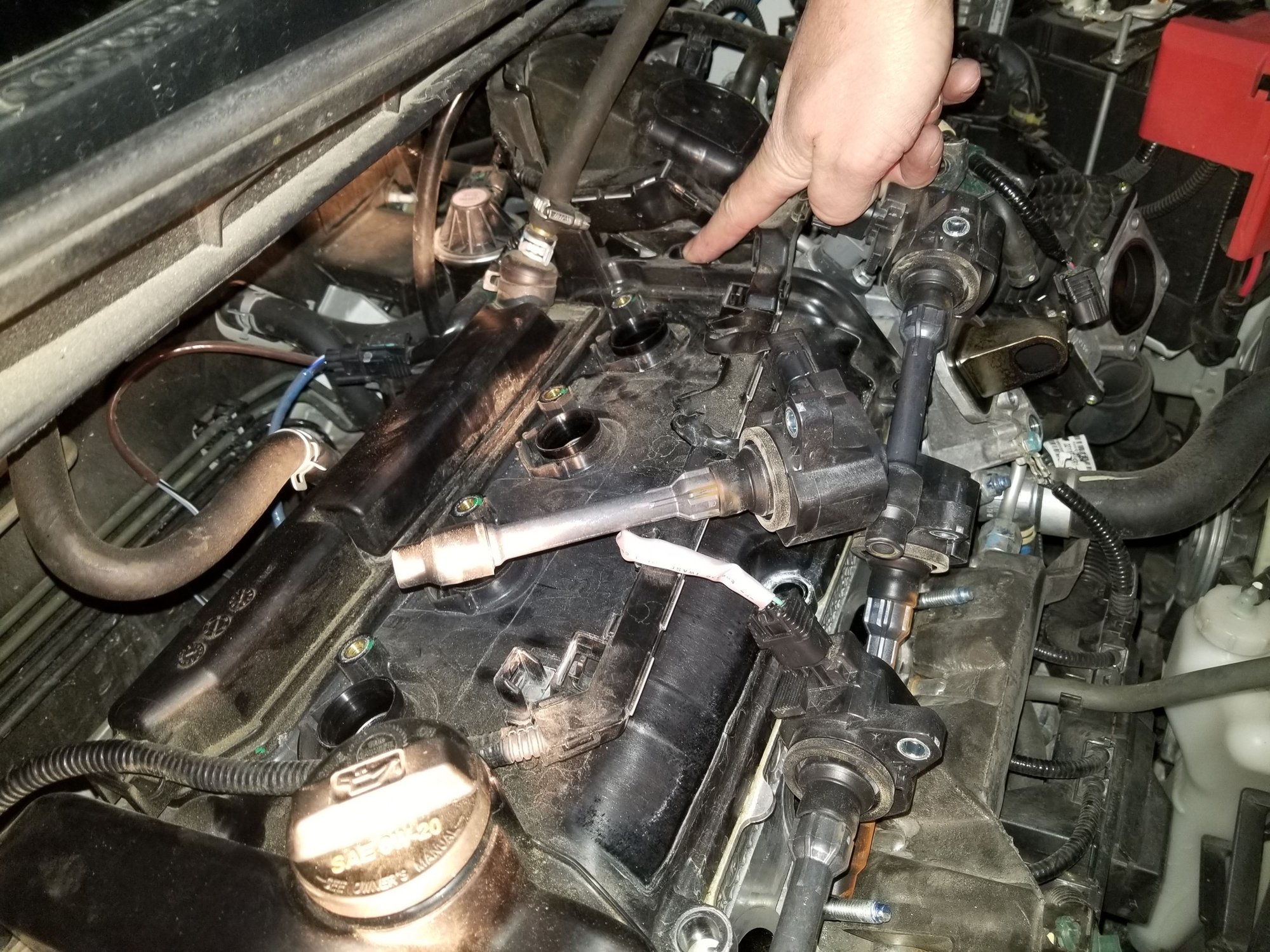

Pull out the coils which are on the spark plugs, 10mm bolt holding each down.
Wiring harness has to slip off valve cover.
Another permanent zip tie
Remove the 10 bolts 10mm and voila there is your valve train.

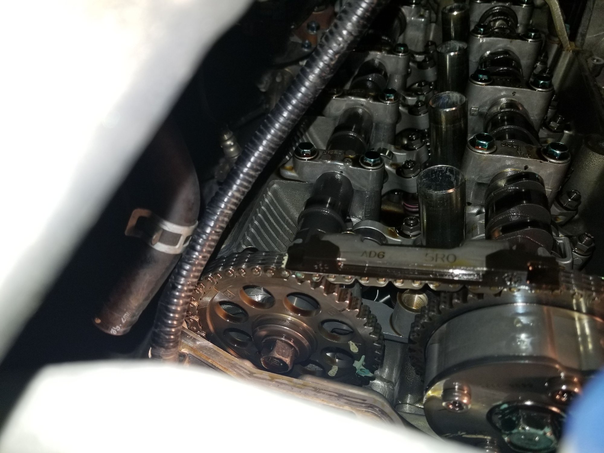

Cam gears, exhaust on left, intake on right. Markings for each cylinder are on the exhaust. Point the cylinder to straight up, and all four valves will be loose so you can measure/adjust. The "next" cylinder marking can be aligned with the surface of the head, so you can be exact (that's how I did it, please correct if I'm wrong, but it worked every time for me with me considering the passenger side cylinder as #1).
Stick an extension in here in the passenger wheel well, use a 19mm socket on the other side to turn the crank, clockwise.
Zoom in and you might be able to see the markings for a couple cylinders on the exhaust gear.
Feeler gage on an intake valve. I put in .009" made sure it got in, put in .010" made sure it wouldn't go without forcing.
Feeler gage in the exhaust side, made sure .012 would not fit in the exhaust side ".010-.011" is the tolerance I saw posted.
