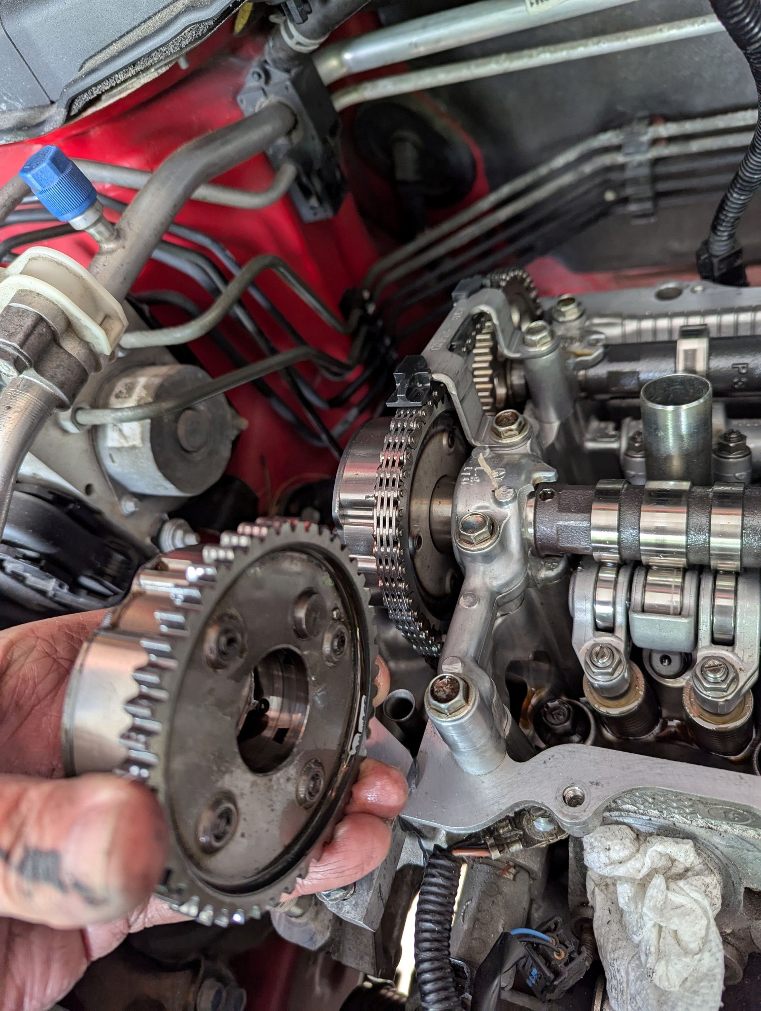

Pics from our VTC and Timing Chain replacement...
[img alt="Heres the removed VTC (Note the spring bump) and the new VTC installed along with new chain, guides, tensioner, and PVC. We installed and torqued the new VTC WITHOUT the chain installed due to not being able to unlock it. This way no torque transfers to the gear section.
"]https://cimg3.ibsrv.net/gimg/www.fitfreak.net-vbulletin/1500x2000/vtc3_f42ed4e2f32355f24b4d591feb5d76fce876abba.jpg[/img]
Here's the removed VTC (Note the spring bump) and the new VTC installed along with new chain, guides, tensioner, and PVC. We installed and torqued the new VTC WITHOUT the chain installed due to not being able to unlock it. This way no torque transfers to the gear section.
One scary thing you can see.... While I was holding the cam stationary with the big wrench on the hex section on the cam, the wrench slipped at one point. Forgot the lock pin (we used an Allen key) was still installed. When the wrench slipped, all the torque from the big torque wrench went to the lock pin and busted off the little ear on the cam cap casting. Oops. I removed the cap and polished out the breakage to remove stress risers. I think it will hold because the remaining material is roughly the same as the rest of the cap cross section.
