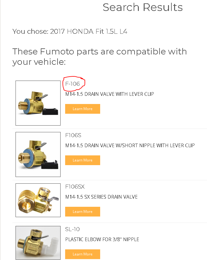

Which Fumoto?
Might you have the Fumoto part number that fits the . . . err . . . Fit? (Mine is a 2017 EX, but hopefully the same valve will fit all GKs). Looking on Amazon, it seems there are different ones e.g. F-103N, F-108N, etc.

welcome, I went ahead and looked it up for ya:
Fumoto® USA | Quick and Easy Engine Oil Drain Valves

Thank you!!
