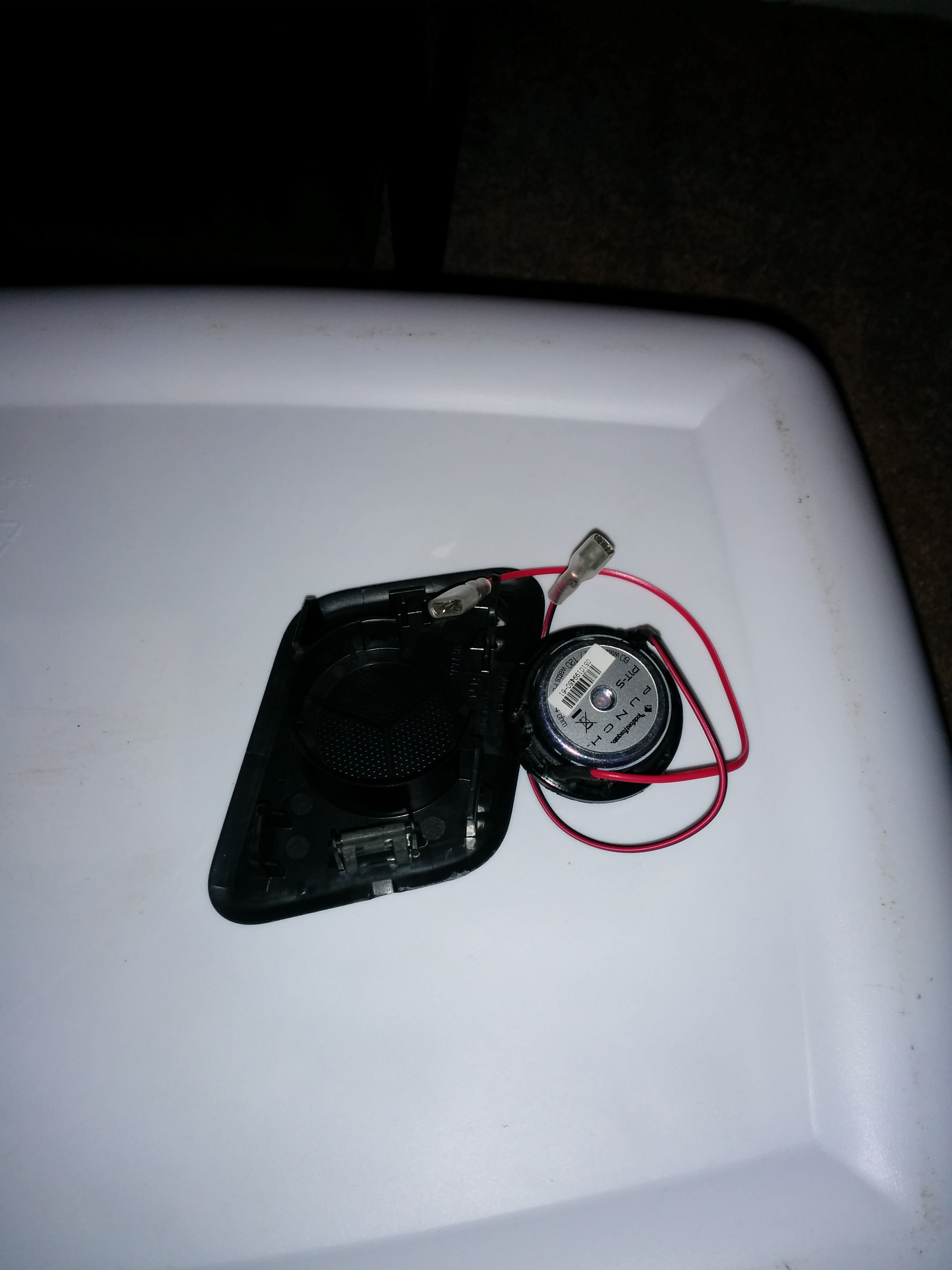

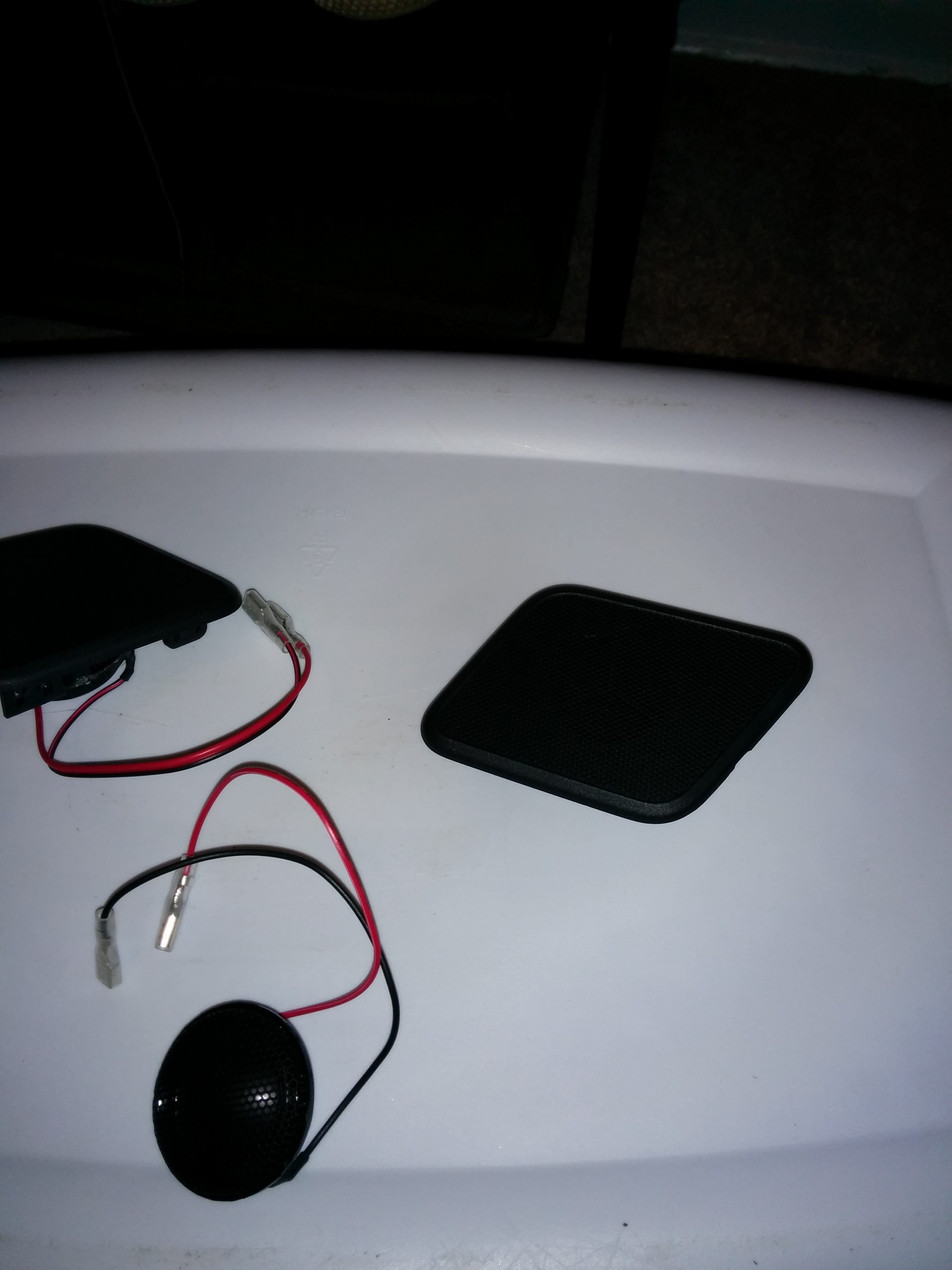

For anyone interested in adding tweeters to your system (if you have an LX or below) or just want to do a nice upgrade.
the rockfordfosgate p165-s have a nice tweeter that fits perfectly in the supplied cover to the 2015 Fit.
here are some pics
the front grille removed
backside of both
one fits in the other perfectly
A simple glue or plastic weld could get it done, or if yer fancy a bracket to the grille holes. Just thought I'd share as they are such a snug fit.

That does look like an awesome and simple way to essentially turn the LX's speakers into the EX's. I assume/hope the tweeter wiring is already there? Does the stock head unit have an integrated crossover? How does the EX handle its tweeters? Is it possible to add plain old tweeters without an integrated crossover? (And leave the stock door speakers.) Are the EX door speakers identical to the LX?
The tweeter wiring is not there in the Canadian LX model which kinda sucks. basically you have to buy some replacement front speakers or a crossover and tweeter package.
the rockford fosgate 6.5" component speakers come with a built in crossover in the 6.5 " that comes with wiring for the 1" tweeter, and they cost about what you'd pay for a crossover and tweeter separately.
The HU doesn't include wiring for tweeter but there is certainly spots in the connections to add tweeter wires if you were so inclined. but you'd need to cross reference on an EX model to find out where they would connect.
sorry i can't help further, but i don't have an EX to compare with.
- moltar
