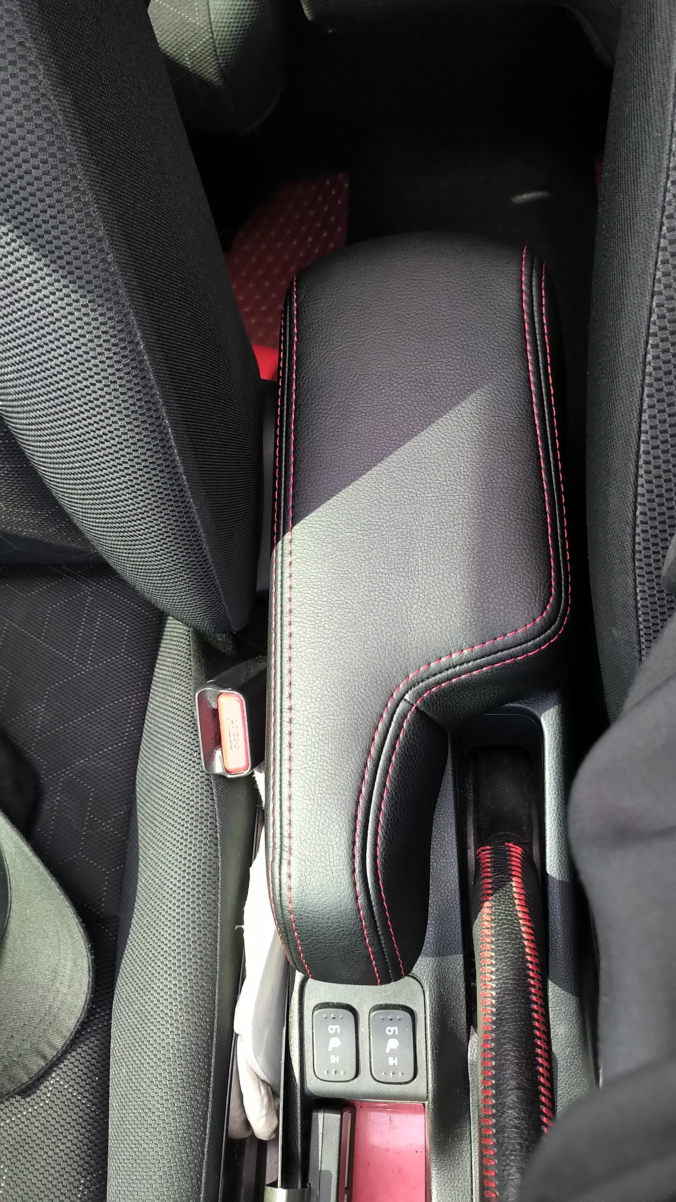

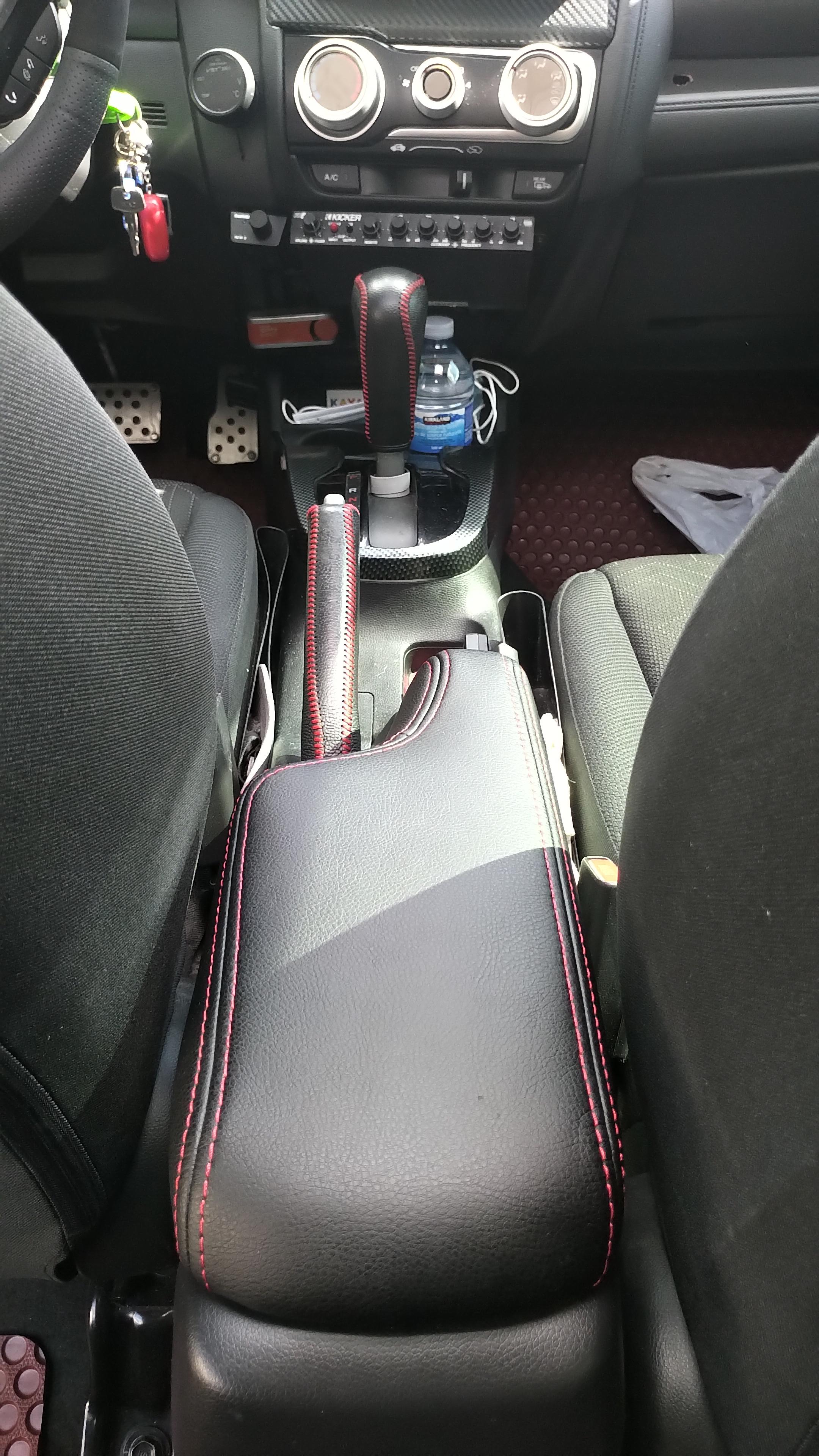

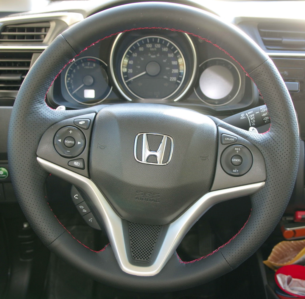

So here is my original mod. I'm very happy with this and am impressed with the quality and durability of it.
Then I saw that the manufacturer made another model that I couldn't pass up:

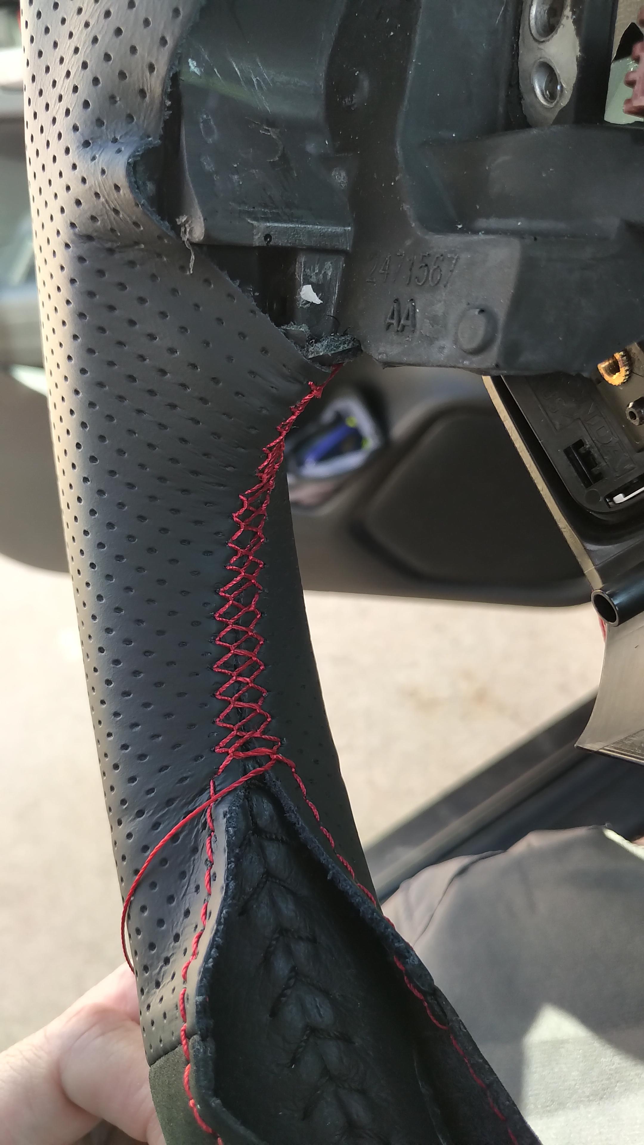

https://www.aliexpress.com/item/4000...5a6c4c4dQesjcA

That steering wheel cover looks awesome. I did a Wheelskins and it came out OK. A bit sloppy around the spokes
Thanks for your how to post

Thanks for the compliment!

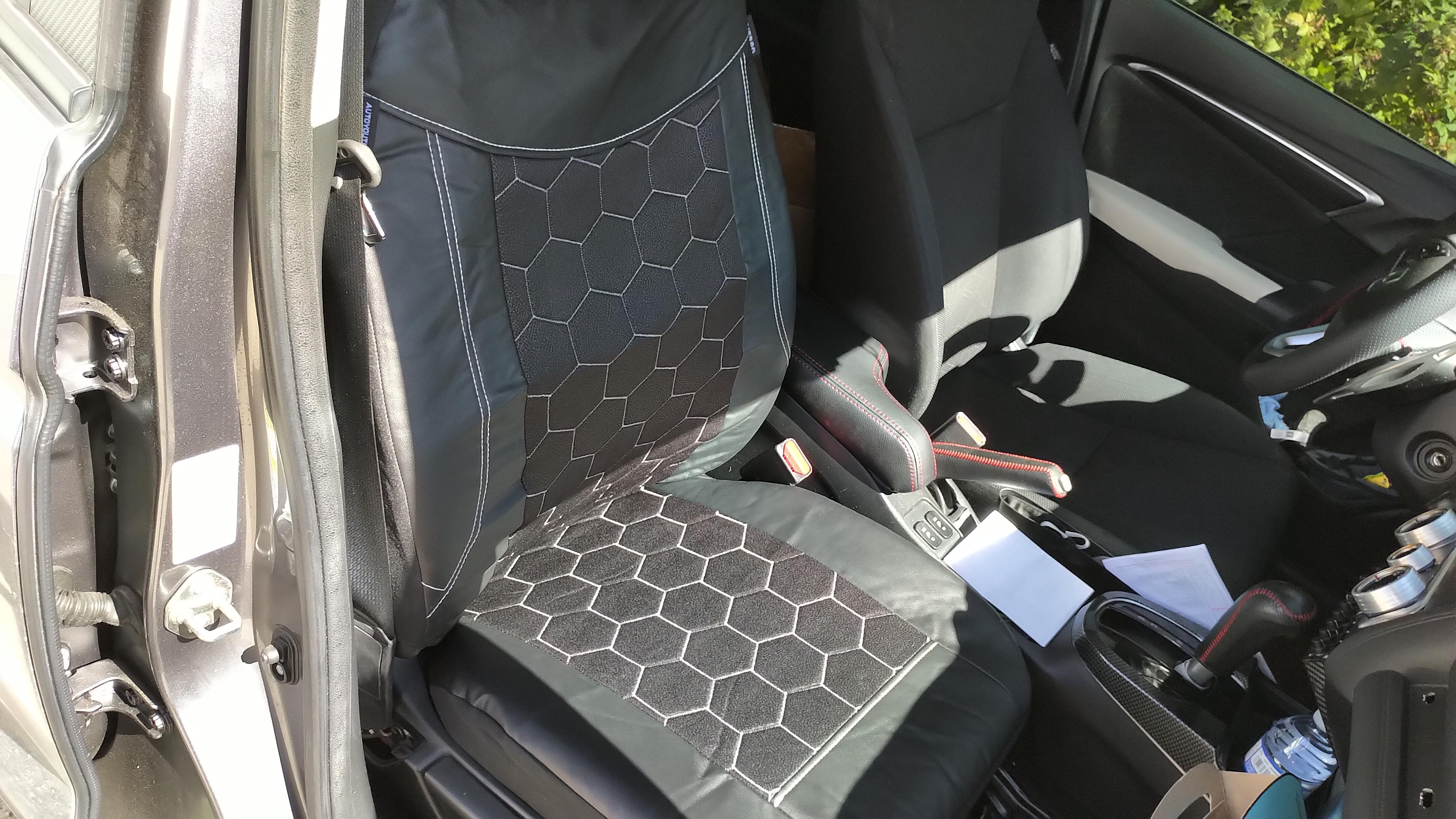

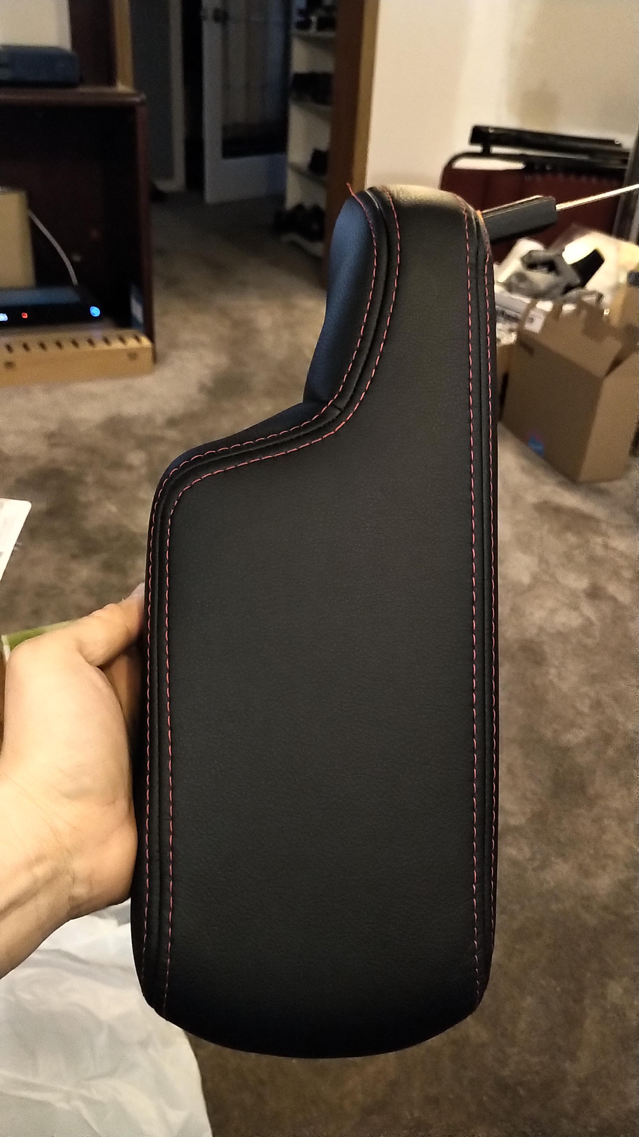

Generic front seat covers. Headrests don't fit (1 inch too short). This is good enough to cover up the salt+water stains that I can't remove.

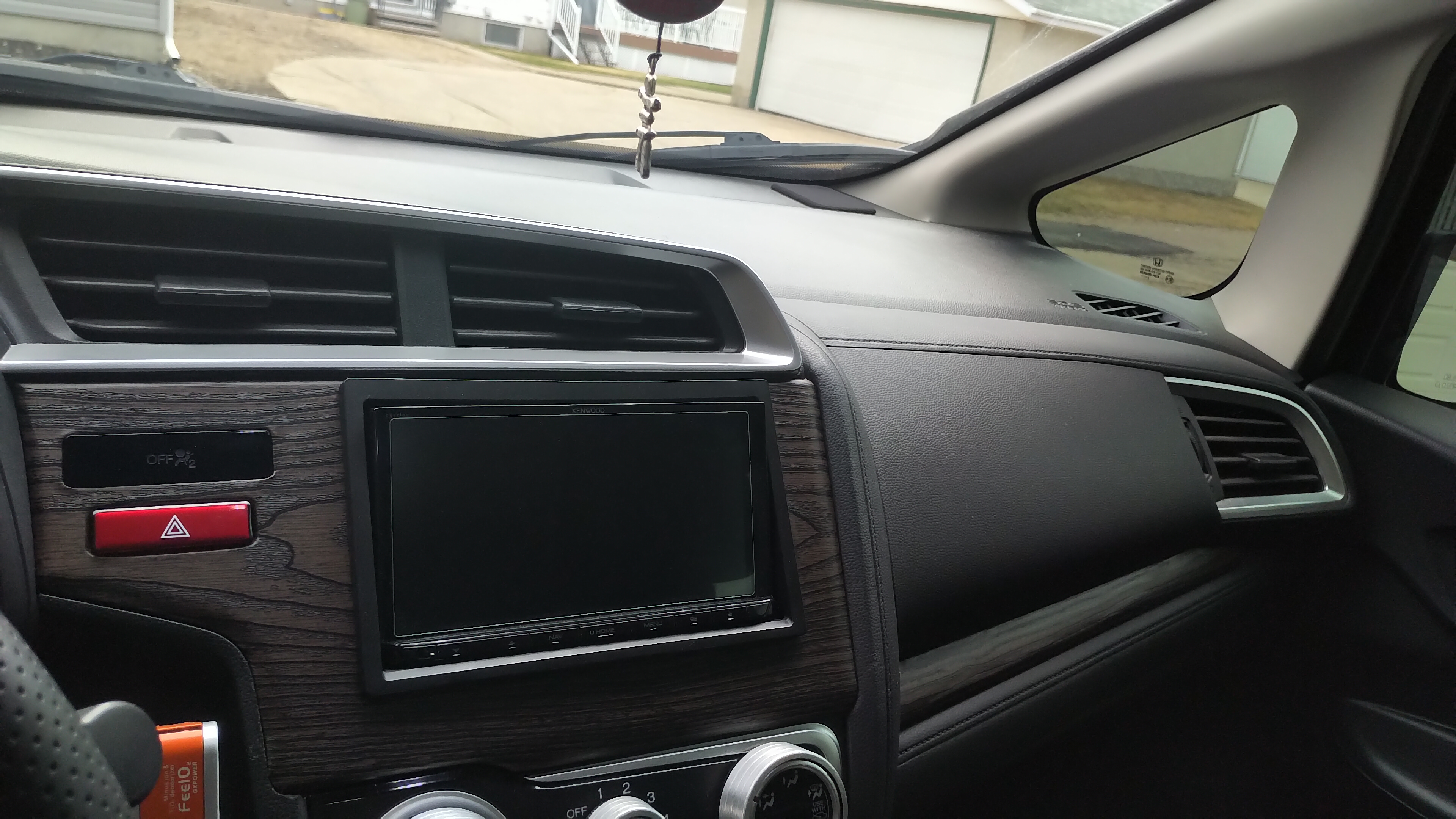

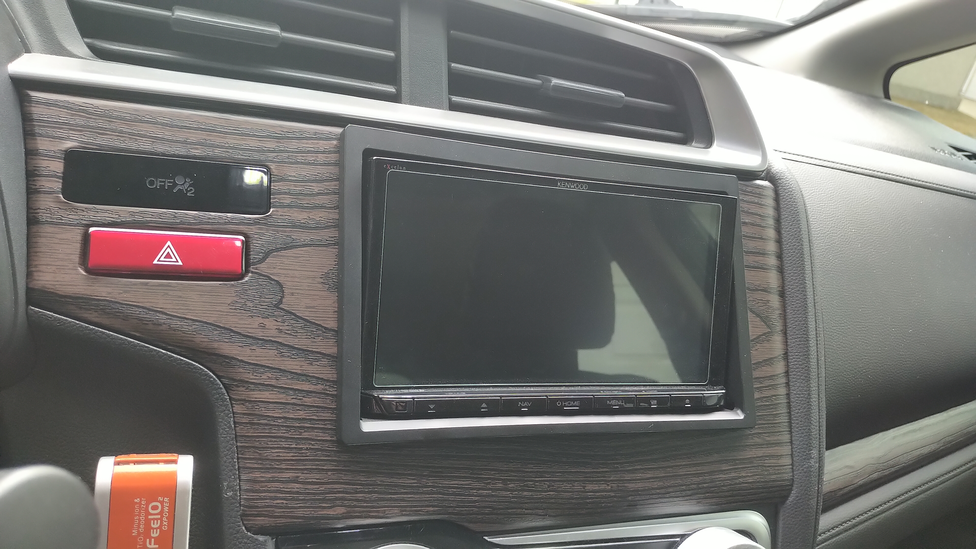

Fake textured wood wrap!

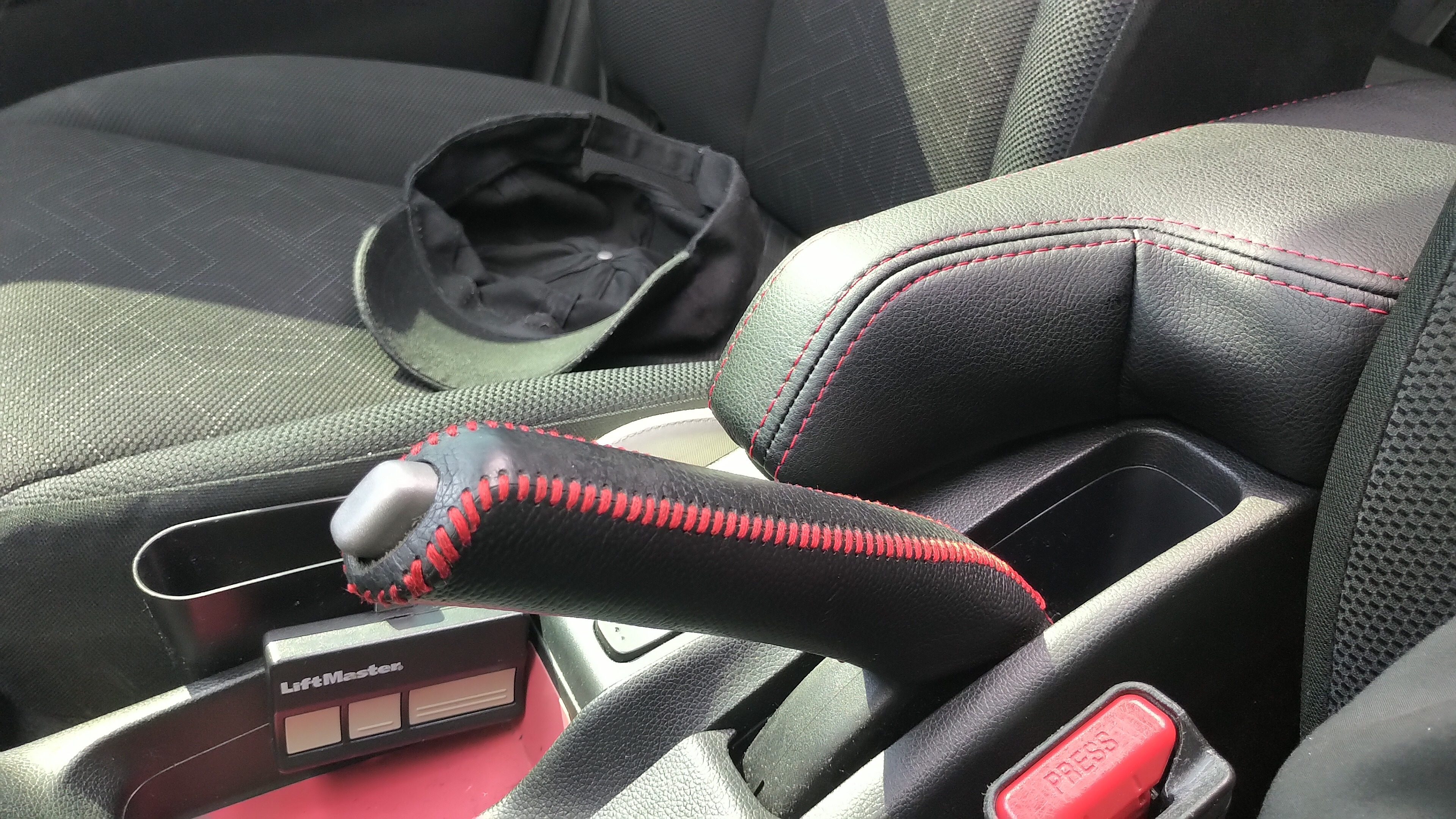

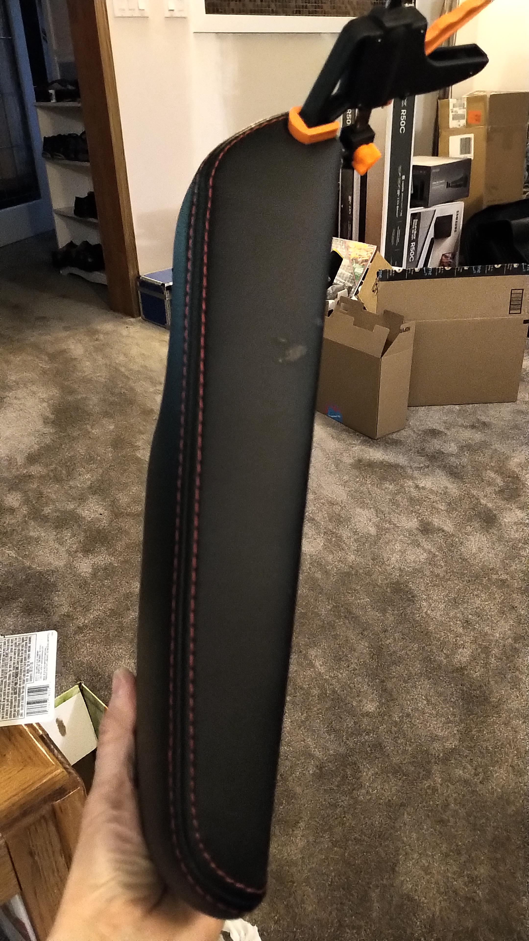

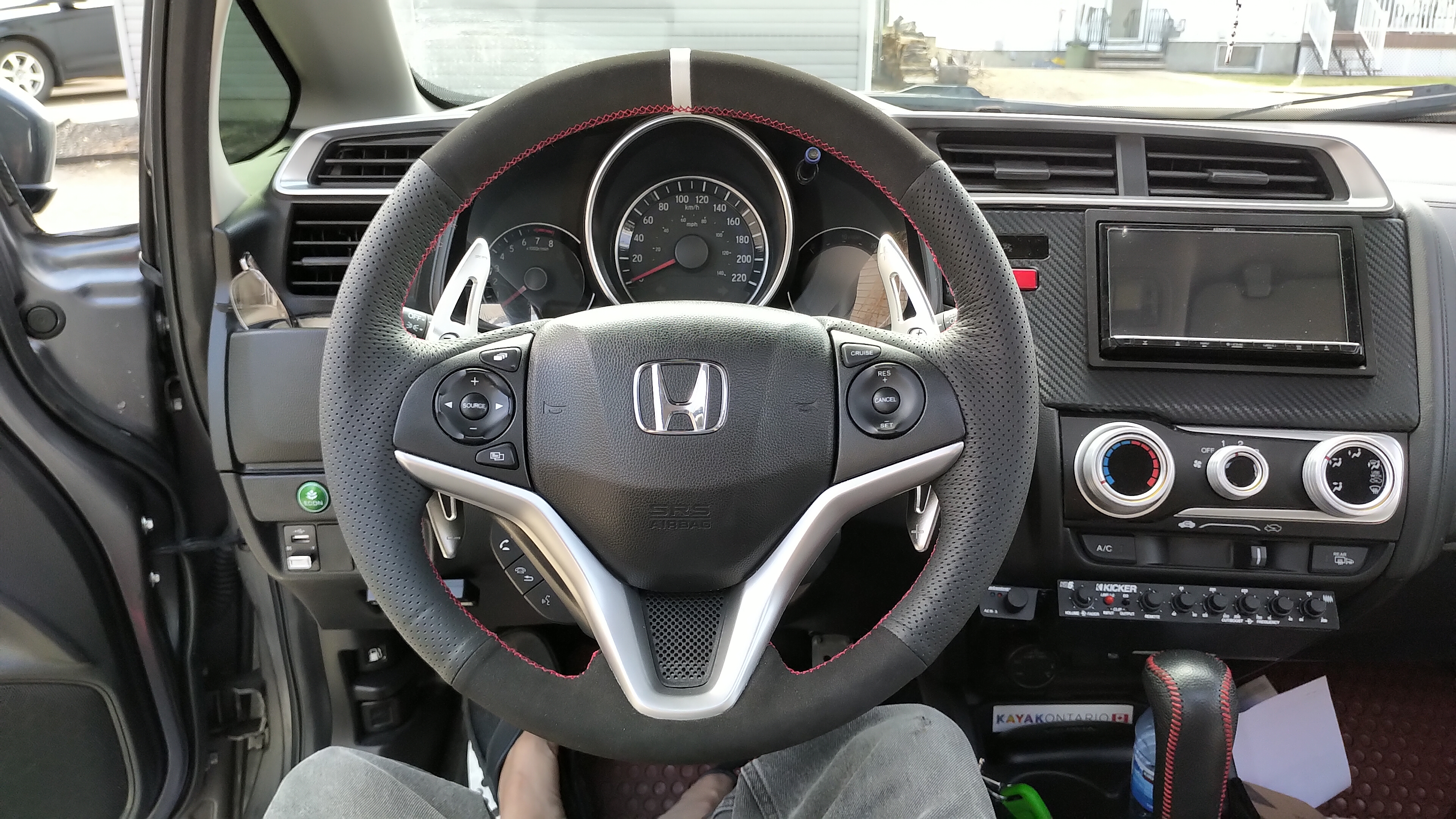

Coffee colored suede. Red and White markers. Yellow stitching and 0.5mm upgraded yellow string used to hopefully avoid fraying.

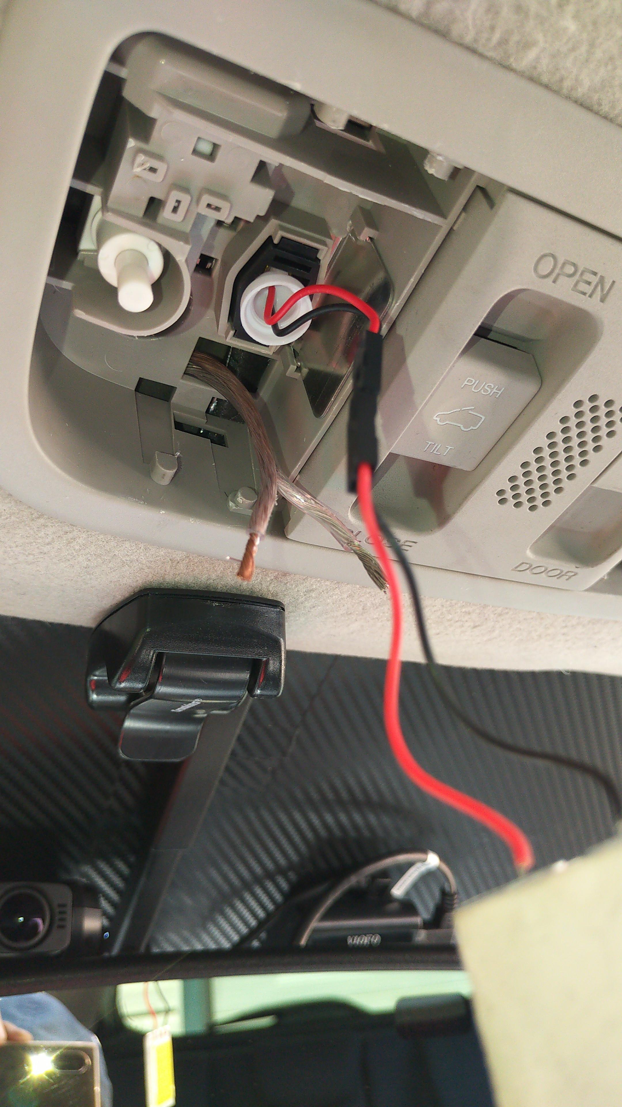

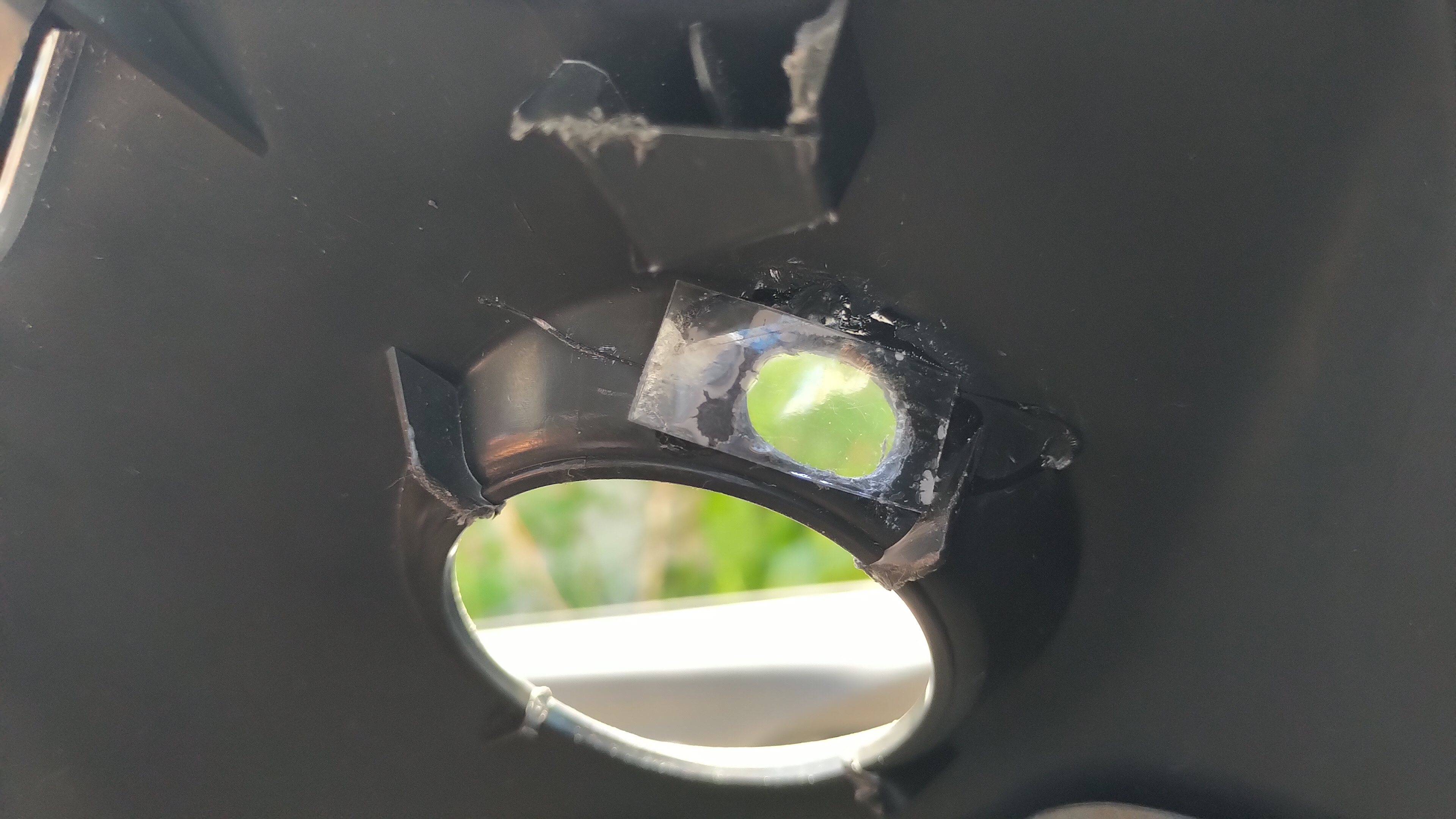

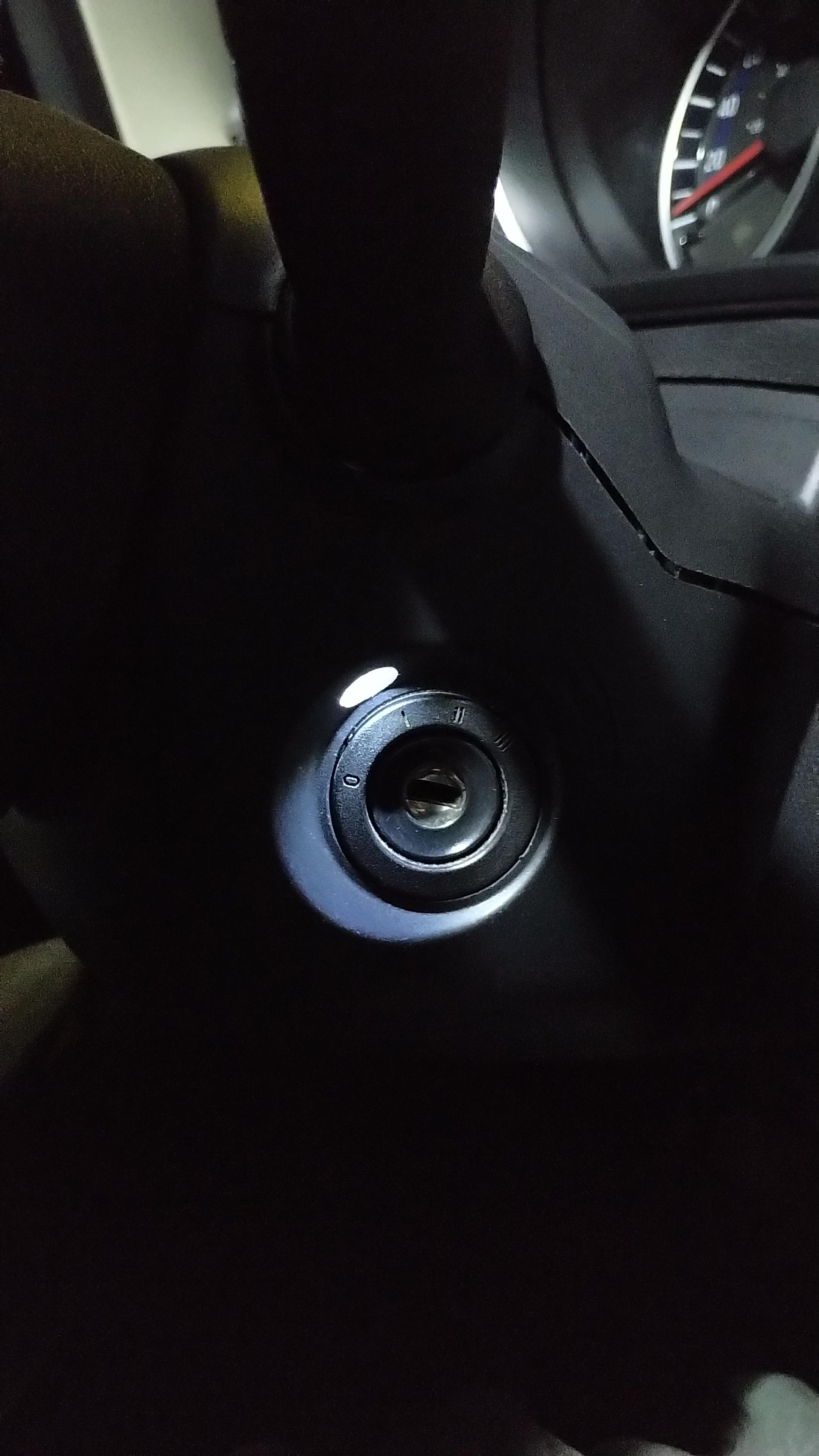

Lighted ignition.
Borrowing power from interior LED light.
