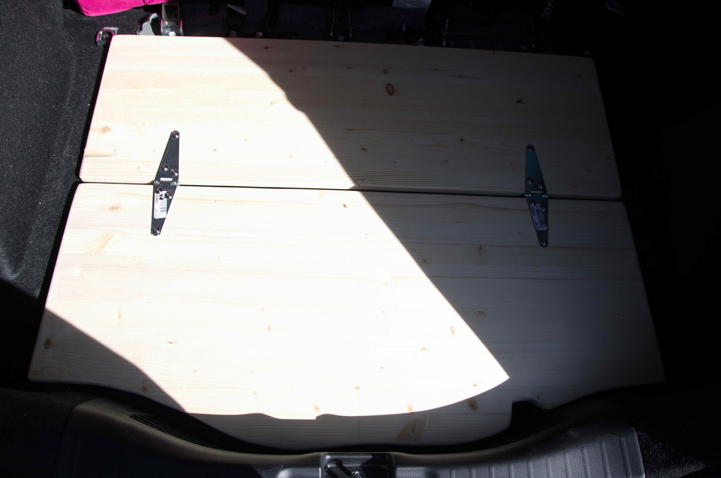

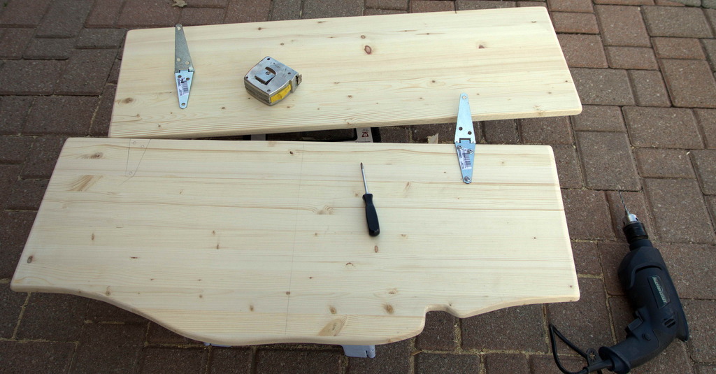

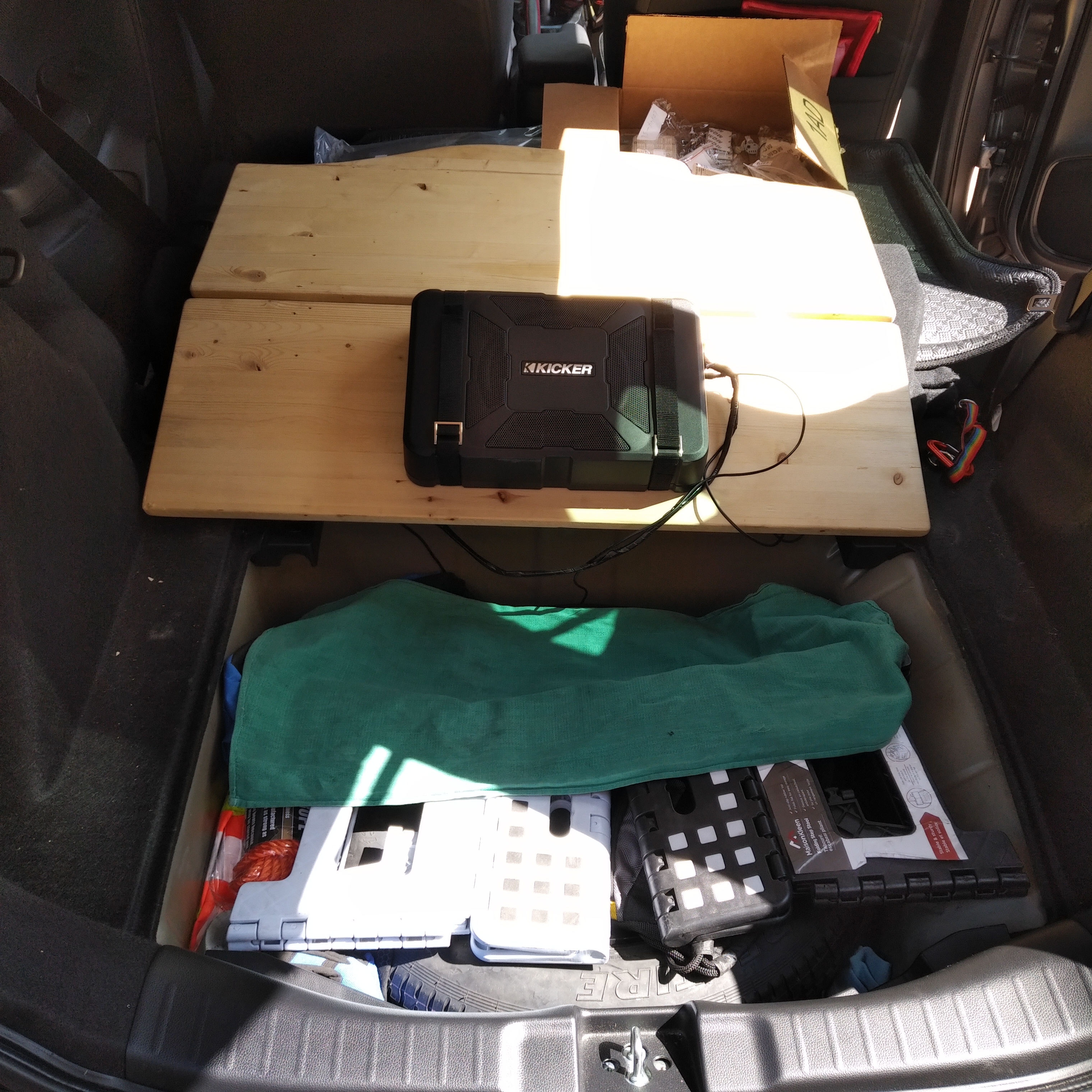

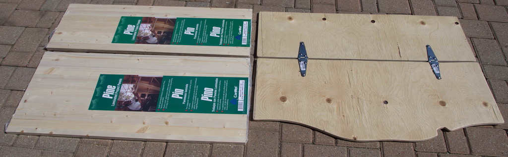

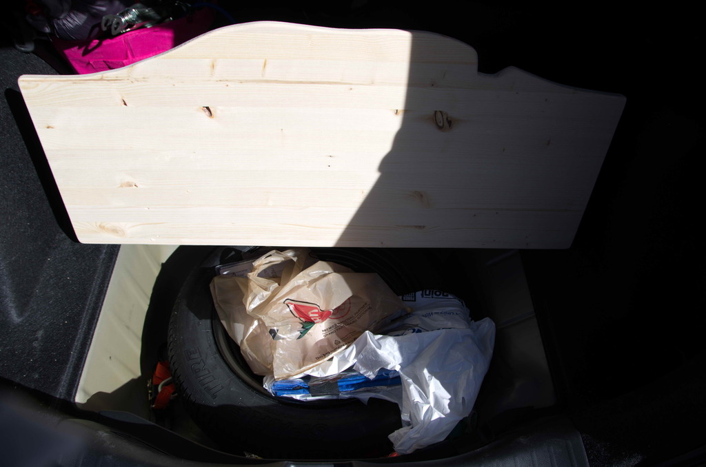

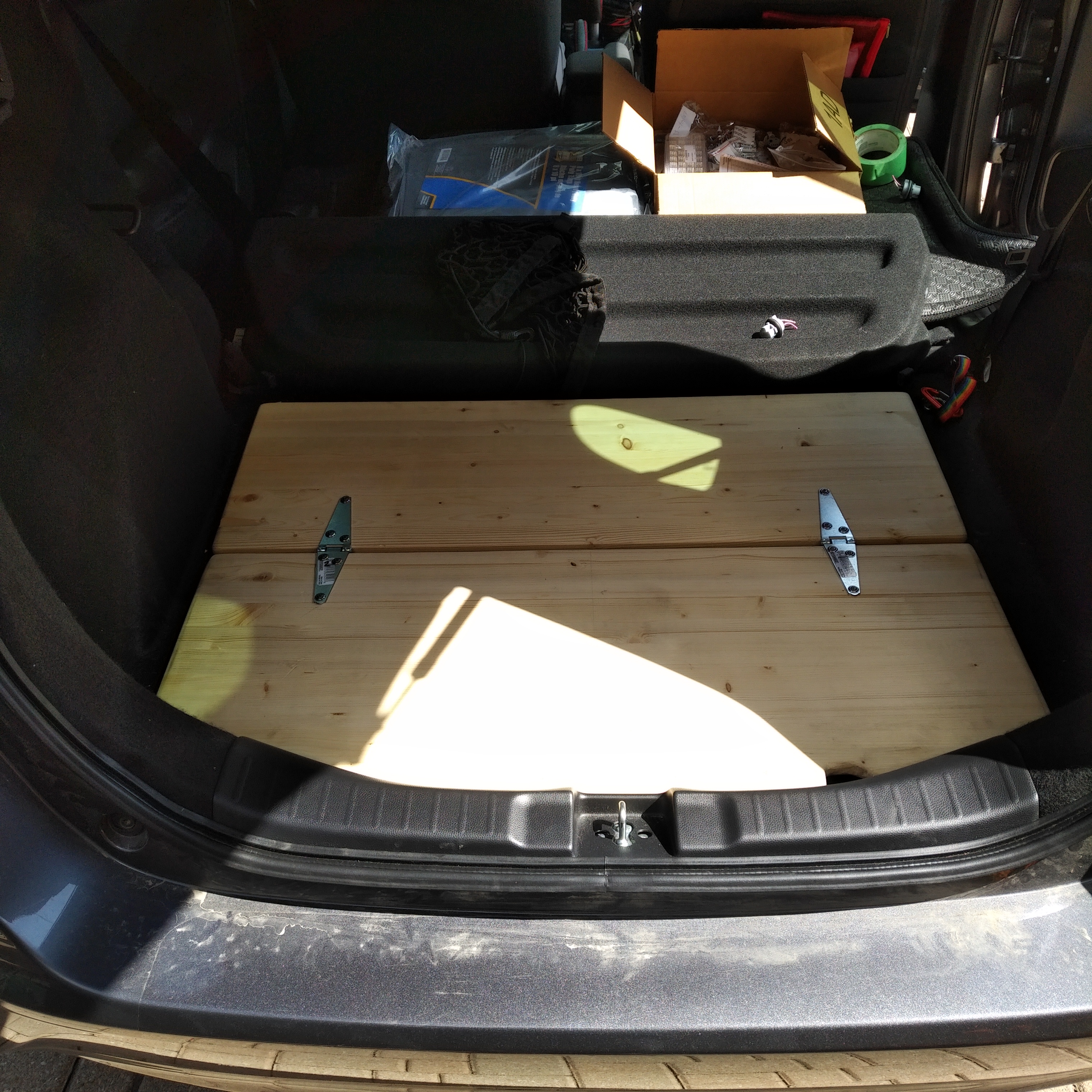

So I wasn't happy with the flimsiness of the first one. 2Rismo2, it was originally 1/2" thick.
I apologize for some fuzzy pics. I left my camera on manual focus.
ALL materials from Home Depot Canada. Bag from Princess Auto.
The original one was 38" wide. The trunk is just about 39" wide. This new board is 36" wide. There's no issues. It's actually better as it's easier to remove from the trunk.
This wood is 3/4" and STIFF. I sat on it in the trunk, and there was zero flex.
With these boards, there's minimum cutting, and I rounded out the corners and edges with a handsander.

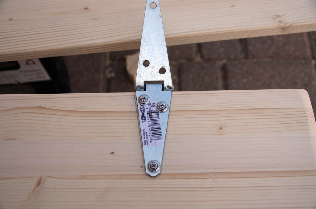

This is a 4" Heavy Strap Hinge. Heavy so it offers resistance, and it holds the board up. I used Trim Finishing screws as they are self tapping (I still drilled pilot holes) and everything sits pretty flat.
New boards fitment.

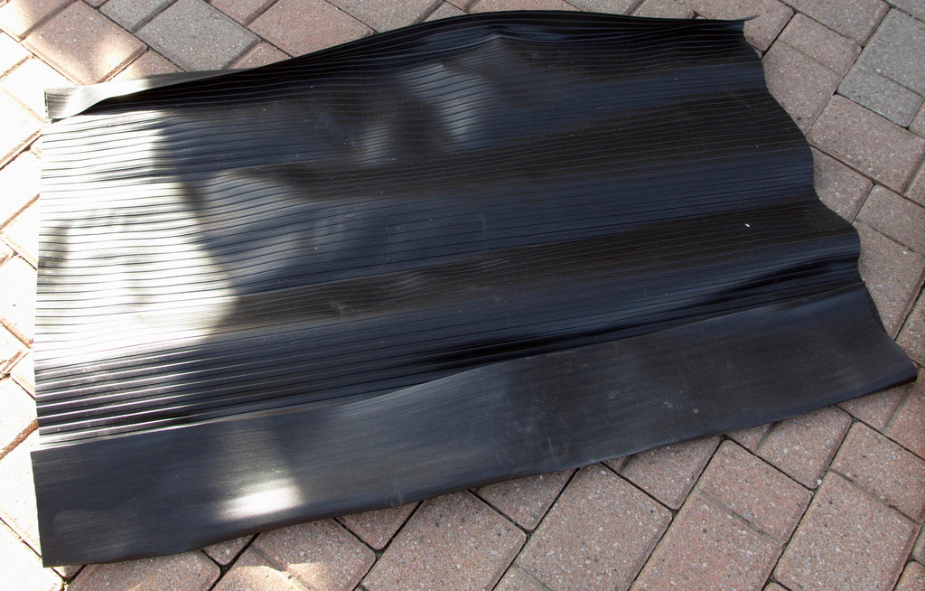

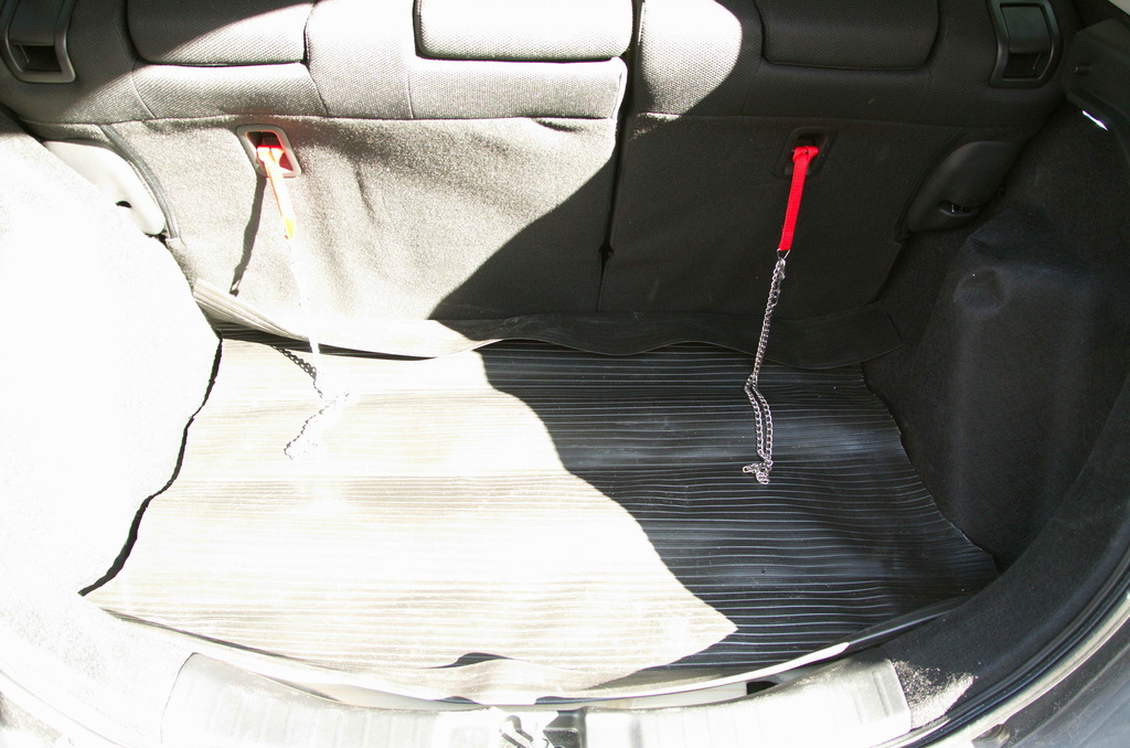

Trimming off some excess off this vinyl roll gives me a "mat" to roll up that I've used when working on the ground. The jack kit fits into a Princess Auto 14" bag perfectly.
There you have it. I am now enjoying the extra space in the spare tire well, which frees up more space in the actual trunk. There is no interference with the cargo cover. I'm happy and the 2nd time around only took a few hours.
You can use this for a stealth sub setup. I might stick my powered sub in here once it arrives.
If you really want, you can build a 2 tier setup. I believe the JDM GE Jazz might have this option.

Bear Knuckles, as you can now see, my sub doesn't intrude into the passenger compartment. There's still plenty of space in my "new trunk".

Thanks for showing that! So the sub is stored inward towards the spare?
Old Apr 23, 2016 | 05:34 PM
Action Jackson's Avatar
Joined: Oct 2015
Posts: 1,366
From: Ontario, CANADA
It's under the new trunk "floor", and it sorta hovers over the spare.

They're self powered subs (amp and sub built into single unit). My first away from traditional separate setup. There are also shallow mount subs, so that it can go in small boxes or the spare tire.

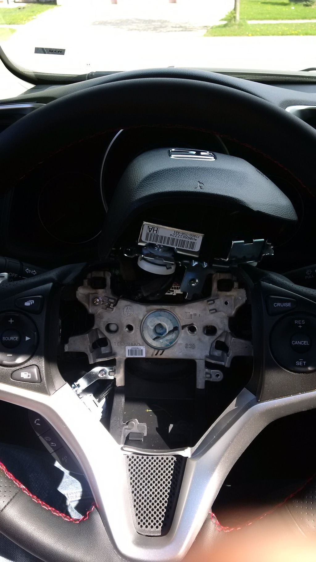

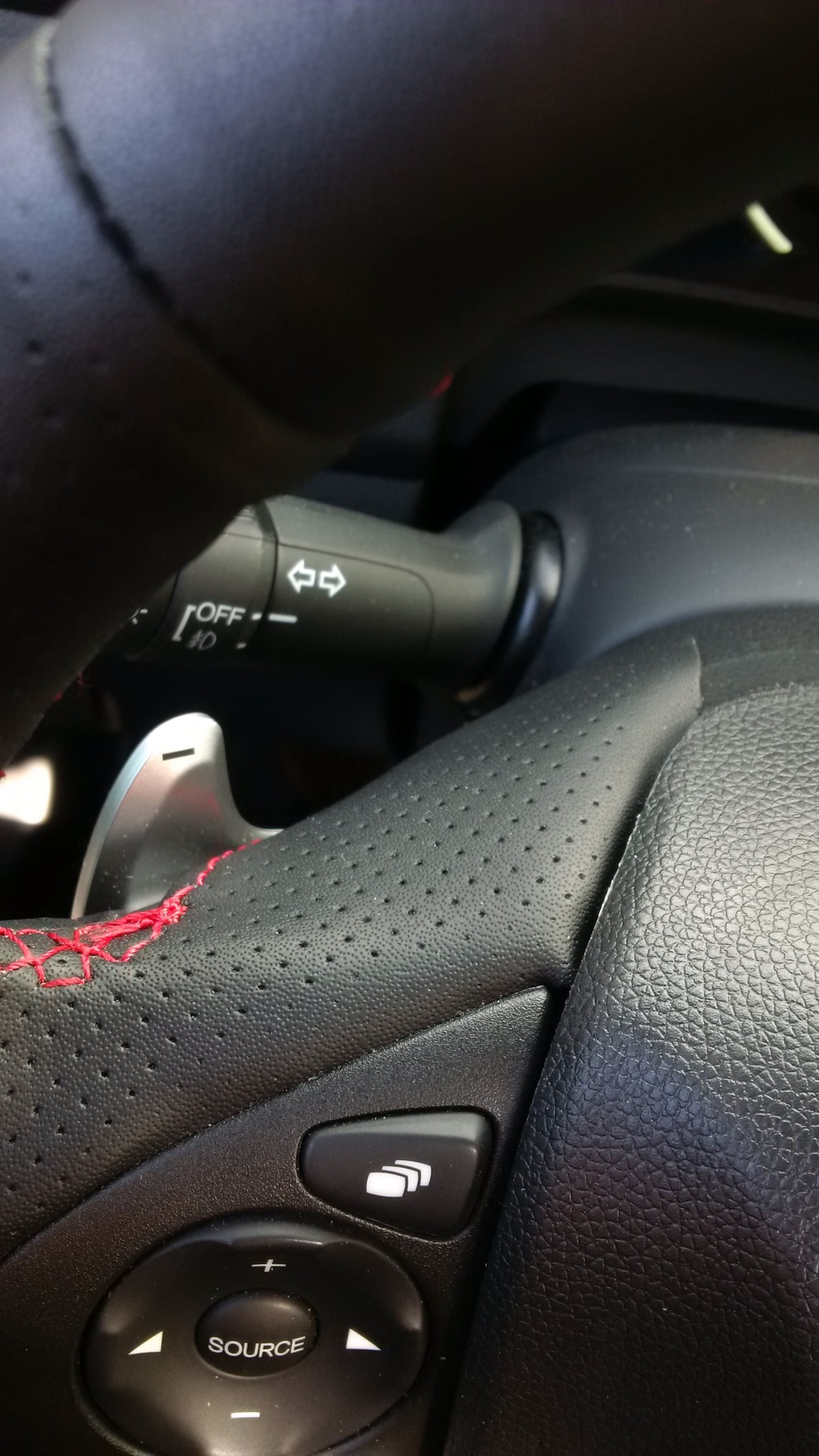

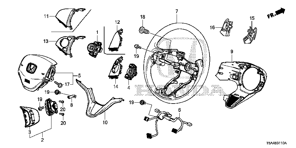

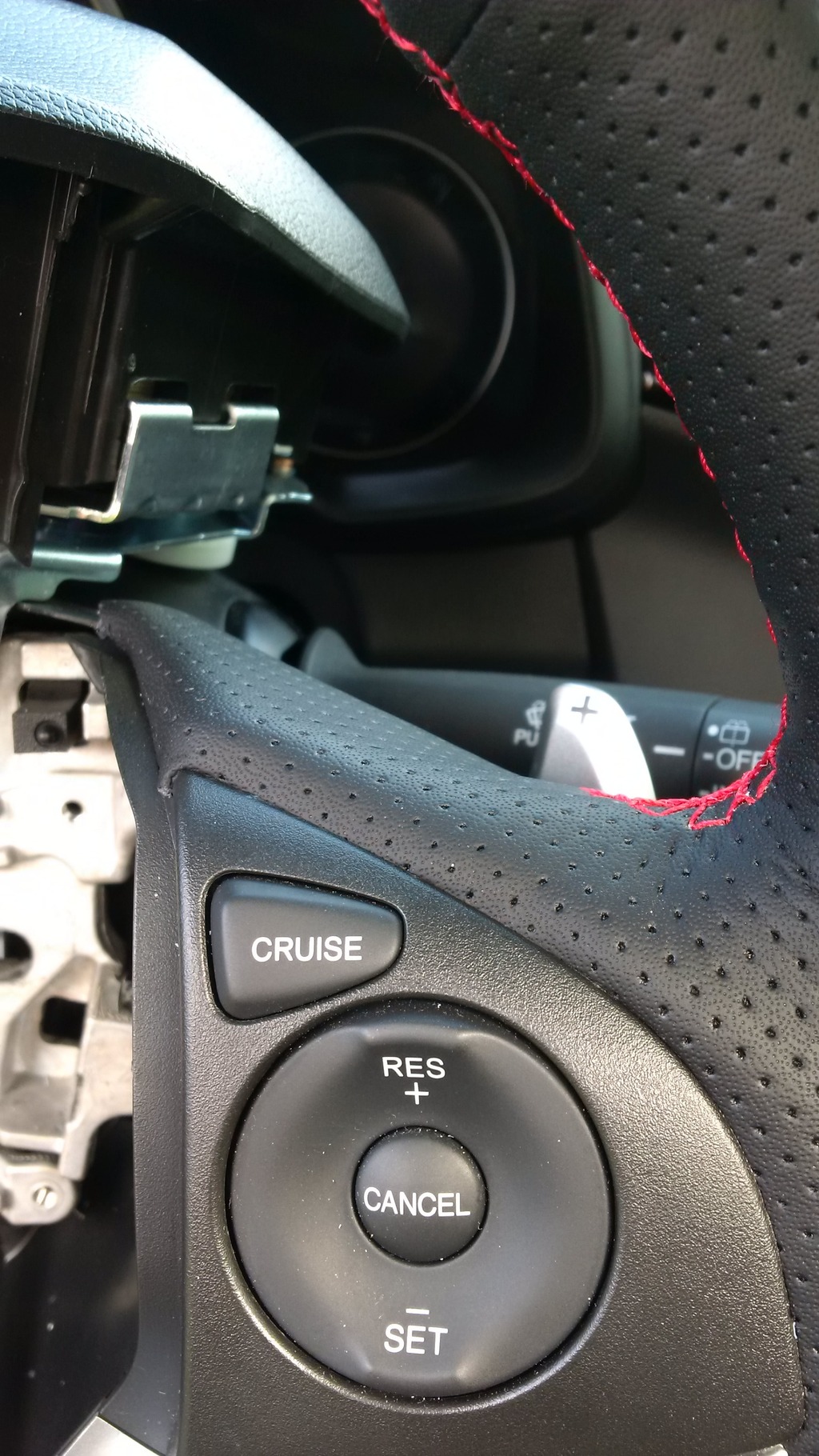

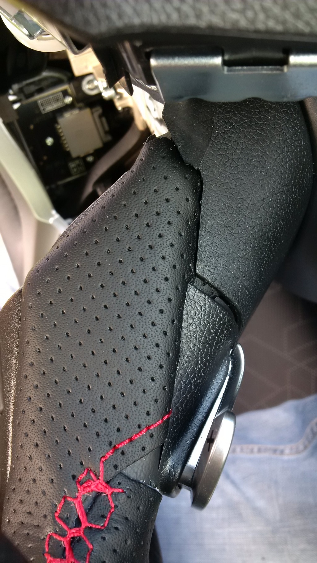

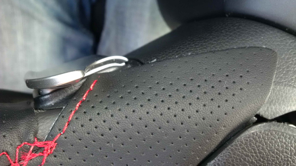

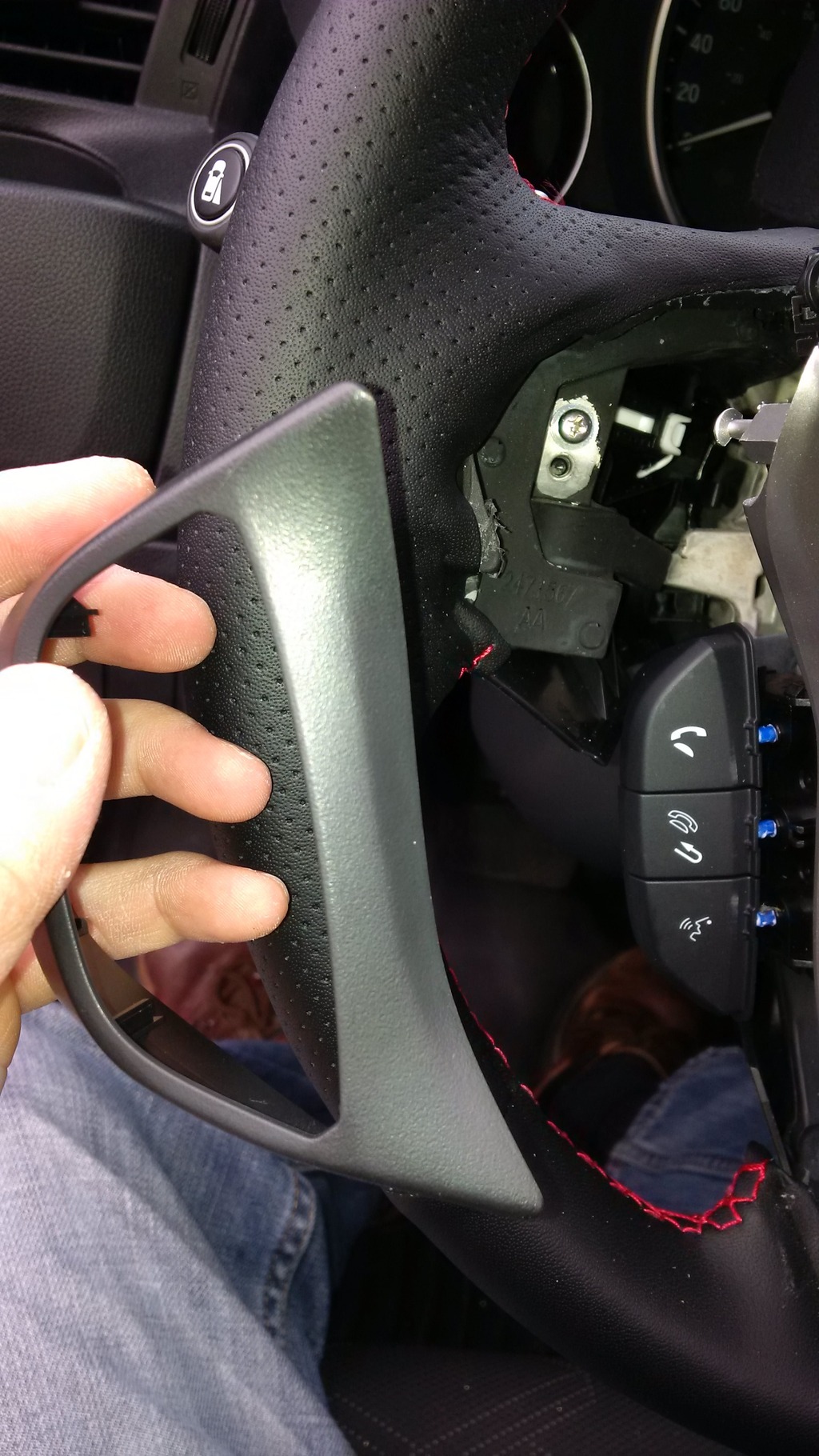

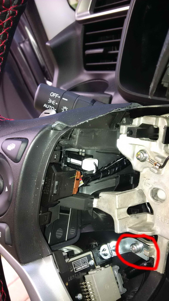

Finished "tucking in" the top/back part of the steering wheel wrap.
Again used Stembridge's steering wheel removal as a guide:
https://www.fitfreak.net/forums/3rd-...ml#post1330251
and a Honda schematic:
I previously left this piece taped to the steering wheel:

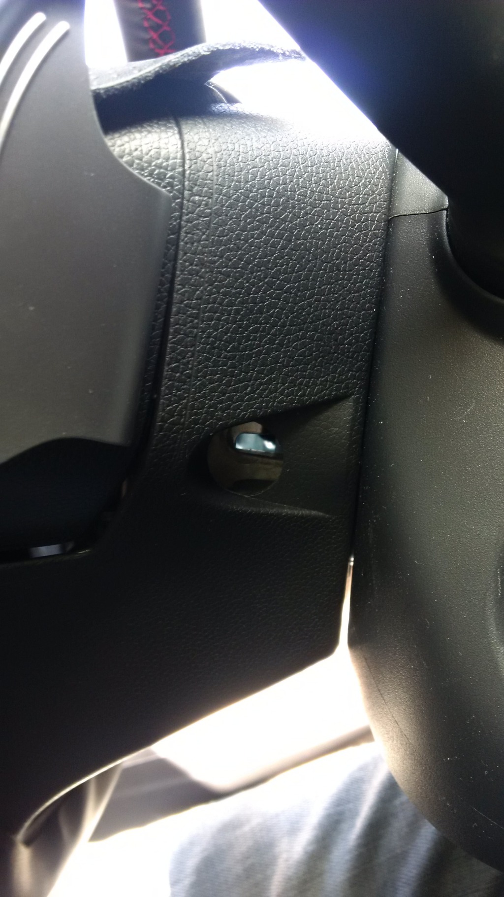

It helps to remove the airbag. There are 2 screws, one behind each paddle shifter. Pic shows screw removed:
And I just flip it up while still connected. WARNING, just because the airbag didn't go off in my car, doesn't mean that I will be the same for you. So disconnect the battery!

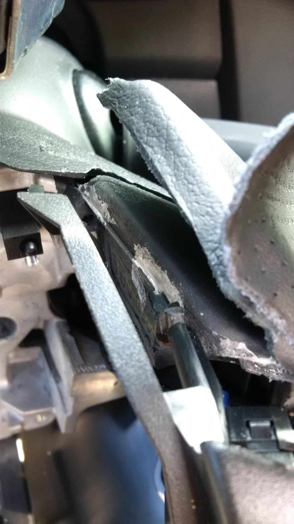

You'll need to pull the trim straight back. I did not remove it completely, just pulled back a bit:

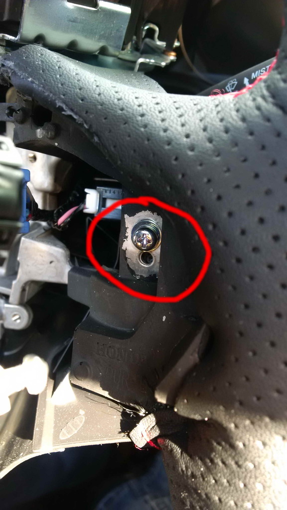

Undo this screw, which loosens up the corresponding panel on the back. There's also a similar screw on the left side:
And with some fiddling, you'll open up enough of a gap in the back to tuck in the wrap:
Align the front first before you do the back part:
If you're lucky, you won't pull the OEM leather wrap away from the steering wheel:

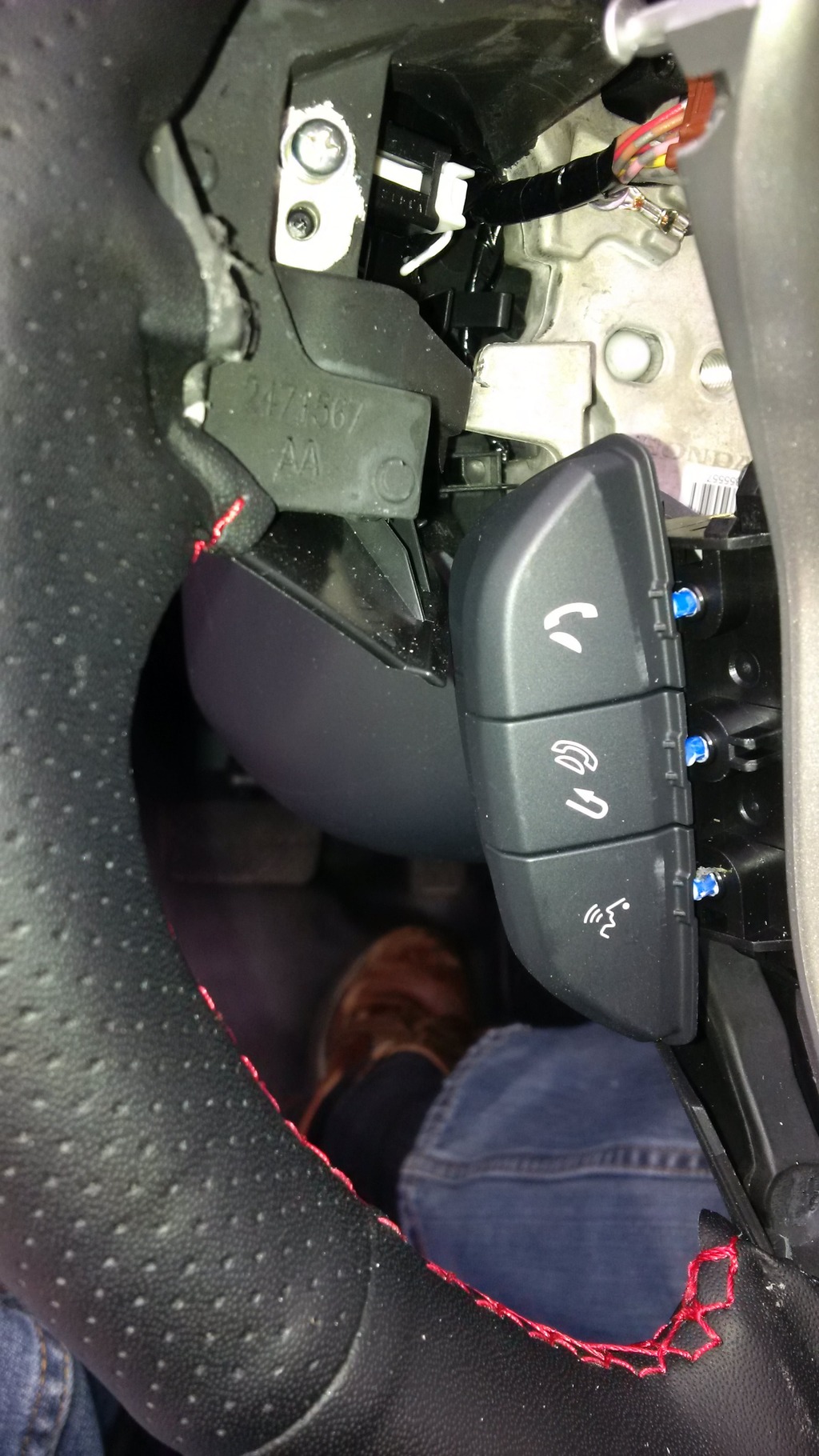

The left side is a littler harder. You have to undo this screw to loosen the phone controls:
I don't know what happened, but this protective sleeve popped off. But it's actually easier to work around with this off:
That's really it.

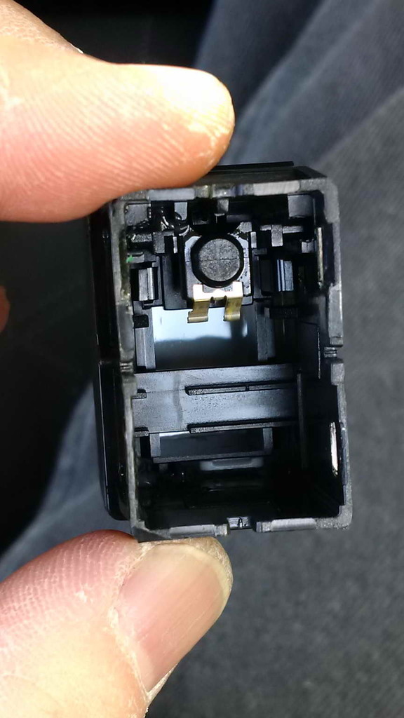

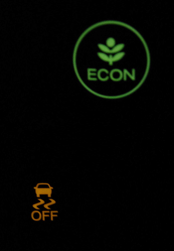

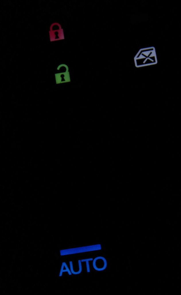

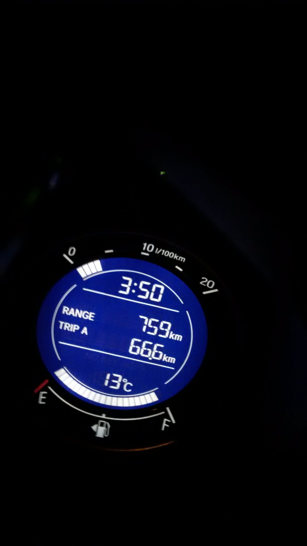

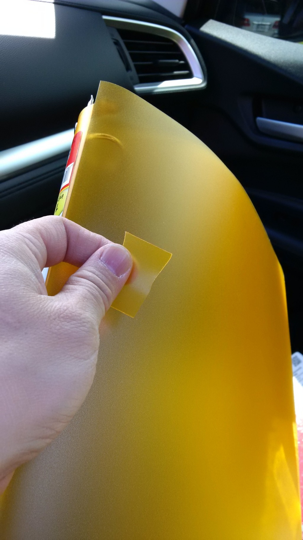

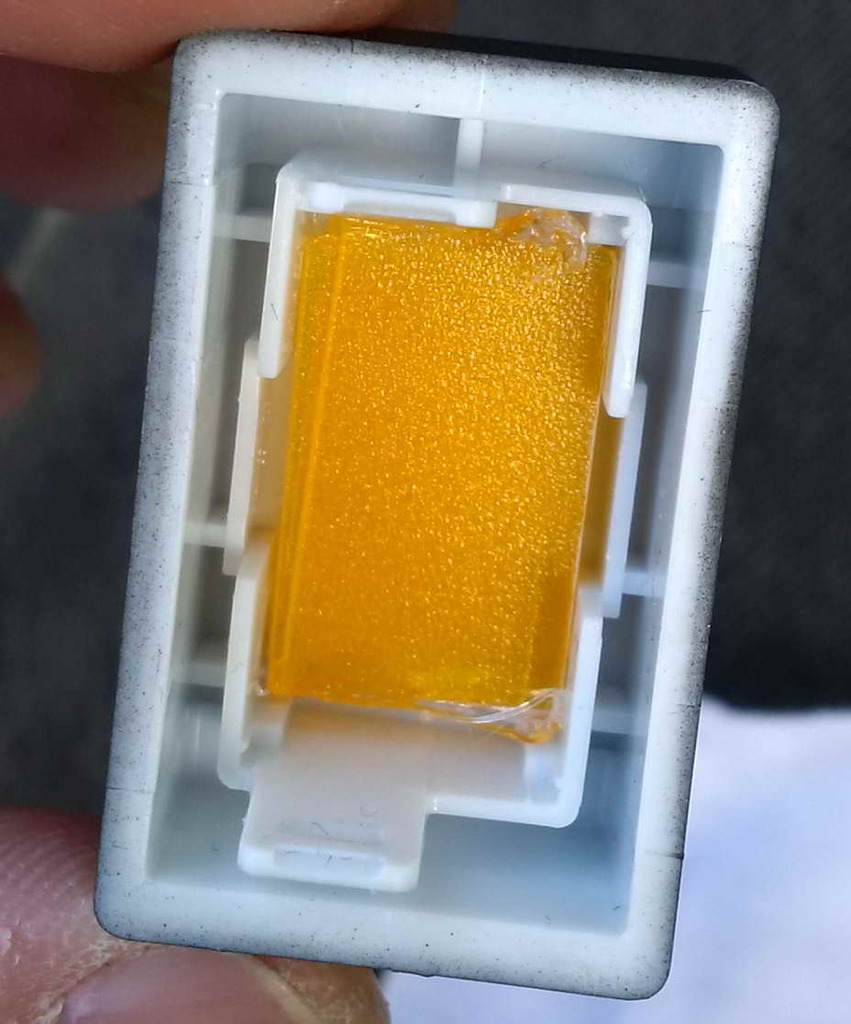

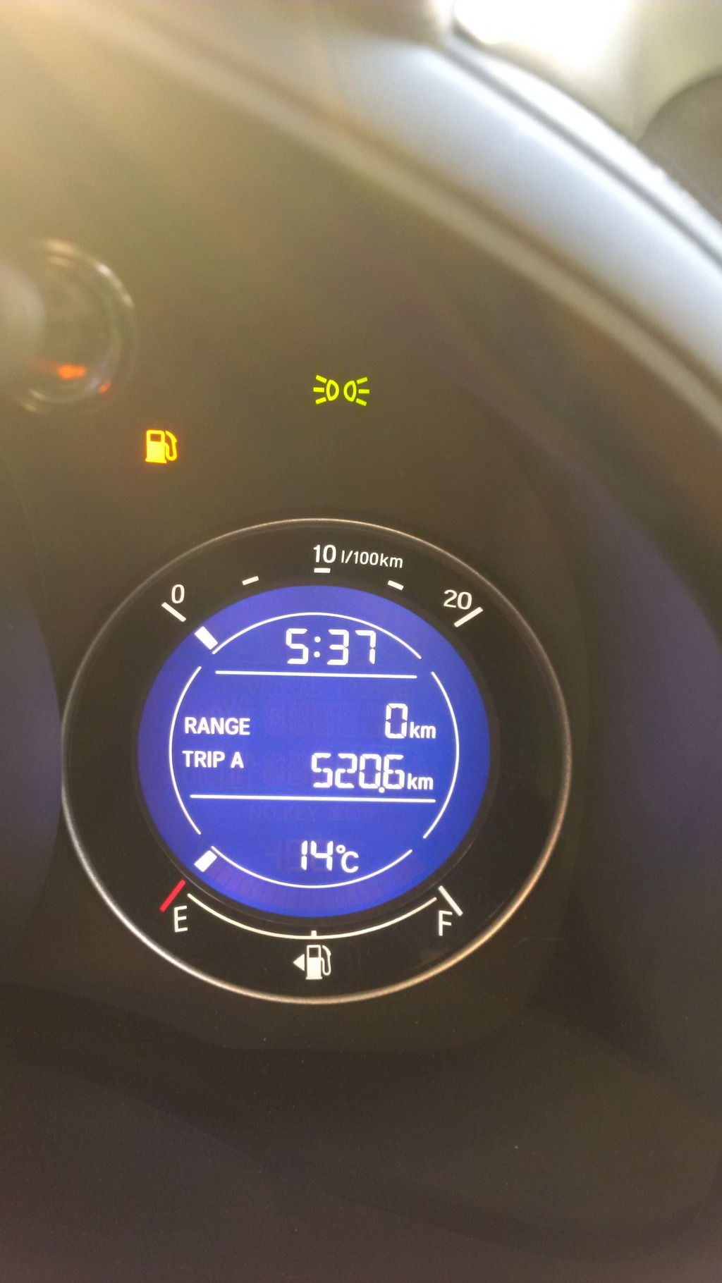

why didn't the orange color come out in the low setting?

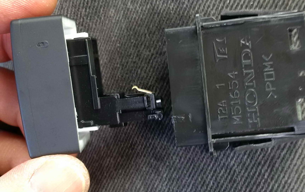

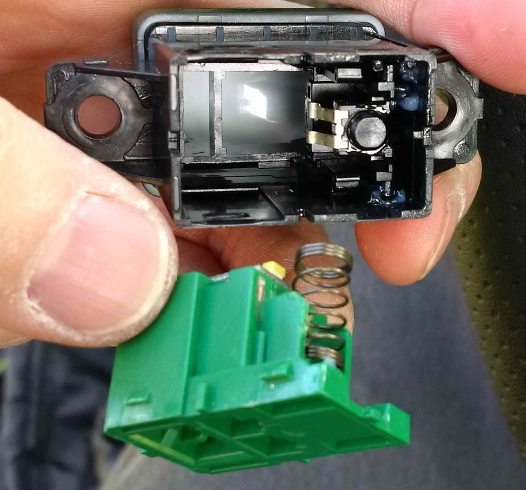

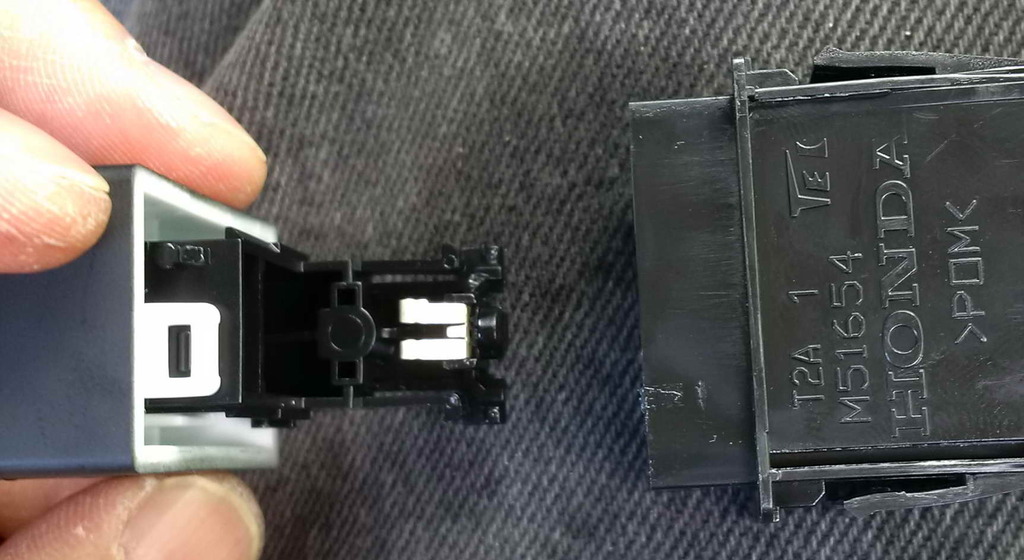

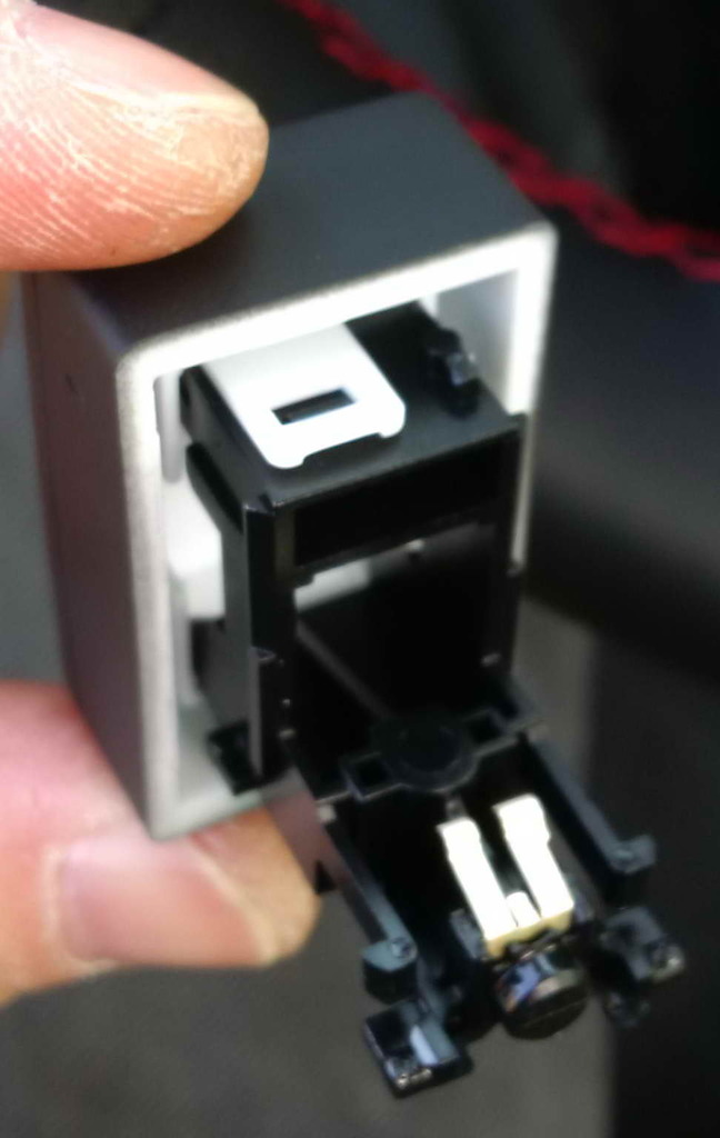

VSA button:
A bit of clear Shoe-Goo:
ECO Button:

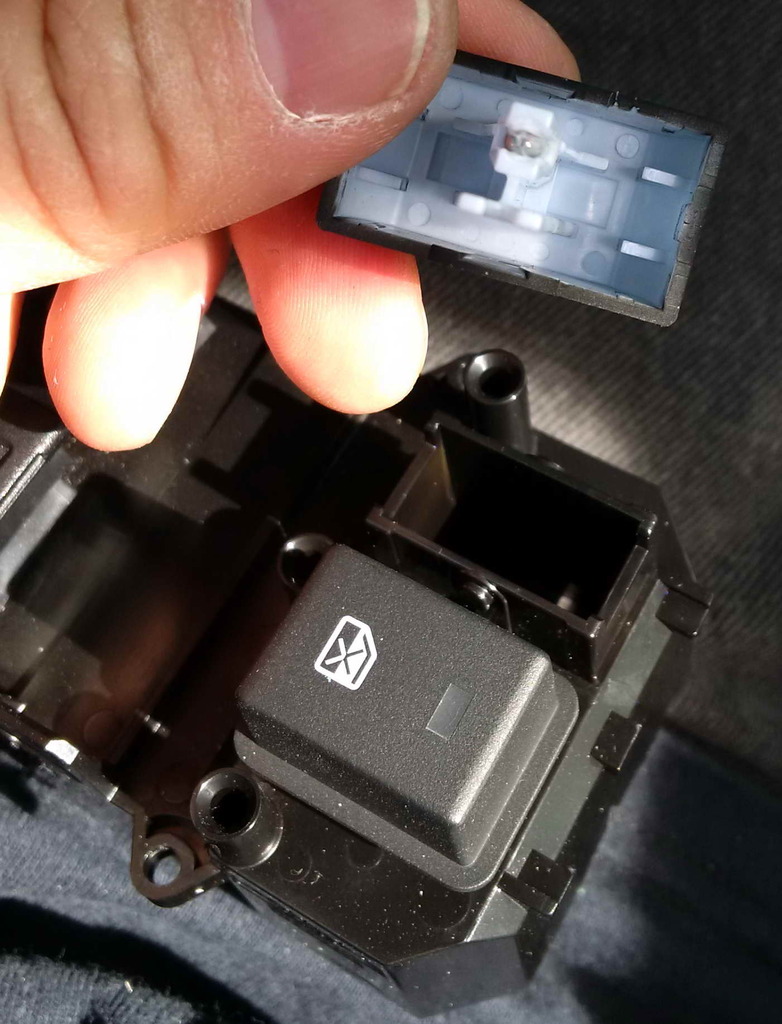

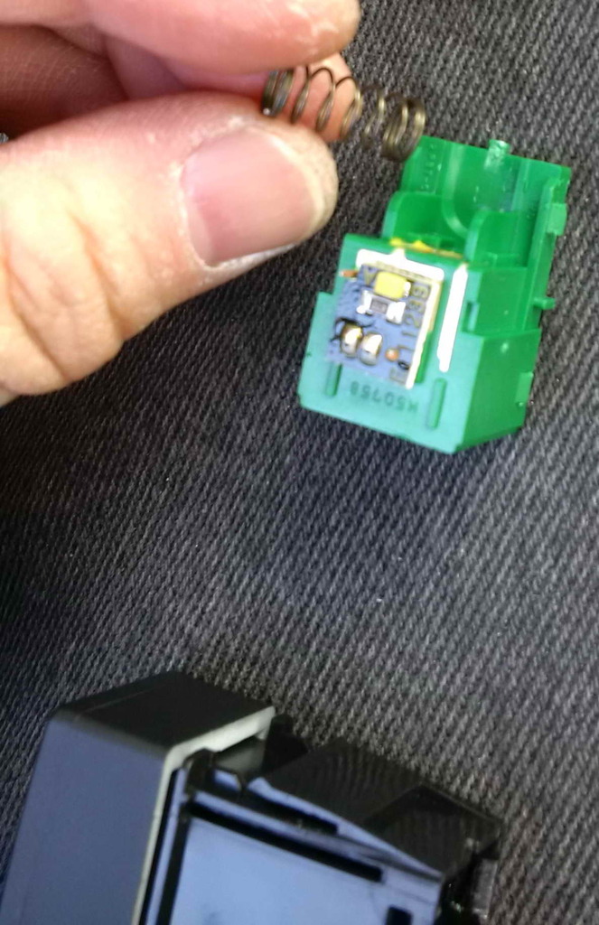

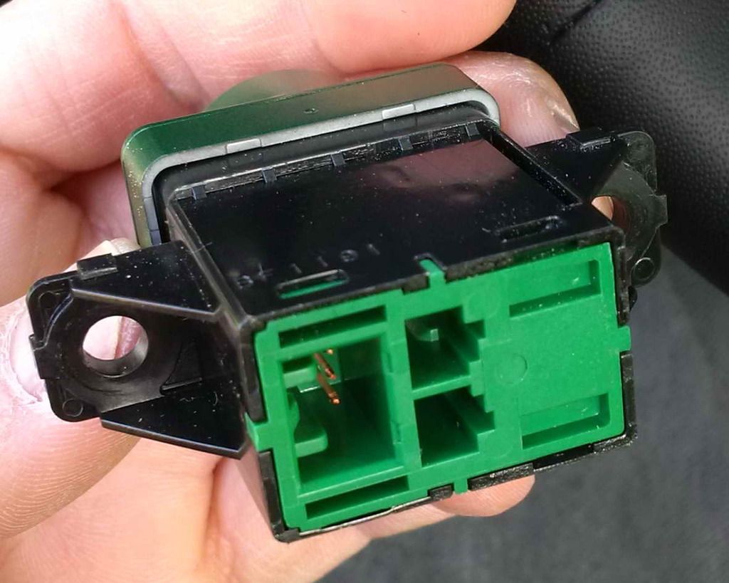

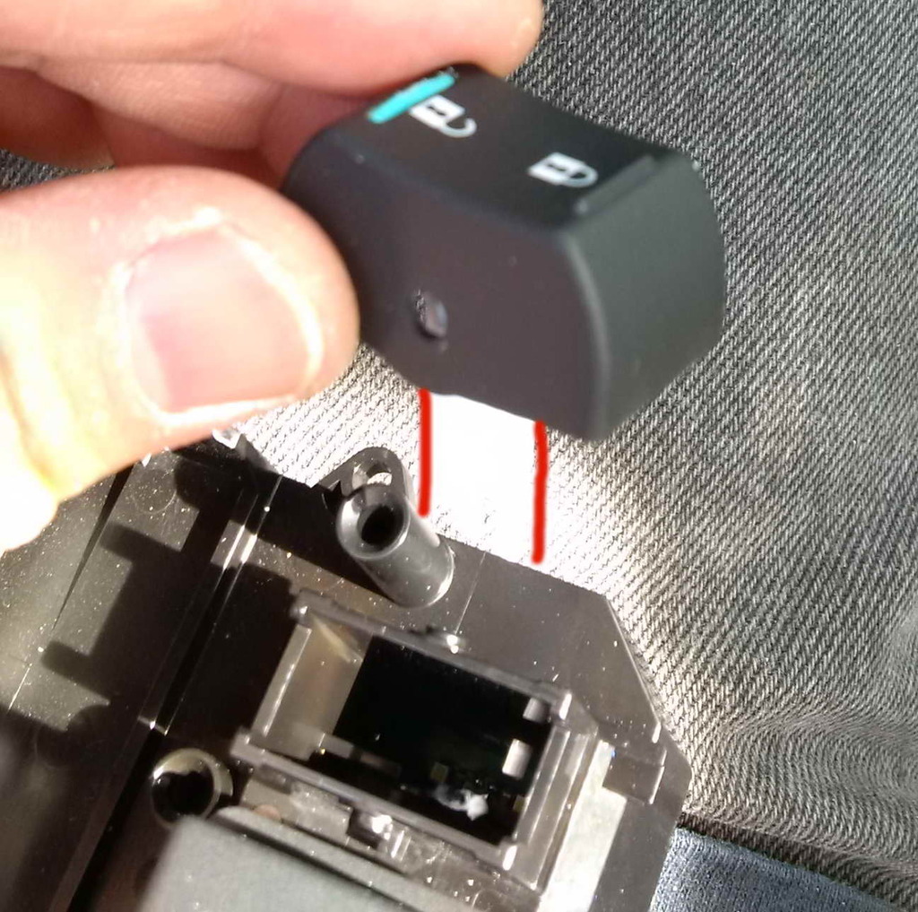

Power Door Lock Button. I added small green strip. Red lines show plastic part of switch. Looks like a 'T':
Be careful. You can easily break things.

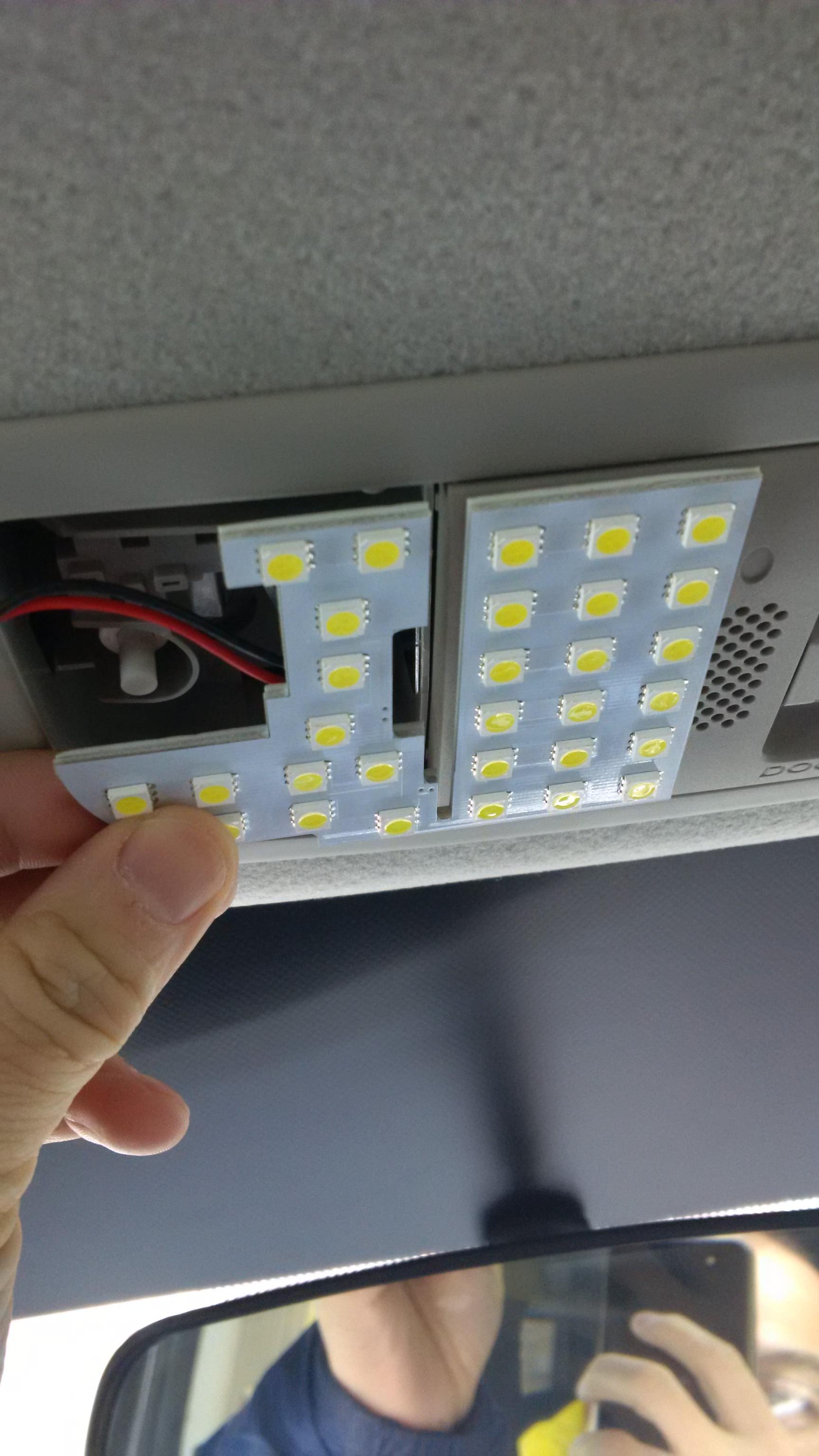

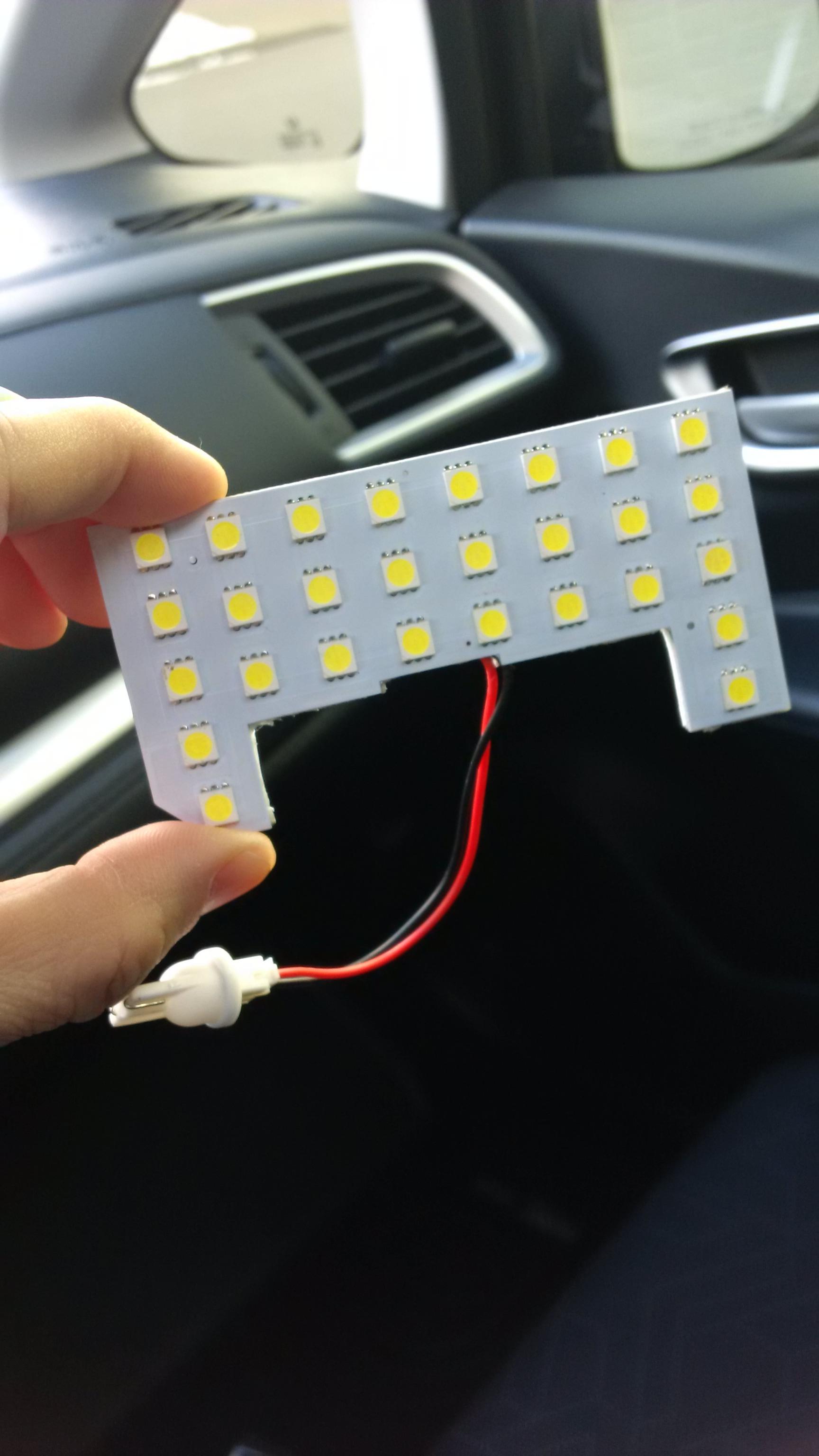

Believe it or not, the last 2 pics are for the JDM LED's.

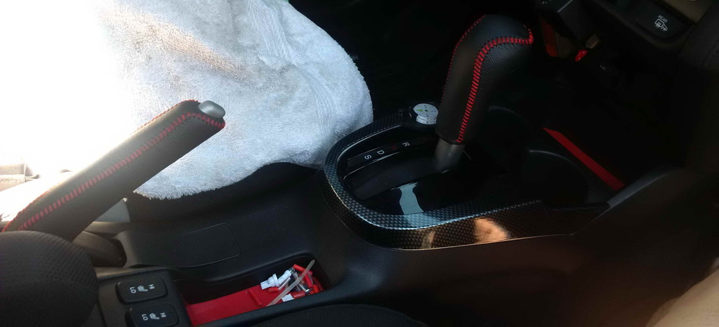

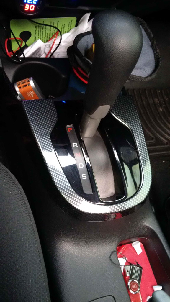

Fake CF shift plate surround.

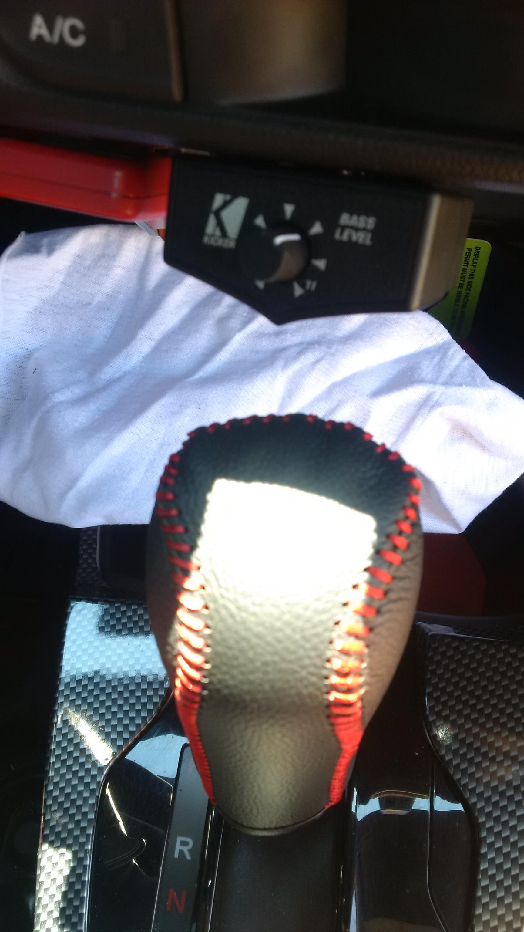

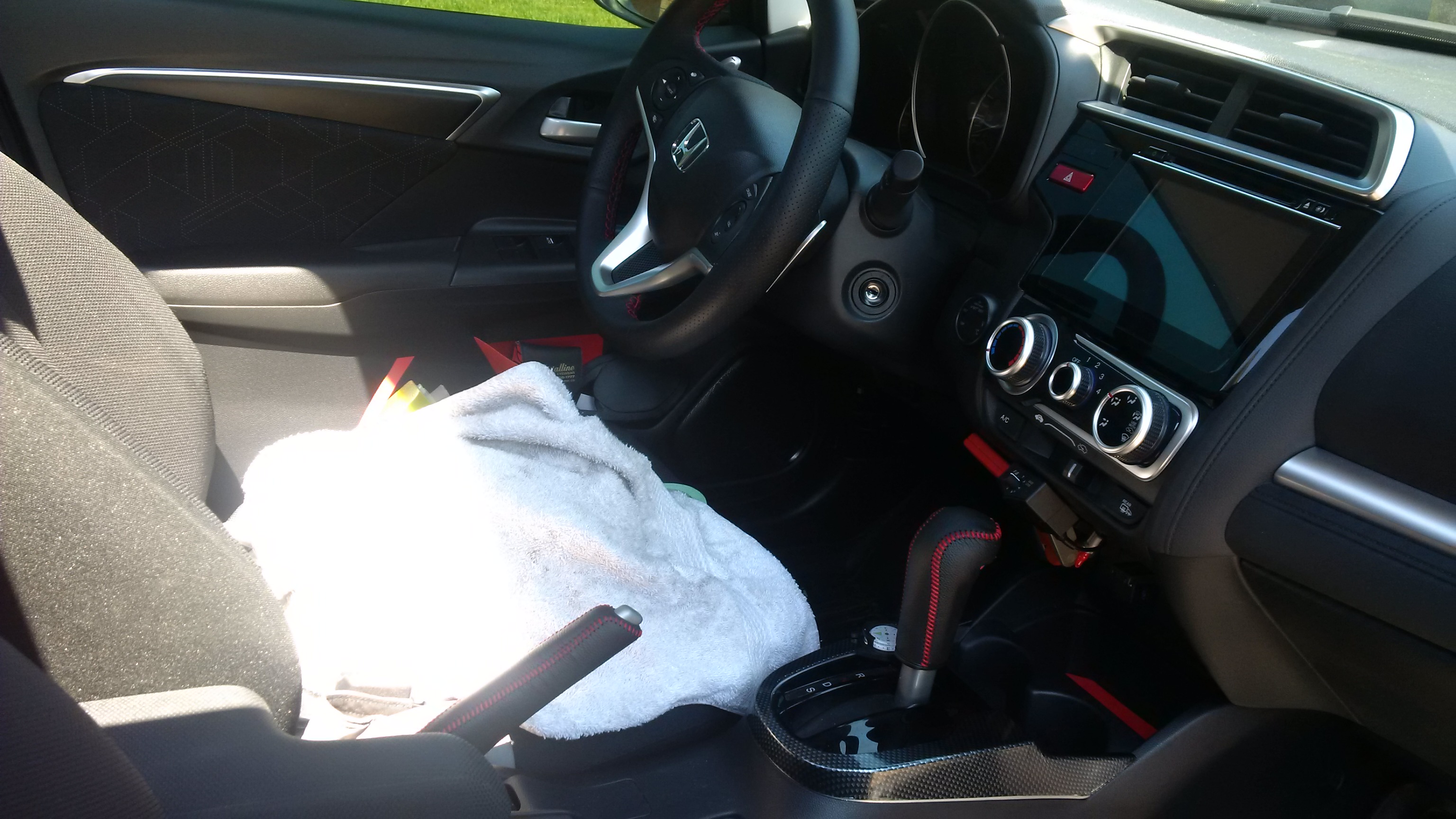

Installed a leather brake handle cover, and CVT shift knob leather cover. Both with red stitching.
