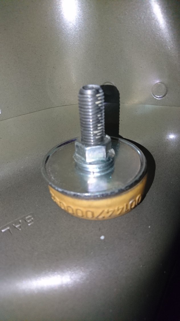

Have you had any issues with installing the Feal 441 rear shocks on the GK5? There doesn't seem to be enough thread at the top of the rod for the nut to fully engage.
Feal said to compress the yellow bushing and impact the nut down. I tried something similar to that and the nut pops right off and the rod somehow forces its way back down below the body of the car.
What does the rear shock look like under the car? I didn't have any issues.

Originally Posted by Mang0
Is that the bump stop? I don't think it's assembled correctly.

Here's the OEM shock versus the Feal shock. The paper on the right is how it should be set up. It's very straightforward but I'm not able fully thread the nut.
And here's a picture of the top of the OEM shock with plenty of thread.
Am I missing something? I recall the GE shocks have shorter rods. I'm thinking this is the same case.

I think mango is doing it right, minus 1 thing .... prob just needs to put a jack under the shock and push it UP. this is how my oem's came off:
https://www.fitfreak.net/forums/3rd-...ml#post1401168
I used a jack below the shock to compress it and even placed in the bolt at the bottom. The threads at the top were still the same so I even placed the tires back on and dropped the car. It still didn't expose more thread... That's when I tried to force it and the nut popped off and the rod came loose while I was tightening. Do you think it has anything to do with the spring height? Or possibly the part I marked in blue that's limiting the thread exposure at the top?

for the part circled in blue, I see 2. if I am seeing this correctly, is the one on the right longer than the oem one? if so .... try re using the oem one and see if that helps you gain a few extra threads
with the car on ground.... that should push UP as far as possible
Feal didn't include those with my coilovers. I either reused, or didn't use at all, the OEM "black blob".
Thanks everyone for trying to help. I greatly appreciate it
Both parts I've circled in blue are the same OEM piece. Feal did not supply that piece but the instructions show to reuse it. It sits above the rod spacer and below the body of the car.
I'm going to try the install again but adjust the spring height so they're not forcing the shocks to extend, but instead compress. I think that's my issue.
