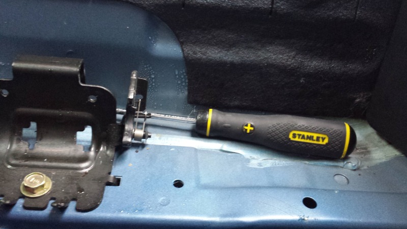

This is an image of the rear boot/trunk - the part that meets the tailgate. I've removed the plastic trim. Hopefully you can see the area under the black box that is wet - that is the relay/module for the parking sensors. I've put silicone in the hole now.Name:  20140302_150426_WeaverAve.jpg

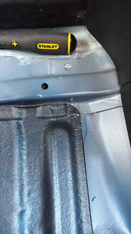

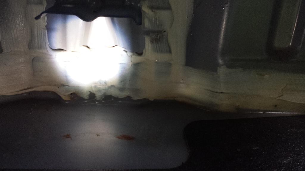

These images are of the passenger side foot well (right hand drive) where I've pulled the carpet up and placed the seats upright. There are holes obvious, where I believe water comes from the boot/trunk and saturates the carpet.Name:  20140302_150509_WeaverAve.jpg
Size:  138.6 KBName:  20140302_150529_WeaverAve.jpg
