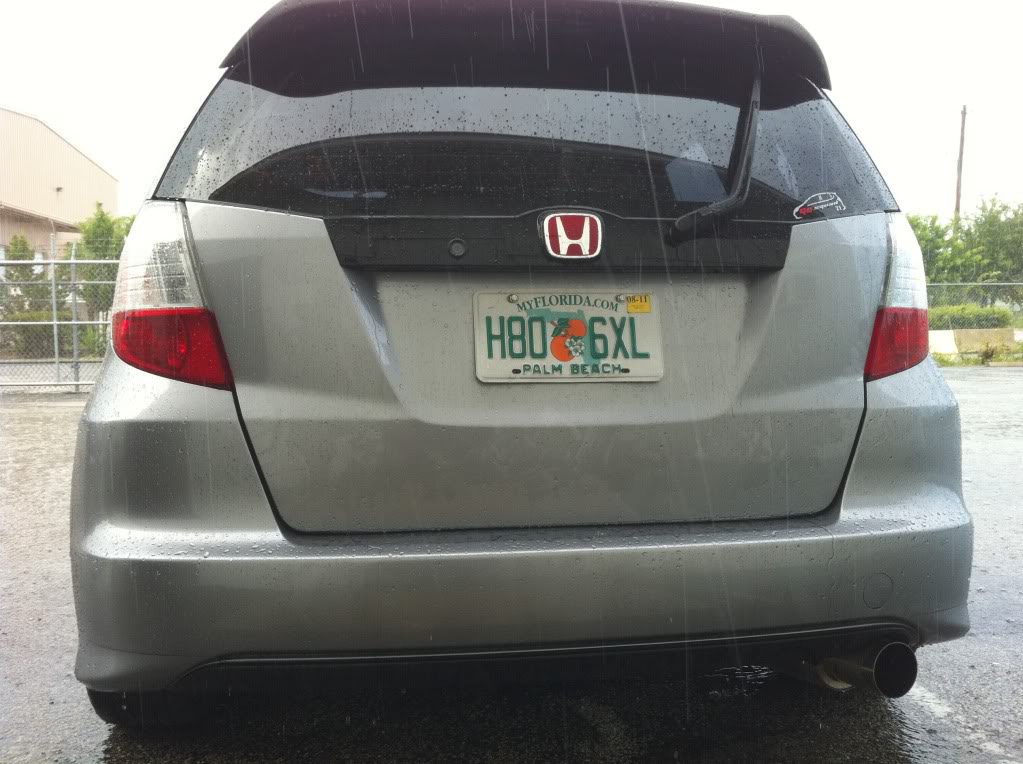

jdmjunkie561's Avatar
Posts: 1,585
From: palm beach,FL

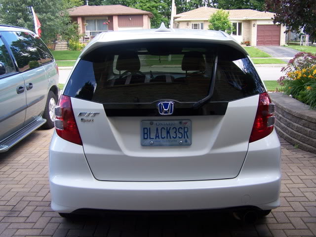

I got a Stiffy!!!!
The second time it worked. KC my 09 has got too many holes to chose from as well . I positioned mine the second time in what appeared to be the same hole as the first attempt. The arm at the top is moved down to the bottom like in the OP. Maybe I moved it over one hole to the right?
I have it all closed up so cannot take a pic. A lot of fiddling too to keep it off the garnish.
I had one clip pull off the panel as well. I had to use both a flat scraper to pry as I used pliers to pull the clip off the body. Had enough left it held when I put the piece back on.
I must show the wife now
