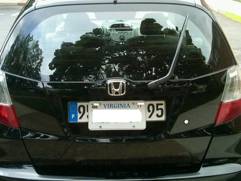

On the 2010 that I have, it seems that Honda got the idea that people had to break off something to do this. Now...it comes with 6 different holes. Mine was already set on a "blue grease" position......just changed it to the opposing hole. Worked great!
While at it, I went ahead and debadged it:

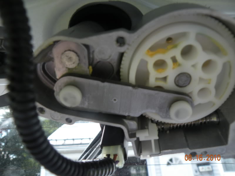

Ok, so I did this today, but my wiper seems to be stuck. After I switched the hole on the wheel to the opposite one, I can't remove the metal piece that attaches to the wheel and my wiper motor seems very hot.

Got it out, rechecked everything and gave it another go.
I only get a 1/2 wipe then my wiper stops and my wheel looks like this.
The left bar was pushed all the way to the right and it stops in the middle instead of giving me a full wipe.

Nevermind, problem was when I first took it apart the wheel flew off so I didnt know which way was the right way for stock, now I have it all set up right and have my stiffy.
