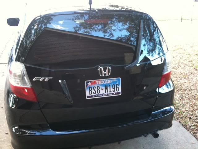

good write up. very easy mod, just did it to my girls 2010 base model. took me about 45 minutes because i dropped the big white gear, didn't notice the bit of dirt that jammed the gears..... (almost burnt out the motor while i wondered why it wouldn't turn) had to take it back apart and clean it.
i also washed and waxed it.
