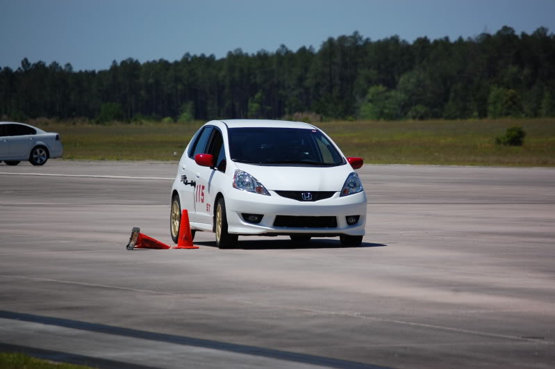

That's overly exaggerated. I took the rear seats out of my GE8 for an autox and weighed the pair in at a total of around 70lbs. I actually ended up putting the rear seats BACK in because it ruined the balance of the car and i ended up spinning on cold tires through a "lane-change" set of gates at around 40mph. Car behaved less predictable with MORE weight gone over the back axle. Put the seats BACK IN for the next event and problems solved... i was back to rotating the car as i wanted and beating up on WRX's and Miatas haha
If i were to remove weight from my Fit it's gonna be anywhere on the front end...
here, haz a pic
