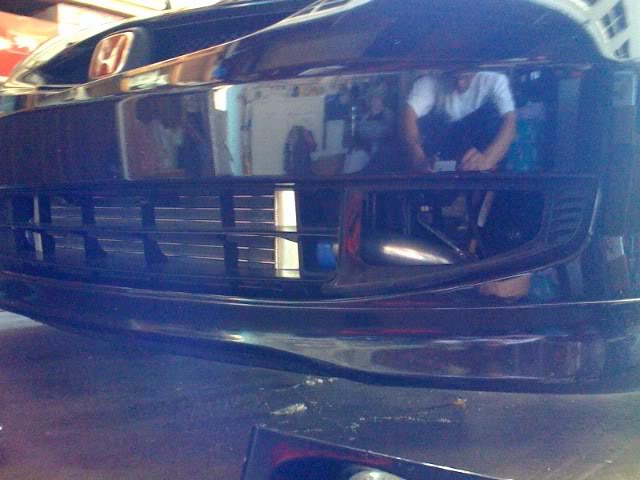

Spoke to GReddy today and they confirmed that the fogs can be retained with their kit. They also told me that the size of the piping 50mm; not sure if this is just where the fogs sit or the the size piping for the whole IC kit... That said, I also spoke to Ben (AJ-R) and he said that 60mm and 70mm piping is used in the T1R kit.
I'll try and see what the size piping the HKS kit is using...

ok, just got word from the guy running the HKS kit and he said the kit came with 2 inch IC piping which is approxx 50 mm... I honestly dont know what GReddy is doing differently... I'll try to get some pics....

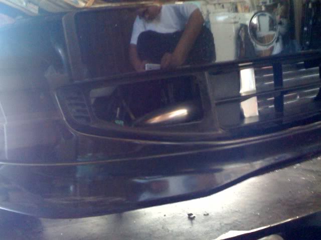

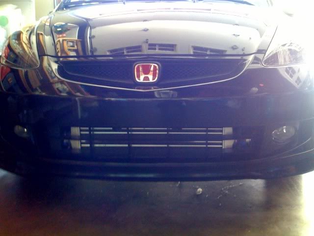

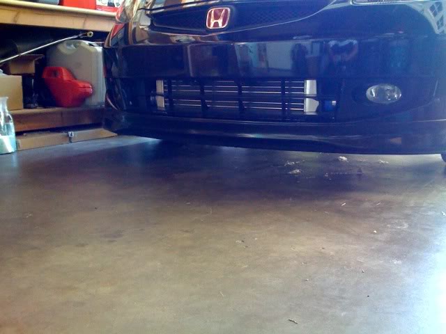

BUMP with pics
sorry for the crappy cell pics...
Fogs can be retained:

Posts: 2,982
From: Cerritos, Ca
Originally Posted by 1WayFit
Specs and price of the GReddy kit?
- Cast mainfold and e-manage Ultimate tuned for stock exhaust.
- 122whp @ 4.5psi.
- will be submitted for Carb exemption.
Originally Posted by PwRmAd
so whens the ETA on this? summer?
- I'll let find out and post it up when I get the info.
Originally Posted by dickiez
wait so you have the kit???
hahaha
- it is definitely a possibility...
