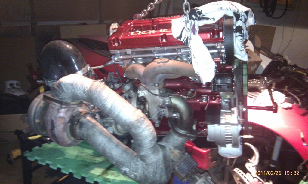

Some updates to share:
Gapped down to 0.030" in anticipation of some boost here soon!
This is about where things begin to get exciting:
The turbo I will be using while I modify the 14B for more flow
Nice big T3 tubular manifold!
The downpipe that will let me get up and running while I save up for a real one with a wastegate dump for the 14B:

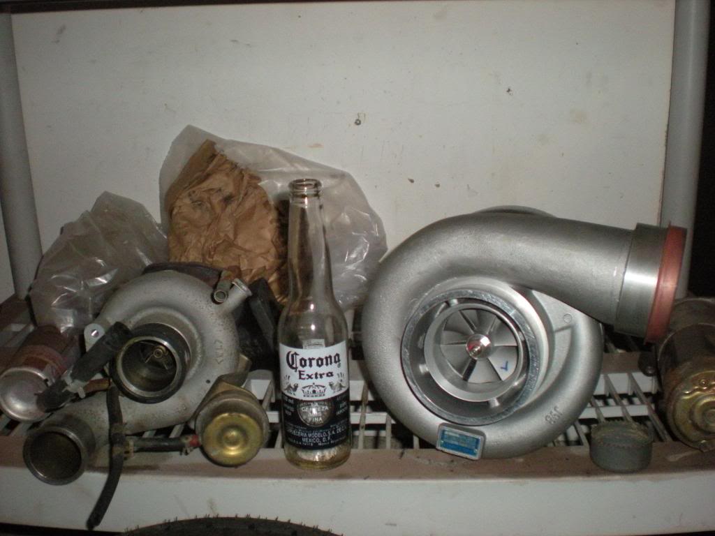

In less depressing news another compound turbo gas 4 cylinder was born! Leclerc's 2G DSM... Check out the downpipe:
Using the bigger of the two turbos pictured below as well as an Evo 3 TD05H 16G:
