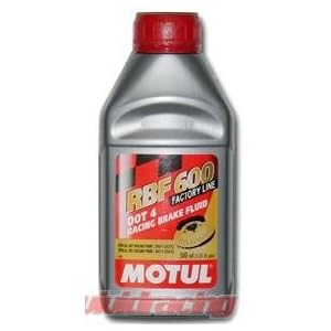

Performance street pads, anything OEM is a waste of time and money when it comes to the brakes IMO.
Was actually looking at Motul RBF600 brake fluid, I think stainless braided brake lines might be overkill though?
What supporting mods are you looking at doing btw? and by that I mean excluding drivetrain mods.

Those slotted discs should really help resist fade, which is handy when you have extra power to reel in after a good pull.
Have you considered a nicer brake fluid to go with? Like DOT 4 or equivalent? This will help with consistency if you forsee having to make more than a couple hard stops in a row. The company Motul provides a few options!
I used Motul DOT4 for the brakes on a Harley 20 years ago.. I tend to be easy on brakes and clutches so for me it was like any other fluid but it is said to be good in high heat situations... I remember reading that it isn't allowed for use in certain SCCA competition cars due to its ability to absorb water that turns to steam during hard braking... In those cars they use DOT 3 and it must be changed between one event and the next to insure the quality of the fluid and to prevent water accumulation...I know that motorcycle racers used Motul brake fluid but I don't know if they were required to change fluid as often as SCCA requires.
You will like SS brake lines to replace your OE softlines. More solid brake pedal feel and linear break input. Just like replacing clutch softlines in other cars. And they are much tougher and less likely to wear out. They will also sustain more heat for longer.
I am looking at trying to do it is cost effective as possible...
External fuel pump with SS lines for feed/return, Aeromotive Fuel Pressure Regulator like I use on other boosted cars, at least 450cc/min injectors, an AEM FIC, AEM UEGO, MAP, IAT and EGT, big FMIC and a Meth kit.
As far as brakes, this is what I have in mind:
For those who serious brakes without going broke:
Yes I know the picture shows 5-lug, but this was under the results for a brakes query under 2008 Honda Fit Sport. Brembo Cross-drilled front discs, $145/pair @ TireRack.com.
Hawk HPS Street front pads, $80/pair @ TireRack.com
Motul DOT4, $12-16/bottle where ever you find it, doesn't even have to be Motul specifically
Combine the above with some decent rubber like a V-rated all season and you will see a huge change in braking feel and consistency. Fuzion VRi's are like ~$70/each, so for like ~$500 you have a great DD set up and a competent track setup.
Now to go one step further I am planning on replacing all brake lines with braided SS lines, like the Goodrich kits. While that's in progress I intend to install a brake proportioning valve.
I run this setup on all my cars, the Fit has been left alone this long only for warranty purposes.
This is true, but I have never run into this issue running DOT4 in street cars that were properly flushed and bled. I have it in my Laser currently.
There are DOT3 options from Motul that are also very good.
SCCA will demand alot more from our cars than most people will be able to put them through on the street without seriously endangering others unless they live out in the country somewhere and drive like complete lunatics.
