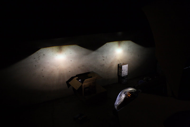

I finished my retrofit
Just wanted to let you guys know that I finally found time to put do my retrofit. It took me 1 afternoon and 2 nights...longer than I expected. So what I used wast he D2S projector kit. I'm pretty pleased with how it turned out - I ended up putting the LED strips (that theretrofit source supplies for free if u buy 300 bucks of stuff) around the shrouds to make them be something like angel eyes... they actually look better than I thought they would look. I haven't gotten around to connecting them though...
I also might need to fix some alignment issues...
here are some pictures... enjoy!

F*%$! Awesome. I just have to find time to do mine on my GD3. How did you wire up the hi beam? Because I know that if you hi beam on our cars it would turn off the lo beam.

so the d2s morimoto mini projector kit i got from theretrofitsource comes with the wiring harness that will do that for you. you can also buy it separately from them... all you need to do is connect the original bulb output to the harness, provide power and ground for the harnes, and then connect the harness to the bulb/projectors.

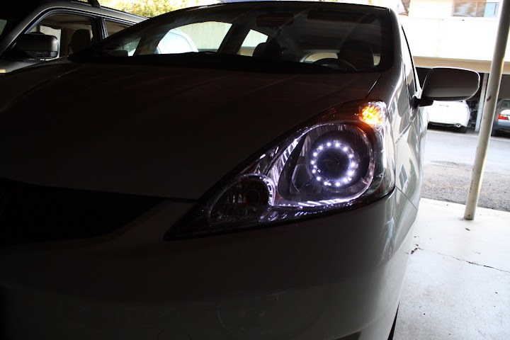

so I hooked up the LED strips around the shrouds ... but I found out the hard way that they're directional... so the one I put in the left is facing the wrong direction!! so when I have time I'll have to fix that.
here's a picture in case if anyone is interested.

having a bit of difficulty understanding without the comparison shot about the "directional" LEDs.
Is the pic you show, of the correct or incorrect LED?

these are the correct side. the other sides have the light mostly going into the projector instead of out at you.

From: Wandering around.
I see.
I was confused because you said the "left" side... I was assuming left as if you were sitting in the car, not looking at it.
I personally think its easier to refer to driver vs passenger sides (of course, that assumes LHD, not RHD cars).
