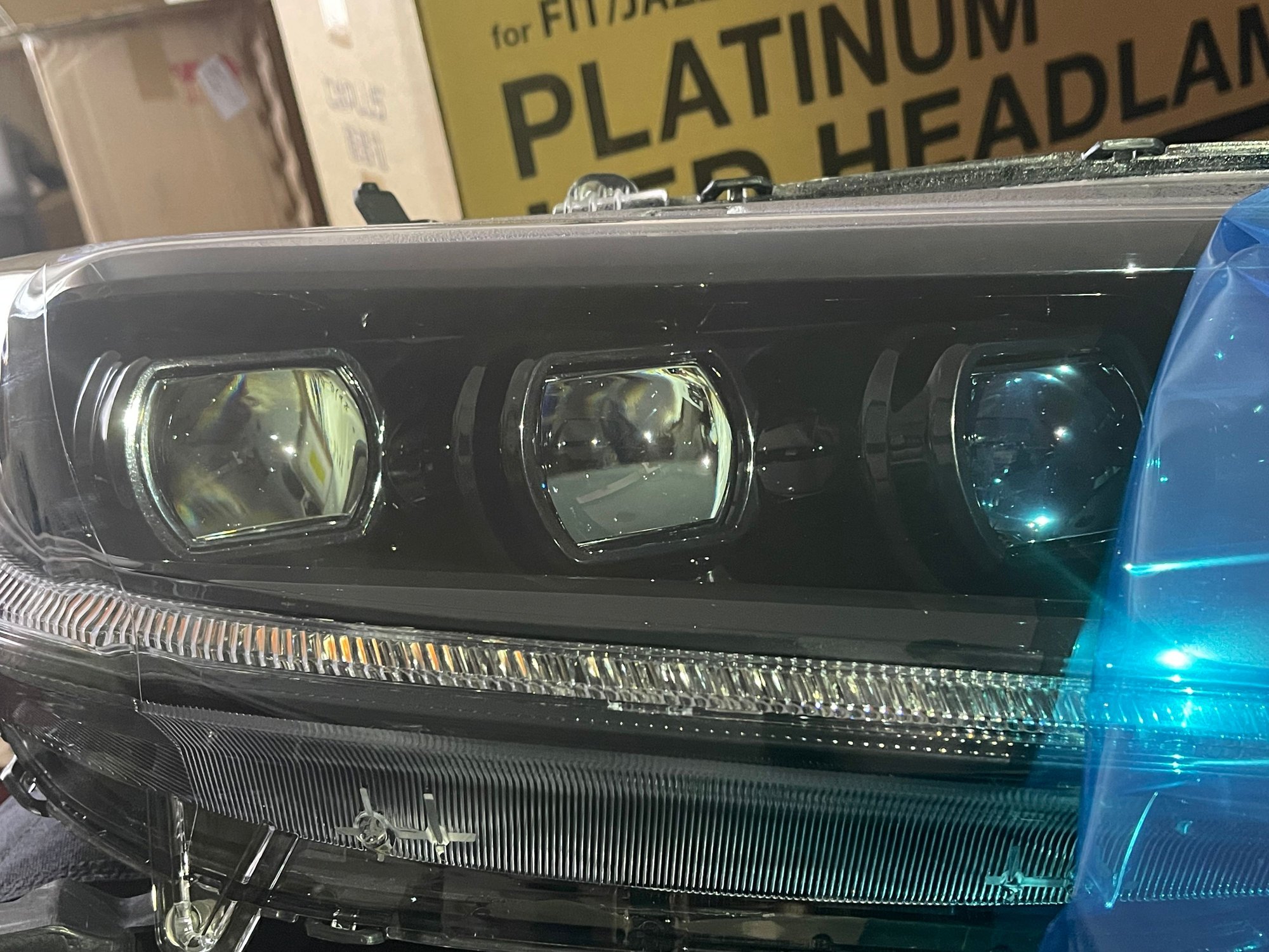

So I just got off with retrofitsource as morimoto replied to me stating that these headlights aren’t serviceable so we can’t replace the bulbs, are these still worth it considering that factor?

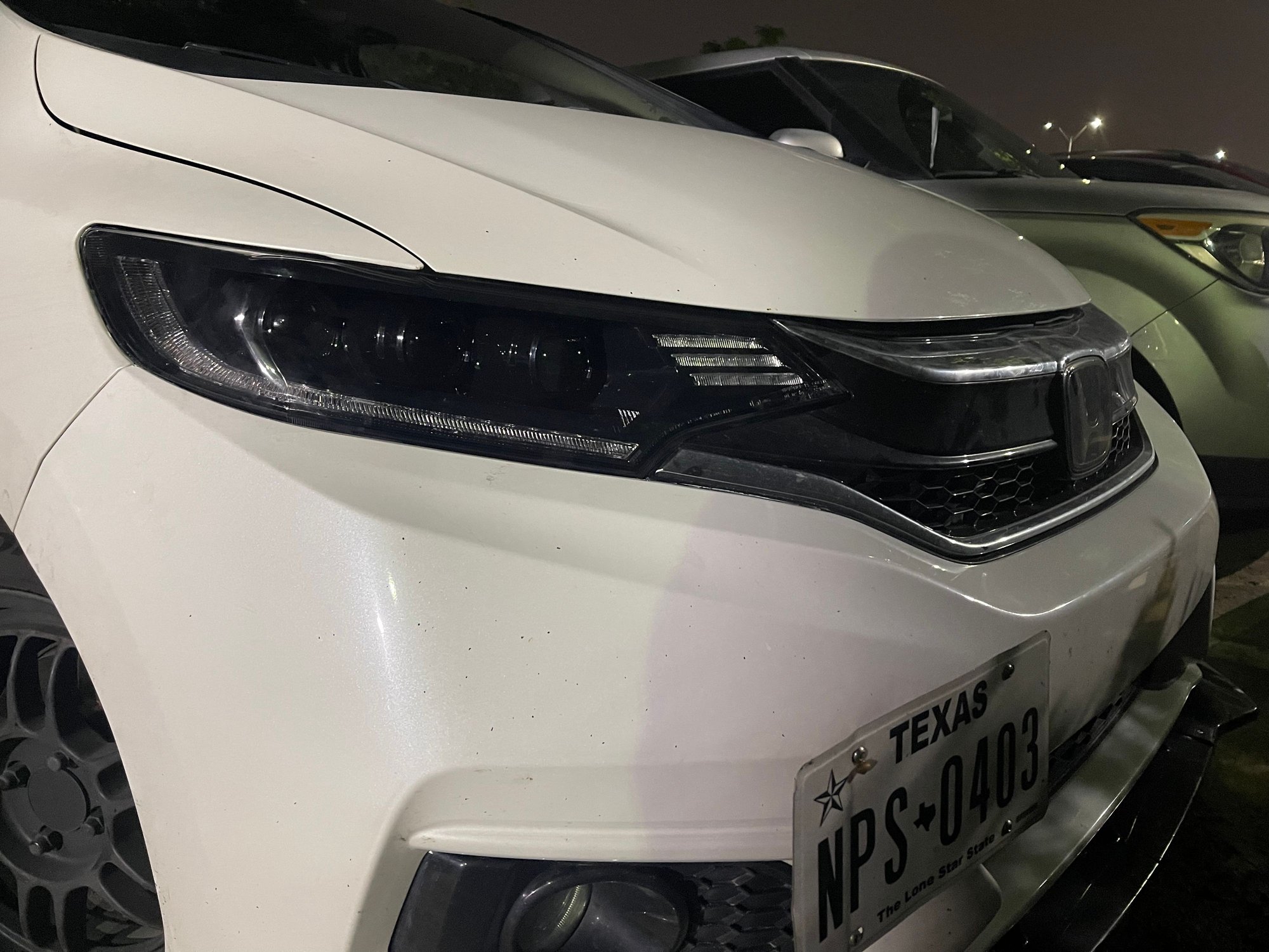

I had the same thought when i bought mine but, got them anyway. its been 4 months now and no issues so far. they do have warranty and from what ive heard these bulbs are long lasting. If they go bad in 2 -3 years just chalk it up to the price u pay for being cool.

I’ll email them back and see if they can just swap them for a projector kit as I didn’t really want to do that since these were plug and play. I also went back to the listing and they compared them to their fog lights as they are also built in the same and seem to hold up after 5+ years but I wished they had actually be more specific about it. The warranty it’s at 5 years but does it cover the LEDs as they are wear and tear if we can say regardless of it they are pretty good compare to those $300 cheap projector headlights.

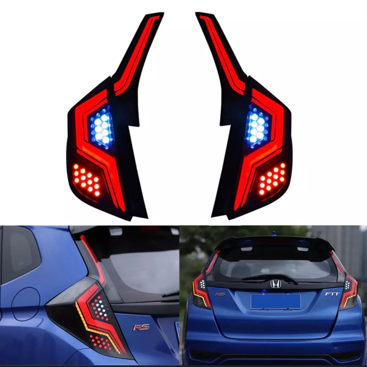

Sorry to hear that man.
Well, now you can look at those taillights with the waterfall effect.
Another fun project that will bring frustration, maybe a cut on the finger and then pride. . . Lots of pride.

actually I didn’t like the reflector taillights on the hatch, I ended up wrapping them in black vinyl.
But wil definitely be doing a retrofit next year.
