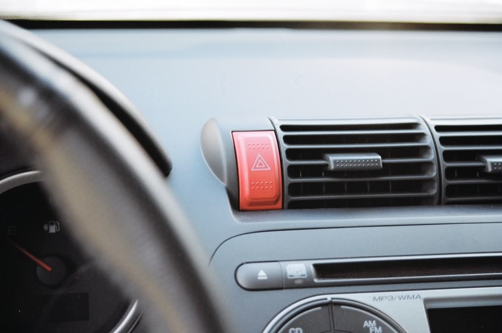

Thanks to this thread, I was able to install my JDM hazard switch in about 10 minutes. The A/C vent removal is definitely the quickest method, and I didn't break anything except for my old hazard switch.
I'm so excited! I can't wait to run out of gas or have a flat tire just so I can use my JDM-tYt3 hazard switch!
