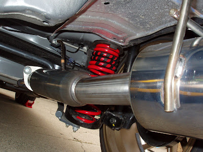

Old Oct 16, 2008 | 10:55 AM
  #665
IIEZ's Avatar
Posts: 102
From: Glenview, IL
noise
I never had noise on my sway bar. From the pics below you see where the bolts go and there is a little obstruction there. Just move that rubber piece.
This next pic is kinda far but you can see where the spring sits and the spring should not rest on the bolts. Some might argue that the springs are upside down, but they were installed by a professional mechanic.
Hope this helps.

^thank you for the pics.
in this pic i can clearly see how the rubber is slightly covering part of the holes that the sway bar bolts through....not much, but still "cutting off" the hole. now, the problem is that the bolt head is a few MM larger diameter than the hole...meaning that the hardware will be that much more intrusive of the spring sitting correctly.
as far as moving the rubber piece..it doesnt seem very movable since its locked in position by the center of the perch that protrudes through the center of the rubber.
as happy as i am with the function of the sway bar, i am displeased with progress for attaching it in such a way. i assume im not the only person with this problem since there is this product available:
