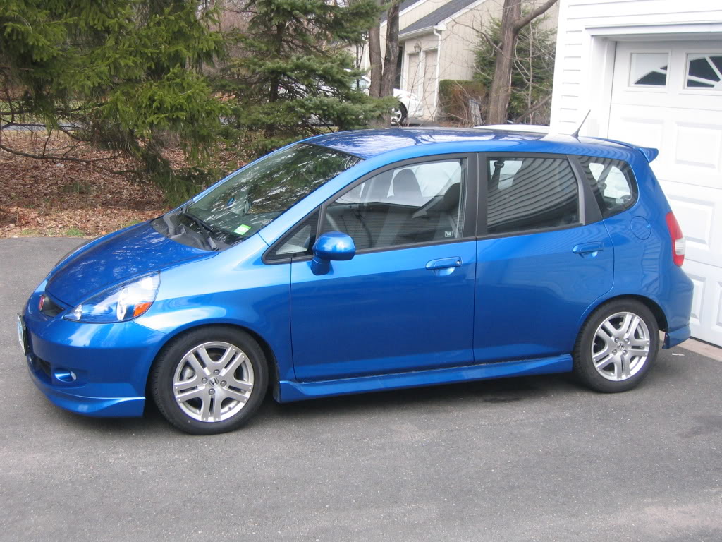

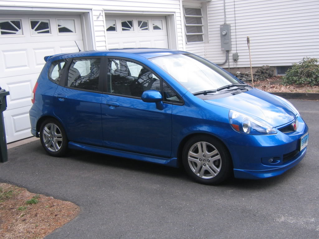

Got it done in about an hour today, borrowed an impact from a friend and that bolt came right off. I miss having air tools at my disposal...
Shitty quick pics, I just grabbed the point and shoot my fiance left out.

Air tools FTW. Drop looks good, nice and even. Which springs are they?

definitely a nice install. what kind of springs???

looks good man. i had mean problems with axle popping out.

Thanks, they're Skunk2's. I was skeptical at first, I really wanted Teins, but I'm happy with the choice.

yes, most definitely looks good.

Thanks man, its odd getting used to dailying a lowered car again. It feels almost as stiff as my old accord.
