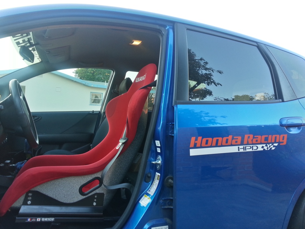

After market seat experience? For big men
Bracket configuration? Air bag will be disabled?
Old Jun 19, 2013 | 07:49 PM
  #185
TPColgett's Avatar
Posts: 1,952
From: Hayward CA
JUST did this in mine...
MAKE SURE, you have brackets designed for your specific Fit!!! Wedge engineering is back up and operational I have heard and makes a quality product.
I prefer side mount seats, but I prefer the lower sitting position. A slider really is a MUST especially if you want to continue to use all the rear folding seat features.
Lighter is better in many regards. Fixed back seats are lighter than reclining. The ONLY way I recommend you pick out an actual seat, is to find some where near you with a "show room" and literally test fit yourself in them!!! My seat pictured above is a Bride Zeta III... and it is NARROW. I am the only one of all my friends who comfortably fits in it at 5'6" with a 29" waist I have a Buddy Club seat from a friend which is even lighter and a LOT more comfy for bigger folks.
Corbeau makes GREAT seats for every day comfort and use and most of my AutoX friends who also daily there race ride (or drive long trips instead of trailer) seem to have those or Sparco's.
Hope that helps! And let's see some pics

Posts: 126
From: Detroit Metro Area, Michigan
Bride doesn't make USDM sized seats?
Good to know I could fit in that but i'm built like Slender Man.

LOL Wanderer... They make an "XL" version for us fatty fat fat 'Merican's
With your set up, air bag are disabled?
Yes. The air bag is physically a part of the OEM seat... So once it is removed there is no air bag any more. The car will notice and turn on a light on the dash. There are "resistor tricks" but I am not a huge fan of mucking with live air bags or electricals in general...

Originally Posted by mike410b
Even the XL version isn't rated for over 175 lbs.
Brides are for properly sized humans.
I had to borrow a Buddy Club for my two prospective co drivers to "Fit" into the car
