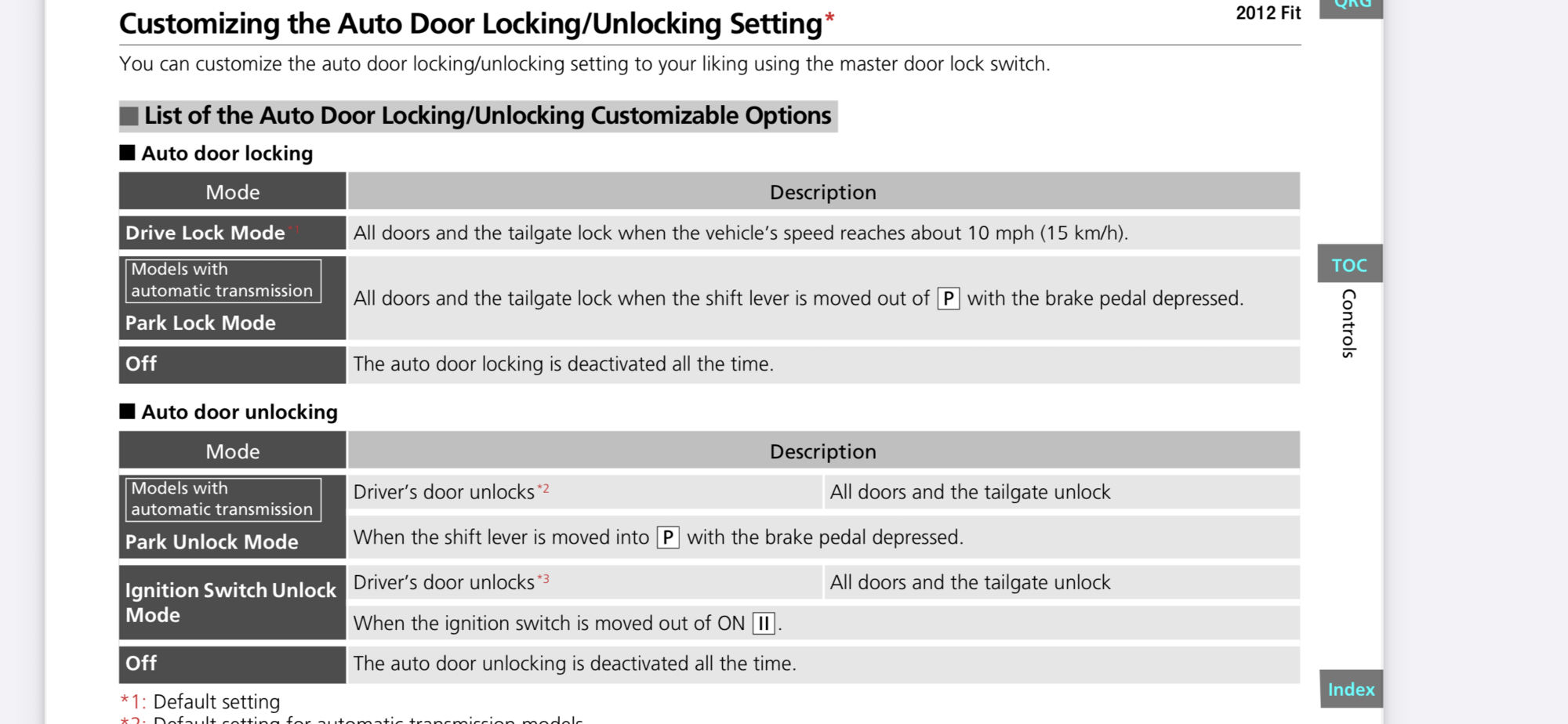

Soooo... Is it posible to permanently disable the auto door locking/unlocking feature in my '12 Fit 5MT?
I understand the rationale some maintain that that is not a god idea - point taken.
Again, is there a way to stop the automatic door locking/unlocking feature?
I don't mind cutting wires ,either.
Thanks,
NIK

This is what I did.
https://www.fitfreak.net/forums/2nd-...tml#post423933
Originally Posted by CrystalFiveMT
This is from memory, so forgive me if this doesn't work:
- Insert key and turn forward 2 clicks (don't turn engine on).
- Press and hold the door lock button to its "unlock" position.
- After 5 seconds you'll hear a click. DON'T LET GO YET! Wait another 5 seconds until you hear another click.
You're done.
Hope that works.

Originally Posted by GrE8_Fit
isnt this what’s in the owners manual?
