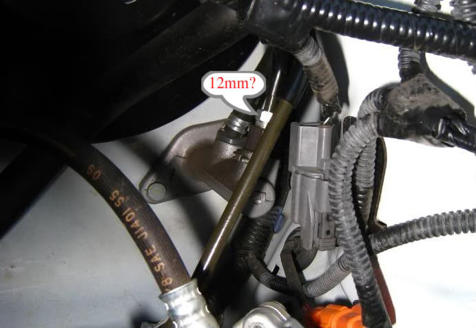

So is your car down then? are you able to remove the master cylinder? If you've got it out of the car take it to transmission shop. The adapter is going to be metric for sure. Can you take a picture of the original brass piece that the factory line connected to? I'm going to be working these next couple of days or I would head to some shops myself. Do you think you will at least be able to return those other adapters? I think if you go to a shop that does trans work this won't be an issue as they have seen everything.

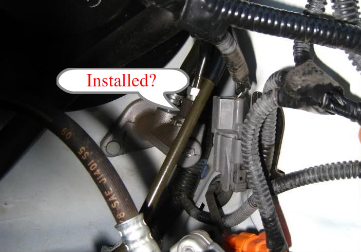

Post up if you've removed the piece in the second pic and post up a pic of what the end looks like so I can find out what the end is called, thanks.

Very curious if you had that brass piece in the second picture installed or not when fitting the new line. We could very well need 12mm as you've said but just find a 12mm version of those Russell adapters I had listed. As far as the 12X1mm side, I don't think there is anything special about that side of the adapter, you would know better as you've had it apart.
If you took some pictures when you had it apart it would be a huge help on this! Thanks!
