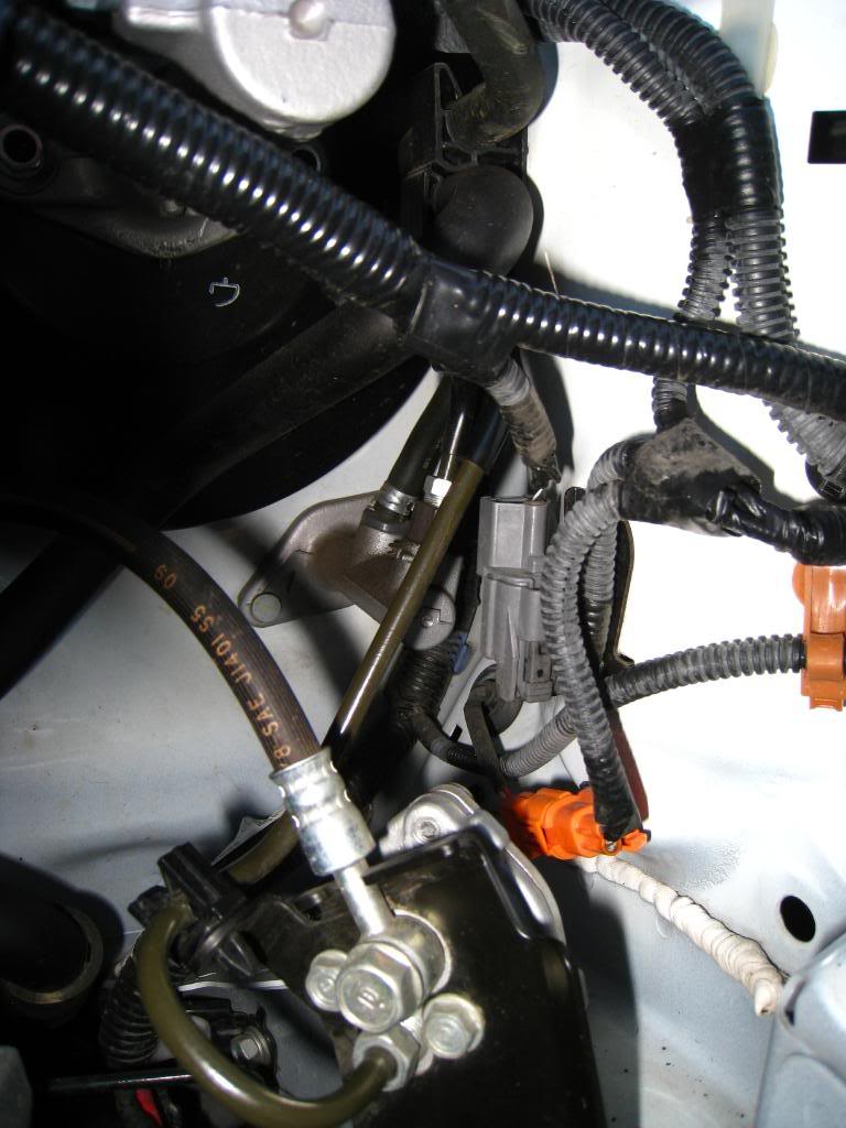

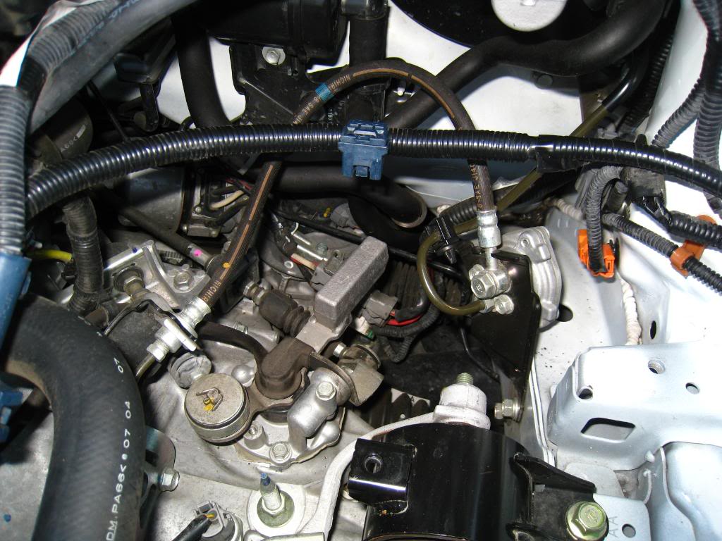

Ok, so I did some poking around under the hood and it looks like we can eliminate the clutch delay valve on the GD3!
Here is what I found, we can remove the hard line from the clutch master cylinder, clutch delay valve assembly, and soft line from assembly to the last hard line connected to the slave cylinder. We can then connect the master cylinder straight to the hard line that is connected to the salve cylinder with a 24" male/female soft line.
Here you can see on the left, under the coolant line, the hard line that is connected to the slave cylinder.
Here's an uncluttered view if it will help anyone.

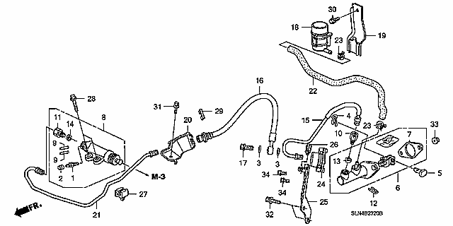

#24 DAMPER, CLUTCH
I'll post when I find the line that we will be able to use.

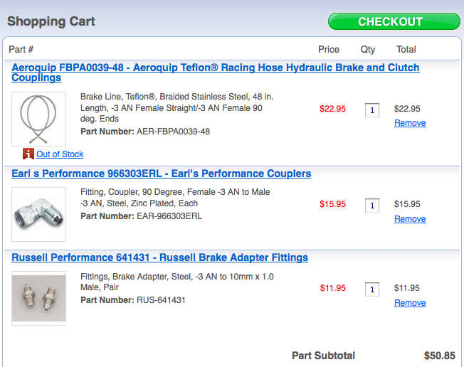

Cool
Here is what I came up with on summit Racing:
I'm going to order the listed parts and try it out in the next week or so. With this setup we should be able to route SS line from the master cylinder to the slave cylinder no problem.

Yes this is for the GD3 fit, I have had people say the same thing about the delay valve being located in the master. I looked up the clutch line diagram for the S2000 and RSX which are known to have the delay valve located in the master. Their diagrams do not show a delay valve in their line like the GD does. I'm not sure on the GE8, as I haven't seen a diagram for it. I have read the thread you are talking about and I would think a master cylinder would not need to be swapped. You should be able to remove the delay valve from the stock MC. Just google CDV removal for the S2000 and it will give you an idea on removing it yourself. Best part is it free for you!

On the GD3, the "delay valve" is called the "damper" and it's that triangle shaped mess between the hardline and soft line. Remove that, and you'll have no more problems.
IIRC, the RSX's clutch soft line hose will fit right up to the existing hardline with minimal bending.

yeah I decided to install my supercharger last weekend instead. Long story short the car is dead in the water until I get the replacement, so might be a week or two before the car is running again. I found on king motorsports site that they offer the exact same thing as I put together from summit. They list it for our car and to do what we want it to do, $90 bux tho...

Its the exact same stuff I posted, they just sell it as a kit for an extra $40 more than summit does. So yeah master to slave braided line kit.

Car looks good! My buddy was stage 2 with that E1 turbo but I never really liked they way his car put down the power with it. IDK what cams your car runs. Is it the same as stock srt-4? I swapped in 2.0 cams and that made a huge difference with drive-ability and the powerband! The car pulled MUCH smoother to redline! Also try the DCR top end modifier if it works with your motor, best $50 I spent on that car! The kit I ran was the Hahn Racecraft 20G kit Hahn Racecraft - Automotive Turbosystems. I got out of that car, as that was way to much power for FWD.
As for that clutch line kit, yes order everything exactly as I posted. I pulled everything out of the car and measured with some electrical wire from the MC to SC and got 48". It should look factory if you get the line with the 90 in it and the extra 90 for the other side. I would follow along the fire wall and into the same location the the factory hard line was routed to the SC.
