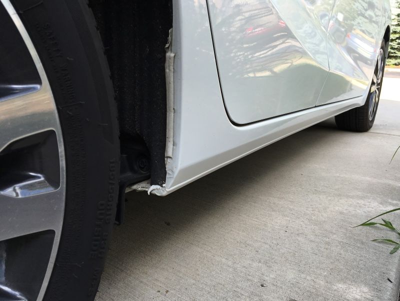

great, my wife drove the GK into those concrete divider things at the bank's atm drive-thru resulting in some major scuffage and minor dent at the bottom of the passenger side rocker.
paint missing from the rocker with 5-6 long gashes maybe 1.5ft long..
i had some old honda touch up bottle of taffeta white from the GE so dabbed dat on there for now to prevent any rust before i get mixed cans in the coming weeks.. will sand block the taffeta white off to a smooth finish, and spray over it with fresh orchard white pearl.

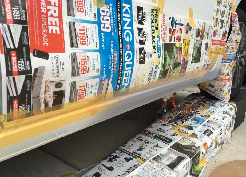

worked on the GK's damage today. turned out alright.. wheew. now letting it dry for a week before i polish it to a nice shine.

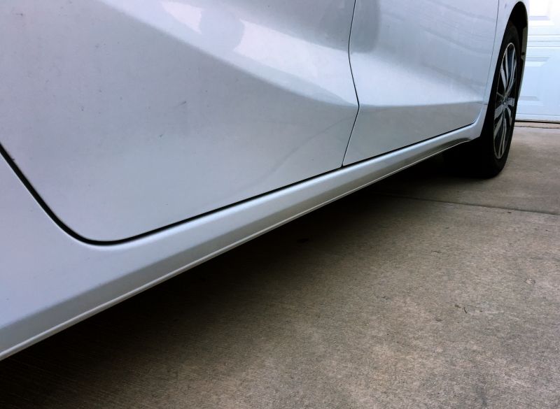

Attached Thumbnails The Official Blog from GD to GE to GK to GTI to R?-80-before_81ff20168b38d9349713b41945165bb0486d1eee.jpg   The Official Blog from GD to GE to GK to GTI to R?-80-while_d9beb6fd12573fe076415e520104854afea37f8e.jpg   The Official Blog from GD to GE to GK to GTI to R?-80-after_d59e493968976b9e3b82daec2b0a39b27032ed2f.jpg

the picture above is still not the finished product. i need to polish it with compound to get the shine, but you can kind of tell how it will turn out.
my wife was excited to get her car back. total cost $65? can't remember how much the mixed paint was.

Dang kenchan, are you a autobody worker? Thats some good work!
Old Sep 6, 2016 | 08:17 PM
  #4674
kenchan's Avatar
Posts: 20,288
From: OG Club
thanks! but no, im not that good at all. i can only paint small pieces.

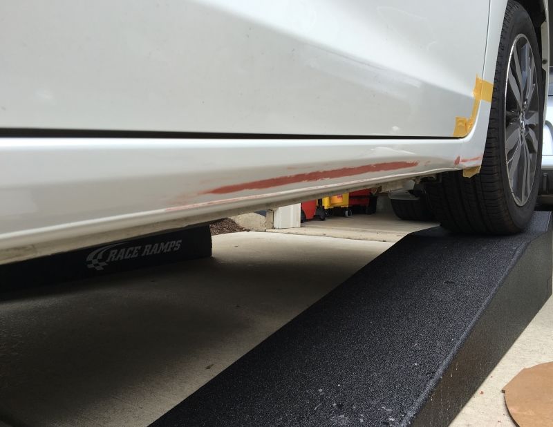

here is the finish.. turned out real nice. wet sanded the seam to make it a smooth transition before polishing.
will polymer seal the entire car before it gets too cold using prima hydro max.

huh... link broken. try this again.. i hate this new configuration they setup for the album pages on this site..
Attached Thumbnails The Official Blog from GD to GE to GK to GTI to R?-80-finished_gk_cbba29ab272d403afa70ac49c1a4441d30a5619f.jpg
