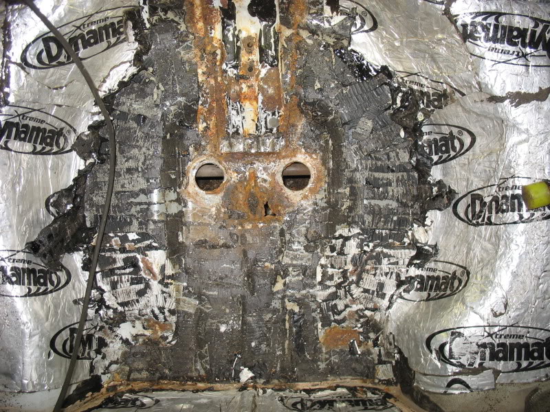

i have heard horror stories and seen what it does even if there is a slight wrinkle in it and the smallest bit of moisture gets in (with a hatch it's inevitable that some kind of water will get there). over time it turns into a complete mess:

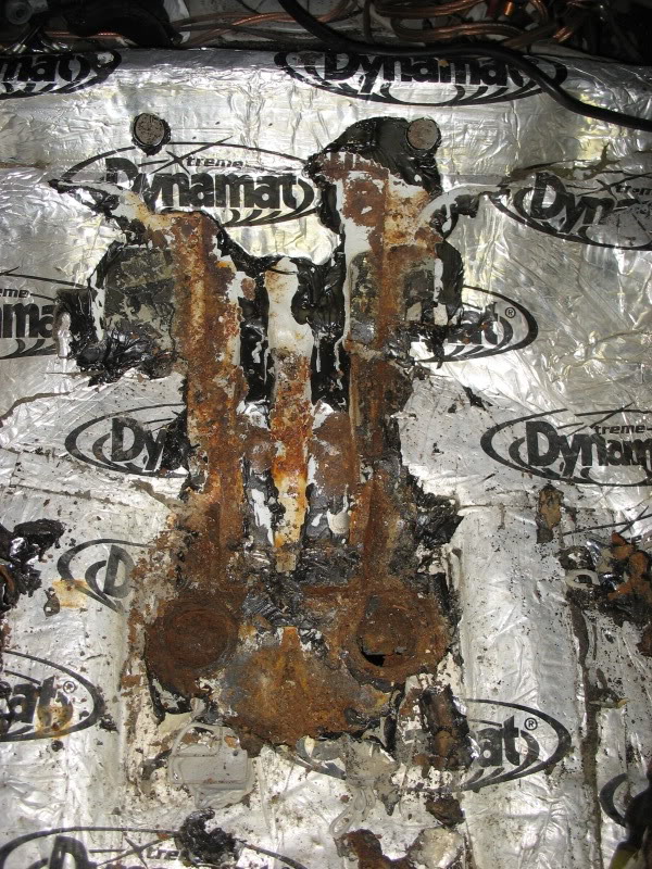

that's a picture of water that got in under the dynamat and corroded the shit out of the sheet metal underneath. here's another
pics taken from New Interior that has Snowballed out of control!!
plus, the weight the dynamat adds to the hatch will wear out the struts sooner. that stuff is HEAVY!

Ok, that's a legitimate reason to be wary of dynamat, especially in a state that sees alot of moisture or snow
