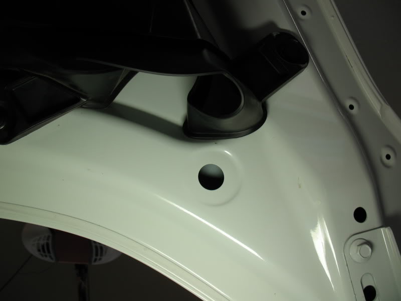

Originally Posted by Tauwolf
Pic request: the trimmed section of the plastic air cowling under the hood.
I was going to cut the air ram but what I did was just push up the end so it would clear the bar. It stayed in place and clered the bar just fine and yes it probably restricted a little air flow.
