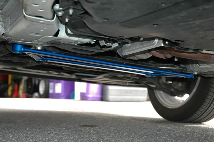

FITMugen's Avatar
Posts: 697
Originally Posted by Java^FiT
It looks like you can just remove that stock one. I think ours is supposed to act as a replacement anyhow, i suppose you can flip it around if possible and install it back reversed so it protrudes towards the cat. This is what the T1R 4pt looks like installed
I don't think you have to remove the stock one. Mine is from T1R and the 4-Point subframe is almost touch the stock brace.

Originally Posted by xcelir8fit
I took that off so that the subframe would fit (it interfered), then put the stock brace back on with metal spacers. It's in the following picture. Any idea if you think this is good or bad the way I have it?
Should not have had to remove the stock brace. The KMR brace should be installed in addition to the stock brace. The KMR brace does fit under the stock brace in my case. So what if they touch.
Strange. For the life of me, the KMR brace would not go on no matter what I tried with the stock brace on - hence why I was creative in putting in the KMR brace then the stock brace with spacers. I guess that whether it is over or under, it's on and provides support like you have it. Cool.
